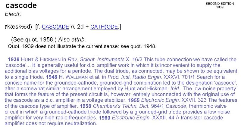

More on the term "cascode"
"First use by F.V. Hunt and R.W. Hickman in a 1939 article. They discuss circuits for application in what they call "low-voltage" (130V-600V) stabilizers. They describe two triodes in cascade, and think of it as a pentode replacement. Hence they thought of the name "cascode".
This name applies to a cascade of a common-cathode triode stage and a common-grid triode stage. This particular cascade configuration became very popular, and it still is. The term "cascode" also became very popular. Not only the circuit, but also its name evidently filled a need. Engineers liked the name, and still like it, because it distinguishes this popular stage from other cascade circuits. Later, in 1948, Wallman, MacNee, and Gadsen describe this as a stage which has the low noise factor of a triode and the gain of a pentode."
from: http://www.quadrivium.nl/language.html

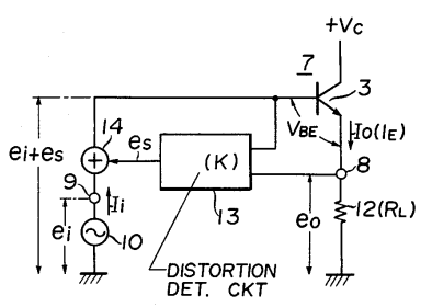

>I'm perfectly proud to have designed something before Hawksford, and less happy to have been anticipated by him on another.
Nelson, your circuit 3,995,228 and later variations from Pioneer 4,254,379, JVC 4,274,059 and Sansui 4,401,951 are different circuit realizations of Blomley idea (nonswitching), which was mentioned here several times. Hawksford idea (and at the same time Iwamatsu 4,476,442) is the error feedback with summing at the input of the output stage.
I look at the Hawksford, Cirdell, and Halcro circuits and see
virtually the same topology. Variations of drive to output node
are compensated out in all cases. I'm not familiar with Blomley -
do you have a schematic or other reference?
Ay-ay, sir! Full scans, schematics ...
Yes, you are right, Hawksford was the origin (JAES,1981,jan/feb), Cordell was the follower and cited Hawksford in his JAES paper, while Candy assumed the rights on the design in USpat 5,892,398 😀
I think that my patent # 3,995,228 precedes Hawksford, as it
also compensates variations of drive to output node, and if
you look at the schematic, it is very similar.
