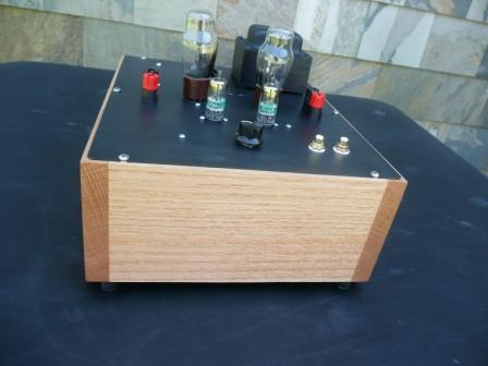

Here's a photo of a Direct-Coupled ("DC") Darling (with 1626s and 8352 drivers) built on a Hammond cover plate. The EDCOR 5K:8 ohm OPTs are underneath with the Allied filter choke (6H or 7H?).
The chassis base is some nice clear white oak that was left-over from furniture making. The grain is very nice. The joinery is ultra smple, just butted together and glued with Titebond II (stronger than the wood). Didn't even bother with dowels or biscuits, as any stress that would threaten the joints would certainly wreak havock with tubes, etc.
Let me know if you want to see the guts.

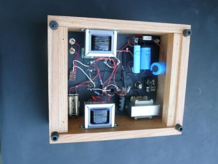

DC Darling Guts
I realized that nobody here doesn't want to see GUTS, so while I'm in the directory already, here they are.
Note the battery bias for the 8532 (single triode) driver tubes.
I didn't have an appropriate bypass cap in stock, but I had plenty of AA cells and holders, so I tried battery bias. It's at least as good as the by-passed biased resistor(s); one thing I am thinking of trying is a "replacement cell" so I can compare the bypassed resistor to batt bias.
Imagine a dowel with copper wire end terminals with resistor and cap between. Pop-out the battery and pop-in the dowel/resistor/bypasscap. Should be able to get a quick comparison without that pesky time lag.
Gotta noodle on that. Maybe brass round-head screws (or even upholstery tacks!) holding down ground tabs; solder between the tabs.

Alright I am making some headway on the chassis. I built the main structure out of wood and box jointed the corners. Turned out pretty good considering it was the first time I attempted a box joint with a homemade jig. For the top plate I sourced some anodized aluminum at a commercial window shop we do business with. I just need to stop in and tell them what size I am looking for. I am just gathering a couple more parts for the final build. I am thinking of using an inrush current limiter on the main power line and also was wondering if adding a bleeder resistor of around 2watt 220k ohm on the 80uf 370v motor run capacitor would be smart?
The newbie again
Let me know if I'm right.

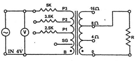

Here the connections that I made:
1) The negative (black) binding post and the 8 ohms (of the 6123HS OPT) are connected to ground on the board (T2-SEC-1)
2) The positive (red) binding post and the 0 ohms (of the 6123HS OPT)are connected to cathode feedback (T2-SEC-2)
