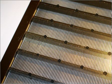

After achieving a low diaphragm tension, silicone dot spacers were applied every few cm.Capaciti's approach was apparently to LOWER the diaphragm tension...
Without them, the low tension would result in the diaphragm collapsing to the stator wires when bias voltage was applied.
Hi Bolserst: You have addressed something which I have not yet understood. Are these silicone dots in contact with the diaphragm in its central position, or do they simply act as "buffers" to limit the maximum excursion of the diaphragm?
Is this photo in fact one of Capaciti's ESLs? I have seen a reference of yours earlier to a photo of his ESL building, but had not been able to trace the source.

The silicone dots hold the diaphragm in it's central position.

A pic of one of my early segmented panels before attaching the front stator showing two rows of silicon dots.

Yes, that is a pic of one of Capaciti's ESLs.
He used to have a website with many additional pics of the stators in various states of build and testing, but it is no longer active. 🙁

Bolsert, Thanks for #91 which clarifies that the silicon dots trap the diaphragm at that point, preventing vibration. That being so, one can understand that the Audiostatic patent system of dots, (three down the middle which you linked to), will effectively divide the diaphragm into two long sections, each Xcm wide, rather than one long section 2Xcm wide.
This being so, I would expect your earler ESL that you linked to (post #191 in http://www.diyaudio.com/forums/planars-exotics/109789-esl-diaphragm-coating-20.html#post1942380), which had dots at 1/3 and 2/3 of the wire stator width, would produce three long vibrating sections in the diaphragm. I guess this was your intention. In a later ESL build (post #23 in http://www.diyaudio.com/forums/planars-exotics/245454-glue-wire-stators-3.html) you had what I take to be fixed strips to which the diaphragm was glued, dividng the diaphragm into three long strips 3.25" wide.
Capaciti's diaphragm which you linked to in #93 (attached below) shows at least four silicone dots across the stator (more are not visible). This makes me wonder whether the membrane might not "prefer" to vibrate in sectons with the dimensions diaphragm width x stator support distance rather than panel length x distance between silicone dots. In other words, one might achieve many narrow vibrating areas with the width of the panel as the longest vibrating length rather than a few strips as long as the panel. Do we know what actually happens?
The reason I started experimenting with silicone dots, is just as explained in the Audiostatic patent. If you have a wide panel and have the diaphragm tensioned for low resonance as needed for full range ESL, you can’t apply very high bias voltage before the diaphragm collapses to a stator. A few silicon dots down the centerline provides stability without raising the resonance frequency too much or eating up valuable radiating area. I switched to using strips instead of silicon dots in my later panels because low resonance was no longer a goal. Using higher resonance and crossing over to a subwoofer in the 70Hz-80Hz range provides 90% of the benefits of a full range ESL but with +5dB to +10dB more output capabilility. Capaciti, on the other hand, described his prolific use of silicon dots as a method of controlling the resonance modes of the diaphragm. I experimented a little with this concept without much success, trying 1, 2, & 3 even and staggered arrangements. I switched to damping the resonance modes with acoustic resistance from fine mesh like Quad does in their ESL63 and descendents.Bolsert, Thanks for #91 which clarifies that the silicon dots trap the diaphragm at that point, preventing vibration.
I believe you are asking if the diaphragm will have vibration modes with nodes and anti-nodes spaced across the width in addition to modes where they are spaced along the height. They answer is yes, both occur. But since the width is so much narrower, the frequencies involved will be much higher. As golfnut mentioned back in Post#64, at higher frequencies, the resistive component of the radiation impedance is orders of magnitude larger than it is at lower frequencies and provides even more damping than the mesh would.This makes me wonder whether the membrane might not "prefer" to vibrate in sections with the dimensions diaphragm width x stator support distance rather than panel length x distance between silicone dots. In other words, one might achieve many narrow vibrating areas with the width of the panel as the longest vibrating length rather than a few strips as long as the panel. Do we know what actually happens?

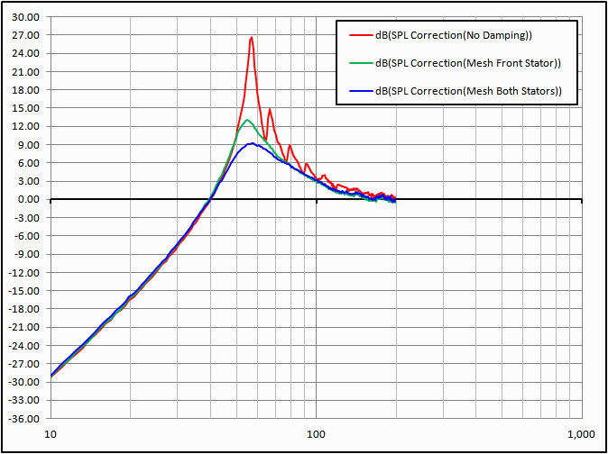

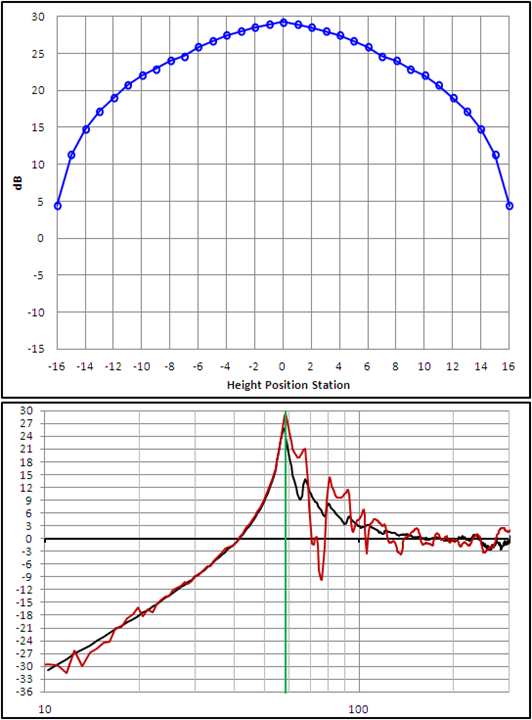

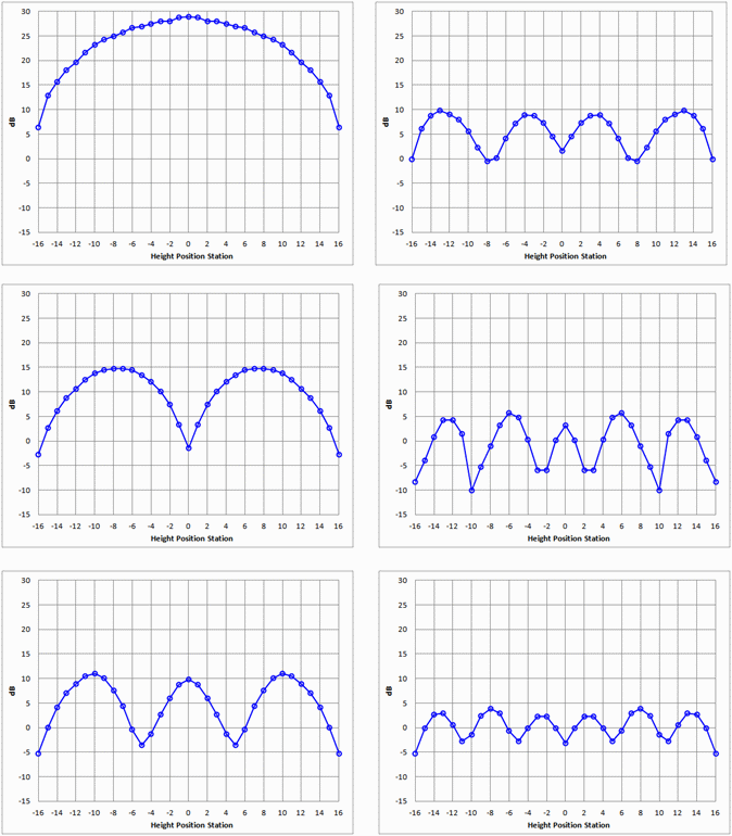

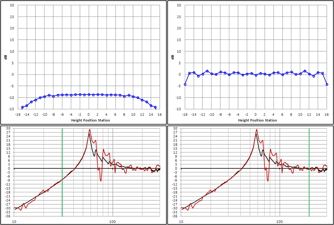

Seeing this reminded me I had performed another interesting set of measurements on diaphragm modes that I had meant to post. The subject panel was 64” x 3 1/4”, and measurements were taken every 2” along the height of the panel. I could then plot response as a function of position to show the shape of the diaphragm modes. Just for fun, I made a short video clip showing the changing in diaphragm mode shapes as frequency is swept from 30Hz to 200Hz. I find it fascinating to watch as the mode shape transitions to higher orders and different combinations. See attached *.zip file.… I had forgotten all about posting these measurements where you can see the resonance nodes and anti-nodes along the height of a panel.
After playing the video clip, you will notice that:
Attachment #1: Well below and well above fundamental diaphragm resonance, the diaphragm moves essentially as a flat piston.
- The Blue Curve in top plot shows relative response along the panel height.
- The Red Curve in bottom plot is the response measured at the center of the panel.
- The Black Curve is the complex sum of the response measured all along the height of the panel. Basically, this is net radiated acoustic response.
Attachment #2: At fundamental diaphragm resonance, the diaphragm moves with the expected catenary shape.
Attachment #3: Above fundamental diaphragm resonance you will find many different mode shapes and combination of modes.
Attachment #4: Comparison of net panel response with addition of damping mesh.
With damping mesh in place the complex modal behavior was damped leaving only the flat plate and catenary shapes.
