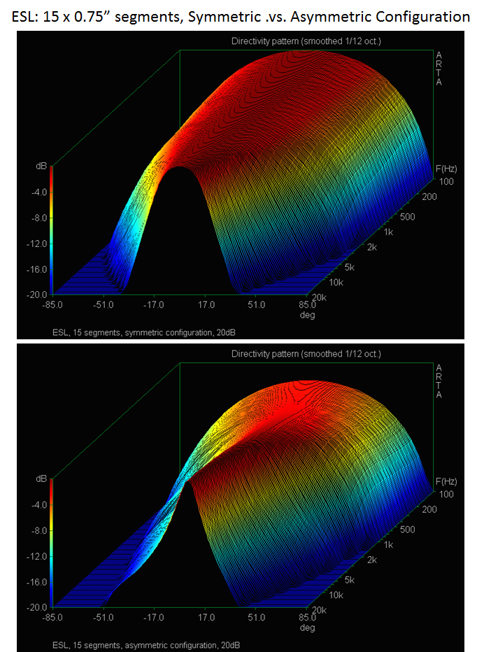

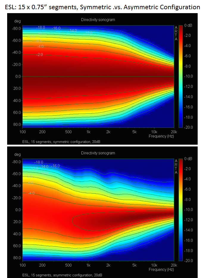

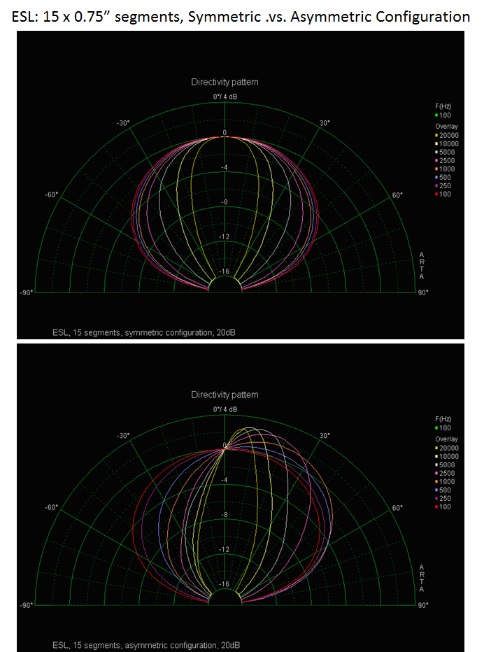

I believe both configurations with 1X width or 2X width central segment surrounded by symmetric arrangement of remaining segments qualify for "symmetric" version magic.Question: Is the "symetric" version the one where the central segment width is 2X the surrounding segments?
I’m sure golfnut will jump in soon enough, but I just happened to be cleaning up some old simulation files and ran across these directivity comparisons I created several years ago that may help answer your question. The “magic” of the symmetric configuration is evident by the broad smoothly trending polar response. By comparison the asymmetric configuration results in narrowing, peaking, and shifting of the main polar lobe as frequency increases.And could you please expand your explanation a bit regarding the "additional magic" with the symmetric version, in layman's terms that a dummy like me might understand?
Note that the comparisons are for the same segment size and number of segments.
Atttachments 1: Comparison of Directivity Polar for Symmetric .vs. Asymmetric Segmentation
Atttachments 2: Comparison of Waterfall Polar Response for Symmetric .vs. Asymmetric Segmentation
Atttachments 3: Comparison of Sonogram for Symmetric .vs. Asymmetric Segmentation

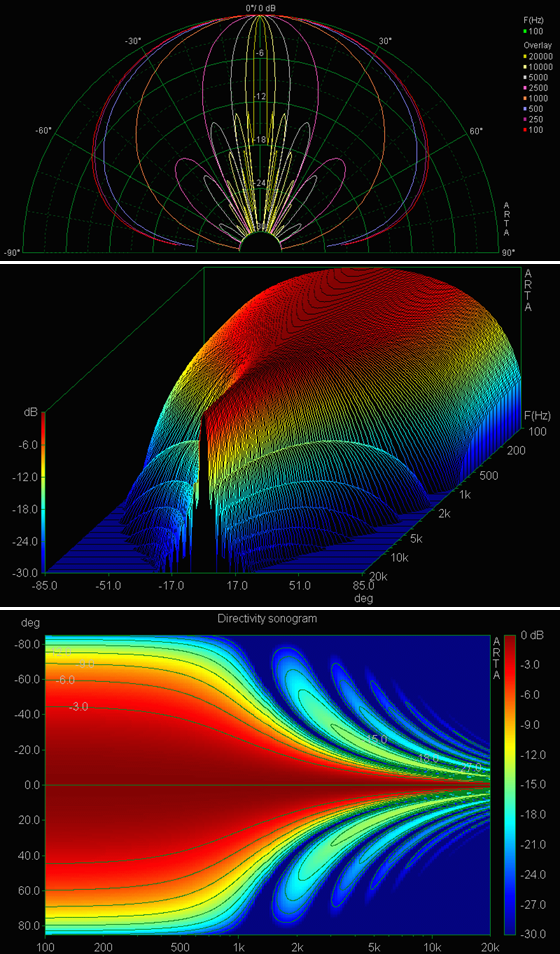

Atttachments 4: Directivity Polar, Response, & Sonogram for un-Segmented ESL
Atttachments 5: Directivity Polar, Response, & Sonogram for Asymmetric Segmented ESL
Atttachments 6: Directivity Polar, Response, & Sonogram for Symmetric Segmented ESL

Hi Charlie
Re additional magic of symmetric segmented ESL....
I'm sorry I cant think of a really simple explanation, though Bolserst gives a really nice summary of the results 🙂.
The essence of the problem is phase differences between sound waves coming from different parts of the diaphragm. Keep in mind that the wavelength of sound at 10 kHz is about 30 mm.
If one part of the diaphragm is half a wavelength closer or further from the listener than another part of the diaphragm, then the two waves will cancel.
These cancelation effects become apparent at high frequency where the wavelengths are shortest. The effects are also most apparent off axis where the differences in distance between the middle and the edges of the panel are greatest. It also turns out that abrupt edges in the radiation pattern also cause ripples.
So the ideal ESL is very narrow at high frequencies to avoid these effects, and wide at low frequencies so it can produce sufficient bass SPL.
If you think of the segmented ESL as a sequence of low-pass RC filters you can see that it achieves this ideal. At high frequencies, most of the sound comes from the central segment. As the frequency falls, the radiation pattern gradually spreads out until at low frequencies the whole panel radiates. Also, there is a gradual progression from high to low output on both sides of the panel = no abrupt edges in the radiation pattern.
hope this makes sense

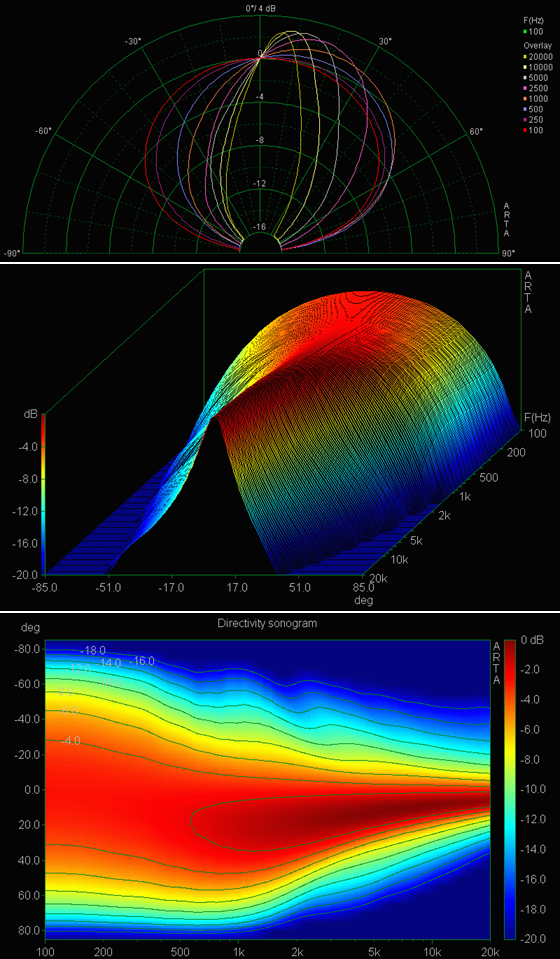

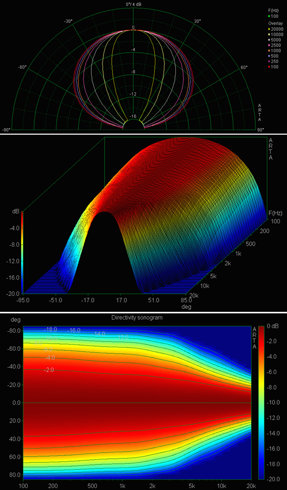

It occurs to me that some might appreciate a technical description of the origin of polar response effects....
It turns out that the far-field response of an ESL is related to the Fourier transform of the stator current distribution.
The single segment ESL, which has the same stator current over the whole area, has a polar response given by the Fourier transform of a rectangle, which consists of two different sinc functions (sinc = sin(x)/x function) - one in vertical direction, one in horizontal direction. This gives the very narrow pattern with lots of lobes that you can see in Bolserst's figure for the unsegmentred ESL. The result is the classic head-in-a-vice ESL with a sweet spot that is often narrower than the listeners head.
For the symmetric line-source segmented ESL using the RC transmission line, the stator current distribution has the central segment at full current and an exponential decay in current either side (left and right). The Fourier transform in this case is the second-order Butterworth. AS you can see from Bolserst's pictures, the sweet spot is much wider and there are no lobes. Note that the line source should ideally be infinitely tall to avoid the lobing effects in the vertical direction. If the ESL is tall enough, the reflections off the floor and ceiling do this for you.
For the Quad ESL-63 family of ESLs, Walker attempted to simulate a point source, for which the Fourier transform is an infinite plane - i.e. perfect polar response. Unfortunately, commercial imperatives and the limited number of circular segments means that they perform OK only near the centre of the polar pattern. As close as 15 degrees of so off axis, there are holes in the response at some frequencies (see the Quad datasheets), probably caused by phase reversals and cancelations due to the finite segment widths.
hope this helps
Rod

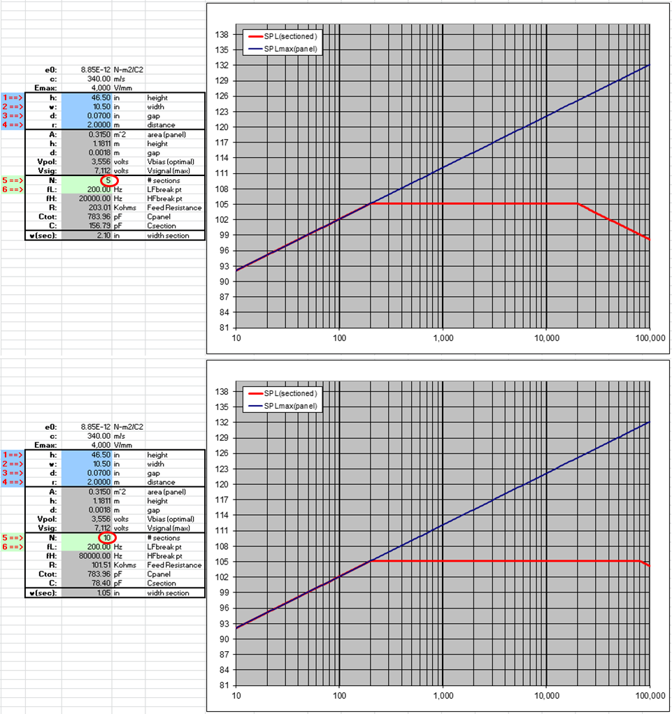

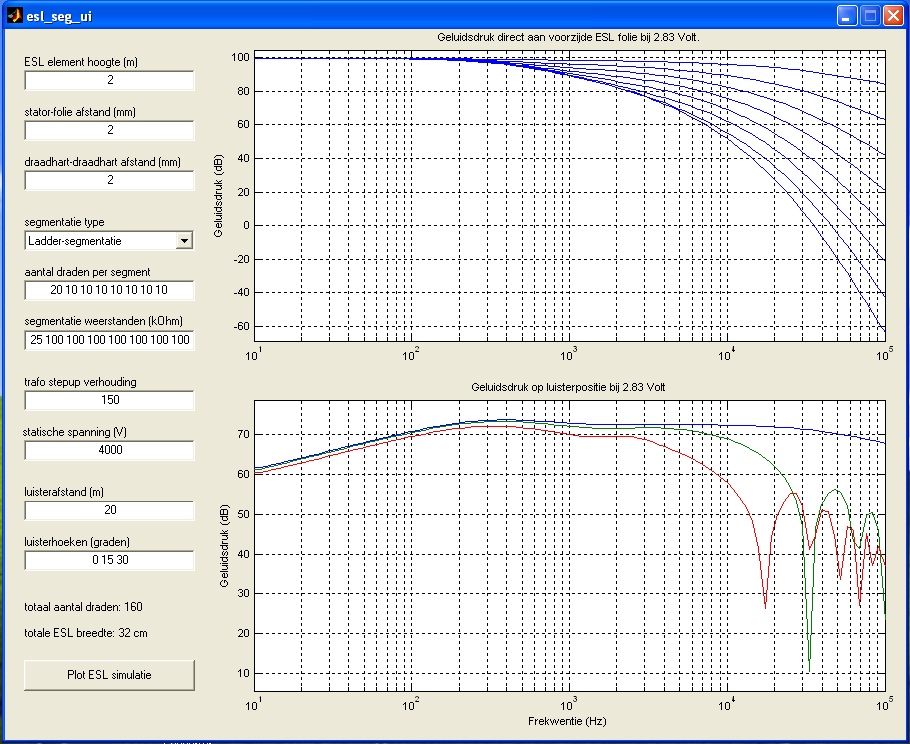

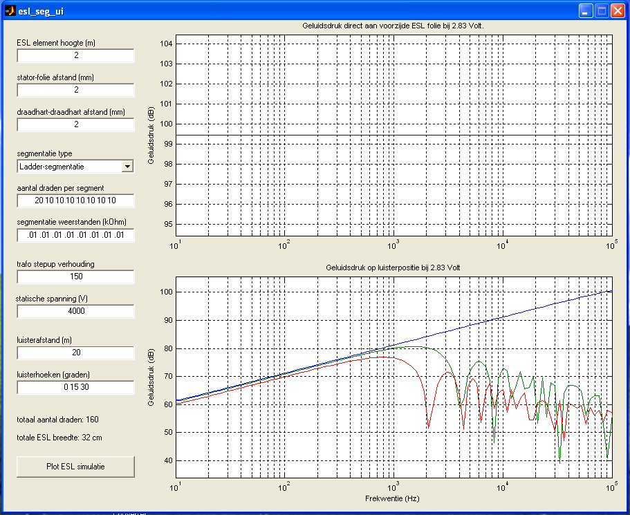

You may recall from the Segmented ESL spreadsheet calculator (based on golfnut's AES paper) that the natural response of an ESL line source is not flat, but increases with frequency sloping up at +3dB/octave. This is the blue line shown in the plot in the spreadsheet.(Attachment #1) The resistor values determined by equations from golfnut’s AES paper result in a flat response from the chosen low frequency limit fL, and extending to an upper limit fH which is dependent on the number of segments you choose. You are correct that the progressive loss of high frequency energy as you move from segment to segment is what keeps the response balanced. Note however, that the resulting dispersion “is what it is”. You cannot independently manipulate the dispersion without affecting the flatness of the response, or manipulate the response without affecting the dispersion.…Even though I can’t hear much past 5Khz, I have a fetish for treble so I want to know that whatever segmentation arrangement I might use would retain really good treble response. Assuming the panel’s frequency response (dipole roll off aside) would be approximately flat with no segmentation (is that a valid assumption?), I’m struggling to grasp how a series of low pass filters would not so restrict treble output as to render the frequency response unbalanced toward the bass end. Am I correct in assuming the energy loss at each downward step is what keeps the frequency response balanced?
A few links to jog you memory on these topics:
http://www.diyaudio.com/forums/plan...-segmented-wire-stator-esl-3.html#post4183068
http://www.diyaudio.com/forums/plan...-segmented-wire-stator-esl-9.html#post4192859
Also, remember that the “esl_seg_ui” calculator provides a plot(upper) showing the drive signal reaching each segment so you can get a feel for how high frequencies are progressively filtered out.(Attachment #2) If you set all the resistors to low values you effectively have an un-segmented panel and you will see the +3dB/oct slope in the on-axis response.(Attachment #3)
http://www.diyaudio.com/forums/plan...r-esl-simulator-esl_seg_ui-8.html#post3960276

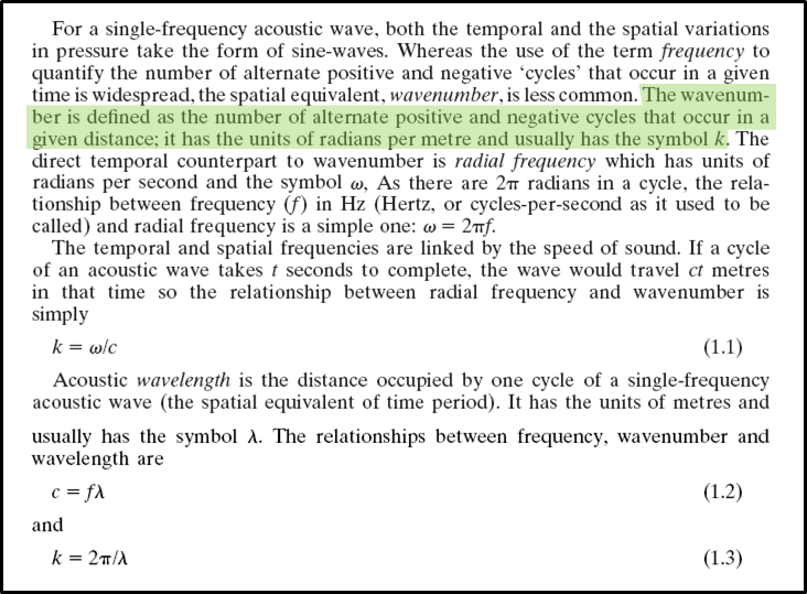

Attached is an excerpt I found helpful for understanding what the wave number "k" represents.
Basically it is the spatial equivalent of frequency. (ie cycles per distance rather than cycles per second)
Reference:
Loudspeaker and Headphone Handbook, J. Borwick, Ed.
(Reed Educational and Professional Pub., Woburn, MA,
1998), pp. 3 – 4

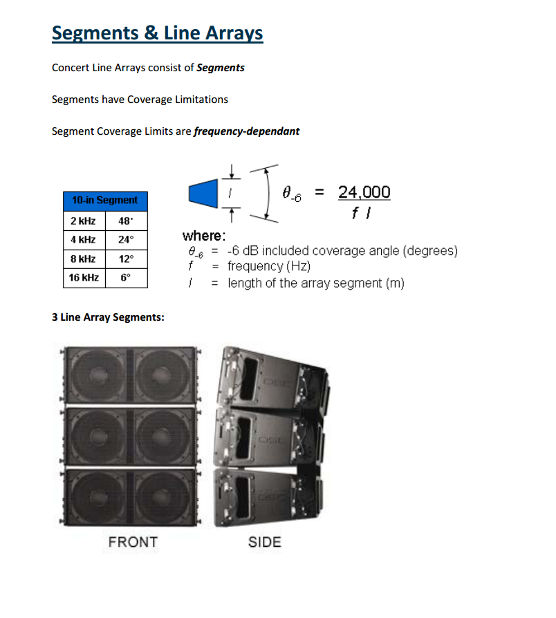

This is a great discussion!!!
Quite a while back I was reseaching this stuff and I wanted to know the formula that shows the relationship between ka and the dispersion angle for a frequency.
Then I stumbled upon this paper,
http://www.proaudio-central.com/files/2015-09/line-arrays-part-i-designing-and-deploying-qsc.pdf
On Page 6 it shows a very simply formula for this.
I had used this formula to painstakingly plot out a function manualy and compared it to FRD Consortium spreadsheet that does this as well and seems fairly accurate.
I had posted a links to these pages before and also the very useful spreadsheets but they keep getting moved.
I have all of the spreadsheets I believe, and if anyone wants them I would gladly make a ZIP file to send to anyone.
Or I could post it here if it is okay without breaking any rules since they are getting hard to obtain and move around a lot.
They are what I used to predict my Segmented Desktop ESL design at ESLDIY, but sadly all of those pictures have not been restored yet.
I still have them all but they are scattered in my archives at the moment, Sorry or else I would repost them here.
Anyhow this time I have made a screenshot of page 6 to post here for safe keeping.
Cheers!! 🙂
Cheers!! 🙂
jer 🙂
P.S. I just located the link for spreadsheets,
http://www.rjbaudio.com/Audiofiles/FRDtools.html
The FRD link is broken and the spreadshet I used "Asymmetrical Response
Pattern Estimator" is found here,
http://alloy.wishray.com/frd/frdgroup.htm
Bolserst, you have an uncanny ability to sense that people such as me are missing something in understanding a concept, yet manage to steer us in the right direction in a non judgemental way!
Maybe Beranek could have been more helpfull by devoting a paragraph to explaining the ka factor; instead, we have the wave number mentioned on P26. It is not untill P102 that we see it multiplied by the radius of a piston, a, to become the ka factor.
In the new Beranek/Mellow edition P32 things improve somewhat when they mention "When k is multiplied by a characteristic dimension such as the length of a tube or the radius of a circular radiator, it forms a dimensionless parameter that is proportional to frequency"
Pi being relevant to both angular velocity and the geometry of circular disks has the potential to muddy the waters, I can now see.
Keith
Keith

Hi ENCR
I have thought about a number of options, but a simple option is an RC transmission line with maybe 39 segments (10-15 mm wide) arranged in three vertical sections of 13 segments each and the same width. The transmission line is driven at the central segment of the middle section. The design would require a largish PCB perhaps 450 mm wide and 600 mm long - but within the capability of most PCB makers. The membrane would be glued to ~ 10 mm wide spacers separating each section and to spacers on the outside edge of the PCB. The central section, would then carry the midrange-treble-bass, and the outer two sections essentially bass only. The T-line resistors would be 1W high voltage surface mount and soldered directly to the copper on the PCB, which would face outwards in the final assembly.
Any number of stators can be stacked as required - the resistor values stay the same for a given frequency response! Three stator sections tall = 1.8m + perhaps 100 mm for frame and pedestal, would be a good size for a home full-range ESL. Two sections =1.2 m good for a hybrid. Maximum overall width turns out to be about 500 mm. Any wider and lobes start appearing in the polar response.
hope this helps
hope this helps
