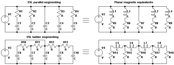

I hope this isn't too off topic. I'm interested in implementing a similar approach in a sectioned planar magnetic driver, rather than an ESL. I'm sure there's no acoustic reason it shouldn't work similarly. Any suggestions on the best circuit topology? I'm envisioning vertical parallel aluminum conductors immersed in a magnetic field. With the foil I have on hand it's convenient to have individual conductors with resistances on the order of 1 or 2 ohms. I can run multiple physically parallel, but electrically in series, conductors in each magnet gap to increase the resistance if necessary.

Thanks very much for the response. Some form of RL network is what I was envisioning. I bought what was described as 5.5 um thick Al foil and very thin polyester film so that I could get as close to an ESL's lightness as possible. Alas, I've discovered the foil is 13 um thick, not 5.5 um. Now I'm fiddling around with geometries hoping to find a way to make use of it without undermining my original goal. That fiddling has led me to wonder what my options are as far as controlling the directivity.

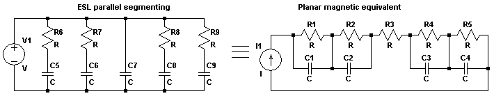

Segmented planar magnetic speaker is doable. I finished such a construction recently. I connected the aluminum segments electrically in series and segmenting filter was done with parallel capacitors.
If you think of current drive, this provides the same electrical response as ESL parallel segmenting RC filter. Response with voltage drive is different but it does not affect the segmenting. A series L-C-R filter was used to correct the overall response.
I used 12 um polyester and 27 um aluminum which is rather heavy duty. I got barely enough high frequency output and impedance minimum is low. Your 13 um aluminum should be less problematic.
Maybe you can get more info from my web page. It's in Finnish, so try a translator.
Magnetostaattiset kaiuttimet
RL structure (inductor in series with segments) was considered but it seemed impractical:
- Series configuration: each segment would need a bypass-path for high frequencies (capacitor and/or resistor).
- Parallel configuration: total impedance would be very low. However, this would make direct counterparts to ESL parallel and ladder structures. It could be doable with very thin aluminum strips or an impedance transformer.

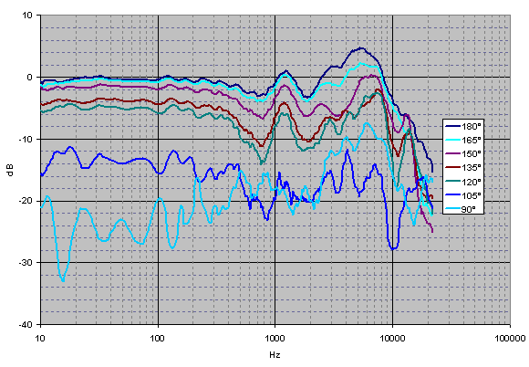

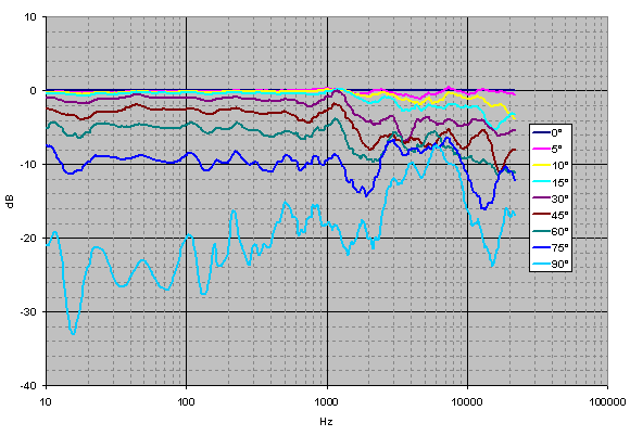

Many thanks Pollo, and that's a very nicely constructed project you have there! I'm using a vertical array of open backed woofers for the bass so I'm only looking to use the planamagnetc driver down to 300-500 Hz. I was hoping for good sensitivity with the NdFeB magnets so your finding concerns me a bit. Perhaps the thinner foil will help.
Do you have any directivity measurements you could share? I think they'd be on the topic of the original thread and the comparison with ESLs might be of interest.
Thanks again
Few
The widths of segments are 67 - 43 - 17 - 43 - 67 mm, and the total width of the speaker is 360 mm. Low-pass corner frequencies are 730 and 370 Hz for 43 and 67 mm segments respectively. There may be still some room to optimize the widths, frequencies and number of bands.
Frequency response was measured in an anechoic chamber from 0 (front) to 90 (side) to 180 degrees (back). We are not interested in the front response here because it can be equalized freely. The curves are normalized relative to the front response to demonstrate the directivity more clearly. Some smoothing was applied.
The attached pictures shows the horizontal directivity in the front and the rear. Radiation pattern is almost a figure-of-eight below 1 kHz. There are some irregularities above 1 kHz, but I have avoided strong beaming at highest frequencies. The rear responses are not as pretty as the front responses. Lower treble is peaking and higher is attenuated, which is caused by mechanical structure (magnets, perforated plate, damping material). ESL would be better in this respect.
The sensitivity was good in the midrange before I added the series filter. I had to attenuate 1.5 kHz up to 17 dB to get the midrange at the same level as bass and treble. Lighter materials should extend the good sensitivity range to higher frequencies.
