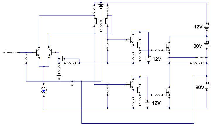

yeah there are certainly other ways to build a n-channel amp
hello Quasi & Lars,
look at the schematic block diagram featuring direct cascode loading , individual floating gate drivers supplies, suprimosed supply for VAS.
What are your views regarding this type of amp.
Please comment.
regards,
kanwar

Hi Workhorse.
I think my comments above will be unchanged regarding this design, even if you have sorted out the unsymmetric clipping. 😉
It's simply not a very good basic design, sorry

kanwar, will the zener diode be your thermal compensation device? Do you really need the darlington buffer for just a pair of output devices? Also the additional 12V supply for each darlington means an over complex PSU IMO. It would be fine to connect them to the 80V rail, wouldn't it? I'm sure the dissipation would be manageable.
How about replacing the gate pulldown resistors with current sinks? That way would give nice fast turn off and less cross-conduction? However, unless the sink was set on a rail of lower voltage than the MOSFET source, it would not be able to pull down enough I think, which would be disastrous. Also, there could be a problem if the driver transistor turned off, depending on how the sink was implemented.

Sorry Workhorse, jus a bit busy sometimes (I gotta work for a living etc...)
I never thought of setting up a constant current source for the second stage like you have (at least I think that's what it is). I have never been able to do better than 2 diodes on the base emitter junction (0.6v / emitter resistor etc.).
I see what you are trying to achieve with the applying only 12 volts to the second stage but I think that would be more complicate than indicated by the cct. I agree with richie00boy and would tie both the postive side and negative side transistor collectors to the positive rail. I do note though that the darlington pair on the negative side will have around 170 volts across them so SOAR could be an issue. This can be resolved though with suitable or parallel devices. In my cct I am thinking about running another set of MJE350's in parallel with current sharing resistors to split the current.
I don't think the darlington are really necessary because you would only need an overall voltage gain for the amp of around 50.
I have found that even with the raised positive rail for the input and driver stages the amp centres very nicely and does indeed drive rail to rail.
If you run 20 - 30 milliamps in the second stage then turn off issues with the output FETS will be less of an issue. You could run say 100 mA but the second stage could get very hot.
Interesting thinking Workhorse...have you tried this on the bench?

Hi everyone,
Thanks for the comments....
This amp was simply just an IDEA that came in my mind😀 😀 😉

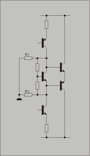

Below a sch of the last half of a basic power amplifier. I added the 2 resistors R1 and R2. They have no apperant effect, in the circuit.
What they do however is to replace the high Z of the collectors from the gain stage ( 1 Meg ) with say 10k. This gives the amplifier 100 times lower Natural Damping Factor. It also lowers the feedback factor, while maintaining the voltage amplifier's pole intact. And thus improves the stability of the amplifier. I will add in most cases, just to avoid any attacks from the tg's 😉
Basicly it gives a lower feedback factor, and thus a higher THD, and in the same time improves the sound quality. Try it out in your own amplifier .....
In fact only one resistor is needed, but might give a slight DC offset.
Lars , we are already using this collector resistor in our own amps, yes you are right about their sonic clarity effect.🙂
but you dont answer my question regarding rail loss , about your ZETA.
Hmmm...
Robert Cordell has done a lot to debunk all this mythology about TIM, Interface IM ad nauseum... that seems to flow from Scandinavia..
"Another View of TIM" (Audio Feb 1980),"Interface Intermodulation in Amplifiers" (Wireless WorldFeb 1983) and
"Open-loop output impedance and interface intermodulation distortion in audio power amplifiers" (AES Conv NY 1979)
I'd suggest what you're hearing with the Vas loading resistors in place is euphonic 2HD. I improve such amplifiers for clients by pulling these resistors OUT.
