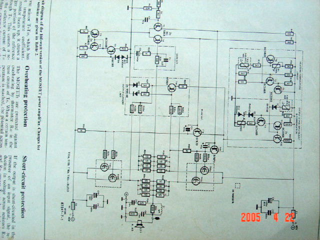

edl said:
I wonder why they use such a complicated thermal compensation circuit. Well I better build my version then and find out.
I still think that the negative rail output FETs are on the wrong side i.e. they should be on the source. It does make the short cct protection slightly easier to configure though.
Looks like they are only running around 4 mA of driver current per leg.
Cheers

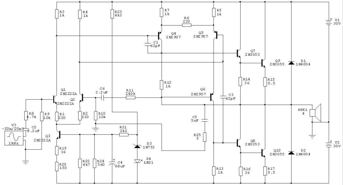

I didn't want to start a new tread because my subject is related to this tread.
I like the quasi-complementary design because I think easier to find transistors with similar parameters of the same type than of complementar pairs.
Lately I have found an interesting Russian page George Krilov - http://geocities.com/researchtriangle/node/2356/
http://geocities.com/researchtriangle/node/2356/newscheme.html - On this site the last schematic is a quasi-complementer design
The schematic uses bipolar transistors and the author wrote that the circuit is not stable yet, but he gives some advice as to how to correct it.
What do you think about the schematic?
