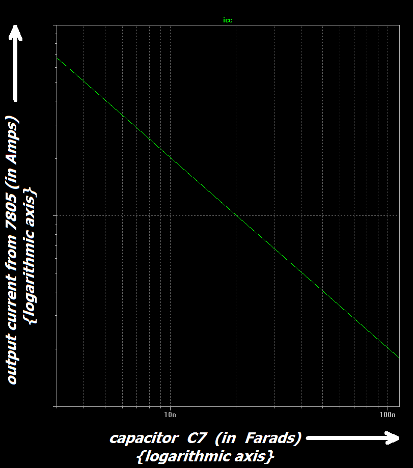

I'm still puzzled
As many will know in their bones, when you see a straight line on a log log plot it implies a relation of the form of y = ax^b, where a and b are constants. The slope of the line gives the power b, and its intercept with the vertical line x = 1 gives the multiplier a. Even without vertical axis labels the slope of the line in the log log plot is discernible as -1, since moving along the line 1 decade rightwards also movers 1 decade down. So y = ax^-1 I.E. y = a/x. In this case y is I, the load current drawn from the 7805, and x is the value of C7. Thus
I = a/C7
The linear plot is consistent with this, having the familiar shape of y = 1/x. Of course, without vertical axis labels the linear plot's also consistent with y = b + a/x, since adding b just moves the curve up or down, and multiplying by a just stretches or shrinks the vertical axis. But the log log plot clearly indicates just y = a/x, with nothing added (I.E. b = 0).
C7 sets the frequency, which is inversely proportional to C7. So I = a/C7 is saying I is proportional to frequency. This makes sense for a purely capacitive load. Each capacitor charges once per cycle. Doubling the number of cycles per second doubles the number of times the capacitors must be charged and thus doubles the average current drawn.

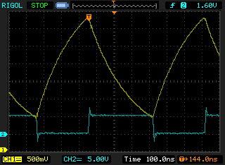

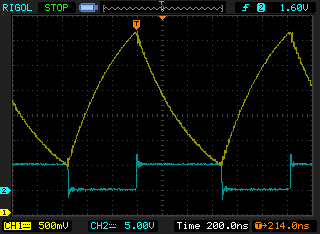

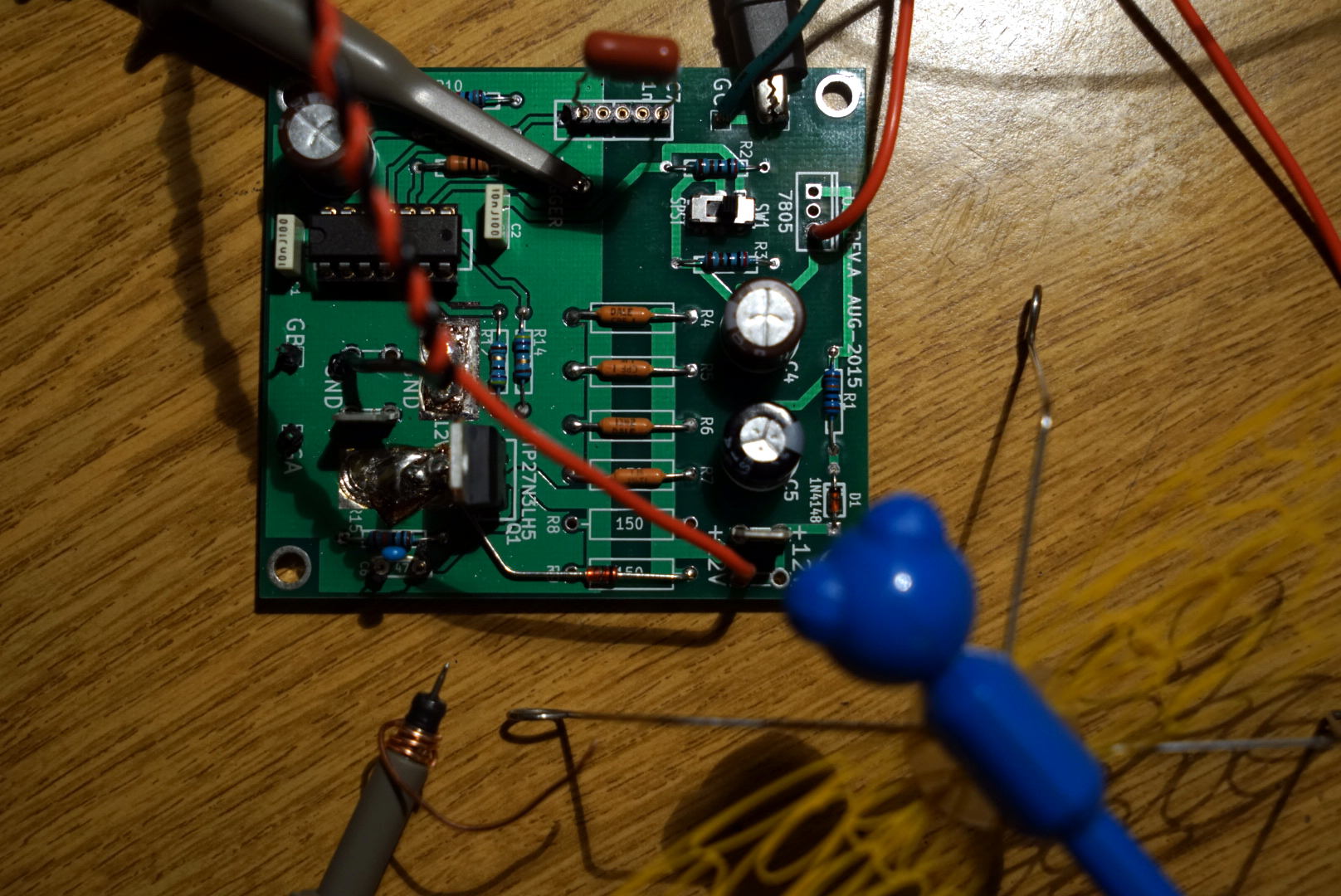

What's puzzling though is that when I look at the REV.B circuit diagram, I see some none capacitive loads on the 7805. Notably R2 and R3, which draw a standing current of 5 mA.
Also, in my previous post I argued that the load on the 7805 from the average current through C7 is also constant with respect to frequency. Although C7 is a capacitor, and is charged once per oscillator cycle, it's also the part setting the frequency. Halve it to double f, and though it's charged twice as often, it's only half the capacitance that must be charged. Seems like a QED doesn't it: an unassailable watertight rational argument that simply cannot be wrong.
I'm guessing that the missing standing current from R2 and R3 is because they weren't in the simulation that produced the graphs.

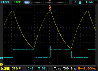

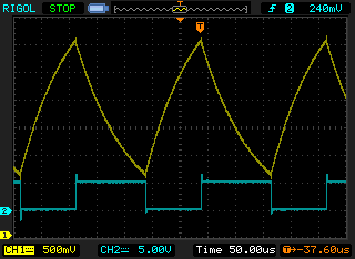

Leaving only the question of the failure of my reasoning about C7. The algebra's not wrong, so the problem must be in my understanding of the circuit in the first place.
Prompted by that straight line on the log log plot, I can see a few places where I went wrong. All to do with how the oscillator works. One moral is don't rush to judgement, I hadn't even bothered to calculate the pole frequency for 1K and 100nF. It's 1.592 kHz, rather less than the 4.5 kHz oscillator frequency. At 4.5 kHz I calculate an attenuation of 0.333 and a phase shift of 70.5 degrees.
So C7 isn't charged and discharged through anything like the full 5 v, more like 1.67 v. And that's assuming the voltage at the output of U2E swings through the full 5 v. It might not, for the circuit to work it would only have to swing through the hysteresis voltage on U2B's input. I'd guess it's pretty much the full 5 v though, but it's a weak guess, I've really no very good idea at all. Also, because both pole frequency and oscillator frequency are inversely proportional to the same thing, C7, it still looks like C7 draws a constant current independent of frequency, unless the peak to peak voltage swing at U2E's output changes with frequency, or something else I haven't thought of.
By this point something started dawning on me. I'd been assuming that a 74AC14 output is always at either 5 v or 0 v -- like a "perfect" digital chip. But, of course, it's made from an analogue circuit on the inside. Could it be that the circuit inside the 74AC14 operates in a linear mode when it's input moves slowly (by digital standards) through it's transition voltages? Could current drawn in such a linear mode account for the current being strictly inversely proportional to C7, without any constant standing current? It seems a bit weird for this to produce a current load rising with frequency though. Obviously what happens depends on what's inside the 74AC14.
The Fairchild 74AC14 datasheet I've been looking at doesn't include an internal circuit diagram, and gives no information on any linear operating modes. I looked online for a 74AC14 spice model, but I only found a digital one, characterizing it in terms of propagation delays, etc. Without knowing more about the 74AC14 the value of further speculation is dubious.
MJ must have an LTSPICE model for the 74AC14 to produce the graphs shown.

The voltage regulator supplies power to the first 3 logic gates (the "oscillator") and also to the final 3 logic gates (the "output driver"). C7 controls the frequency of the oscillator.
I only took a quick glance, but I don't think I see see any mention of the output driver and its load (the load is simply the capacitance it drives, i.e. the capacitance "looking into" the MOSFET gate, including Miller Effect and nonlinearities and other ick-ptui).
In the first halfcycle, the output driver sucks a packet of positive charge from its +5V supply, and places that charge on the MOSFET gate. In the second halfcycle, the output driver steers that packet of positive charge, to its GND supply.
Some number "Q" coulombs of positive charge, are pulled from the +5V supply, placed on the MOSFET gate, and then steered to GND, on every cycle. This happens "f" times per second where f is the frequency of the oscillator. In one second, Q*f coulombs are transferred from +5V to GND. I checked Wilkipedia and found out that the SI unit for Coulombs/Second is the Ampere. Conclusion: the output stage draws a current of Q*f amperes from the +5V supply. (This is a loooong term average, meaning an average over many cycles of the oscillator. In the case of an f=4500Hz oscillator, averaging over 4500 cycles (1 second) seems more than adequate).

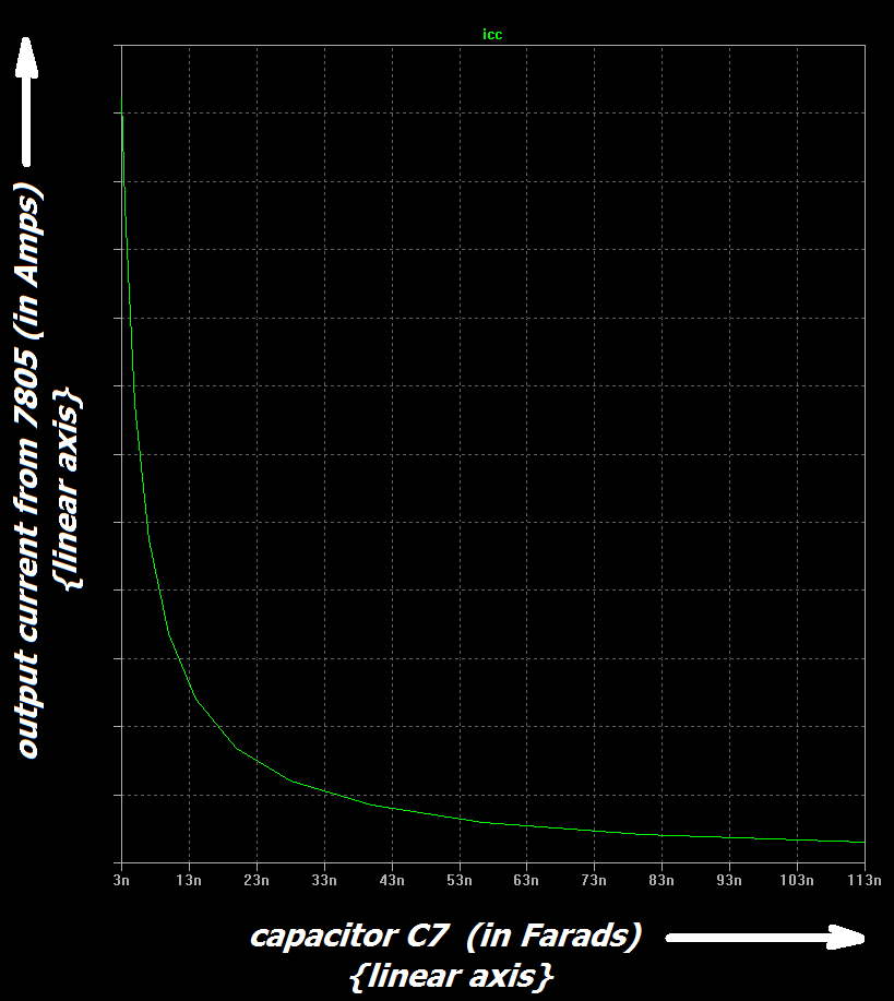

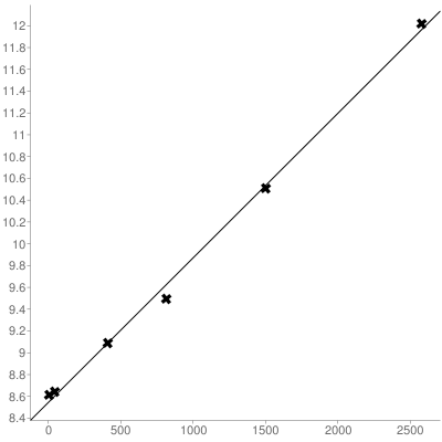

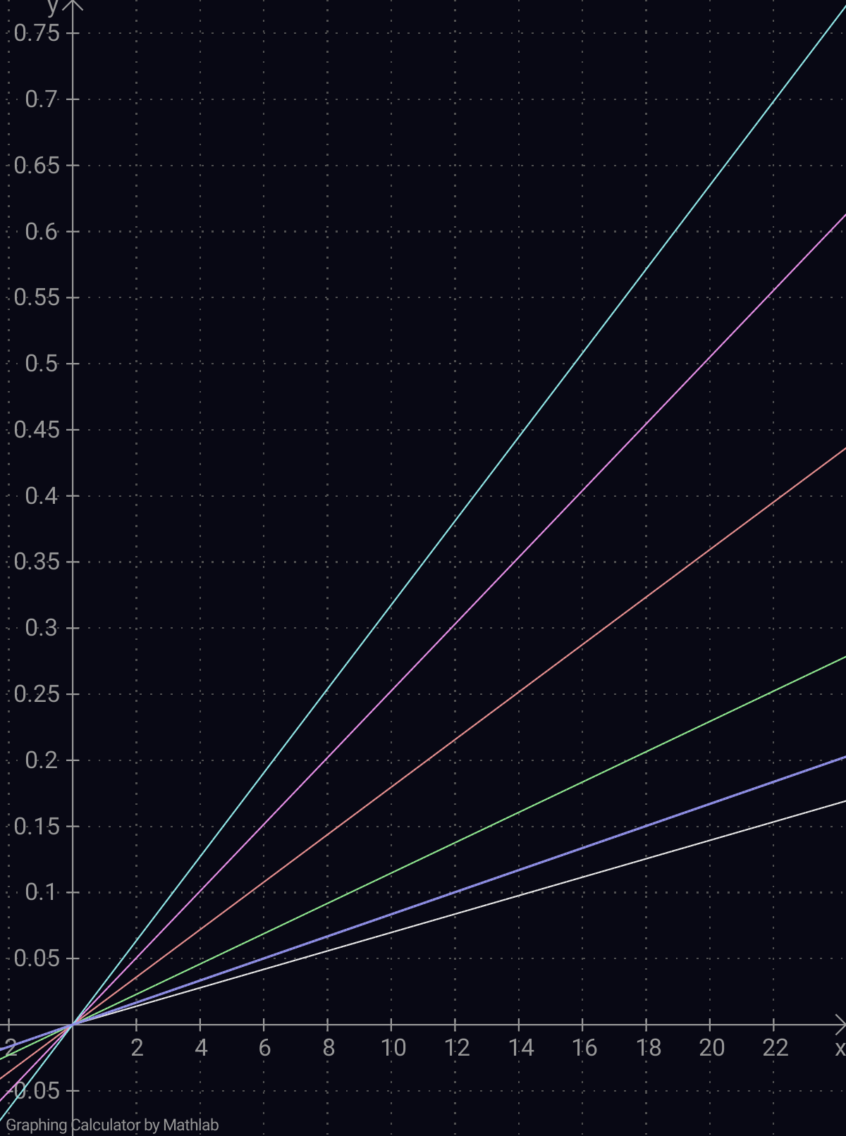

PART 1
I'm sorry.
What's happened is I've been writing about the stuff I don't understand, and leaving out the stuff I do understand.
I need to be clear about what is *NOT* puzzling me, as well as about what is puzzling me.
PART 2
My question is *NOT* why is there a term in the current drawn from the 7805 inversely proportional to C7, I'M EXPECTING A TERM OF THAT FORM, and in the appendix to this post will estimate the constant of proportionality from datasheet info for the current drawn by the 74AC14, the STP27N3LH5 and C6 as 2.7E-12 A/F. BTW, the reasons for bothering with the appendix are so that anyone who spots errors in it can point them out to me, and to give people helping me a better feel for what I do and don't already understand.
MY QUESTION IS WHY ISN'T THERE AN ADDITIONAL CONSTANT CURRENT on top of the proportional to frequency current drawn by the 74AC14, the STP27N3LH5 and C6?
How do I know there isn't such an additional constant current term?
Because of the straightness of the line in the log log plot (I attach a log log plot of y = 6 + 2.7/x -- so people can see how adding the 6 makes the line not straight).
Why do I expect an additional constant current term?
Most obviously, on the REV.B circuit diagram resistors R2 and R3 draw a constant 5 mA from the 7805.
Also, if we reduce C7's value by a factor of 2 we double the frequency. Consider what happens to the average current through C7 when we reduce C7's value by a factor of 2. The amount of charge it pumps from 5 v to GND per cycle is halved, but there are twice as many cycles because the frequency's doubled. Obviously, twice as many cycles, each pumping half as much charge, results in no net change to the rate at which C7 pumps charge to GND, even though the frequency's doubled.
The same reasoning applies whether it's a factor of 2 or 3 or any other number. This is the gist of why I've been expecting the current C7 draws from the 7805 not to vary, even when frequency's changed by changing C7's value. I put this argument in algebra in my 1st post on this page.

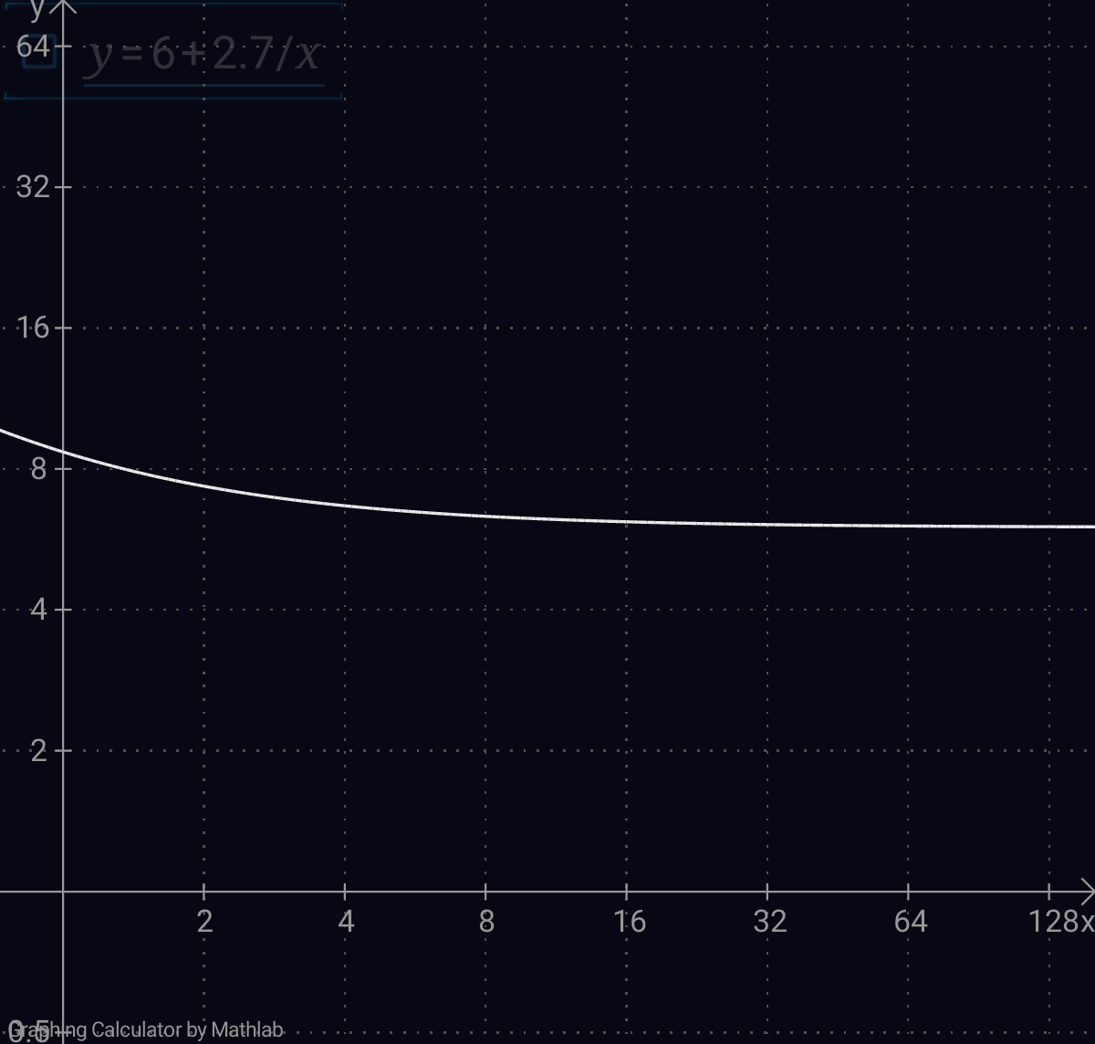

PART 3
Here, for a moment, is some of the stuff I do understand. (Or, at least, I think I understand ... 🙂)
I had realized a while back that the entire 74AC14 (max quiescent current 20E-6 A from the datasheet, assuming no linear modes), the STP27N3LH5, and the miller capacitor C6 could be very well modeled for power dissipation purposes as a single capacitor. You can see an expression for the average current drawn by a capacitor at a frequency in use regarding C7 in the following quote from my first post on this page
Since a capacitor obeys Q = CV the expression I = fCV is equivalent to I = fQ, the expression you develop here
By reasoning shown in this post's appendix I think that at a frequency f the 74AC14, the STP27N3LH5 and C6 draw from the 7805 a total current of
I = 6E-9f [ I in amps, f in Hertz ]

Since the frequency's inversely proportional to C7 we have
f = K/C7
Using the fact that 100 nF gives 4.5 kHz results in
K = f*C7 = 4.5E3*100E-9 = 4.5E-4
so
f = 4.5E-4/C7
and
I = 6E-9*f
gives
I = 6E-9*4.5E-4/C7 = 2.7E-12/C7
So the term inversely proportional to C7 I've been expecting is
I = 2.7E-12/C7
At 100 nF this evaluates to 0.027 mA. A lot less than the 5 mA drawn by R2 and R3.

To get a better handle on how the current needed varies with frequency and value of Miller capacitor C6 I made some graphs based on the expression
I = (5.75E-9 + 26 * C6) * f
from my previous post.
The frequency's on the horizontal axis in kHz, and the current drawn by the 74AC14, the STP27N3LH5 and C6 is on the vertical axis in mA. Each line shows how current increases with frequency for a given value of Miller capacitor C6. The following values of C6 are graphed
47 pF, 100 pF, 220 pF, 470 pF, 750 pF, 1000 pF.
Looking at these graphs I can see why MJ included the option to power the chop chop board from somewhere other than the PSU under test via the 7805. At 1 MHz the current is 32 mA for a C6 of 1 nF and 7 mA for a C6 of 47 pF. At 4.5 kHz the currents are all negligible -- very comfortably under 0.2 mA.
I see 2 basic useful frequency ranges for the chop chop box. A low frequency range, where the PSU has ample time to settle after each edge, allowing the edges to be observed as separate events that don't effect 1 and other. And a high frequency range where the next edge occurs before the PSU has settled down from the previous edge.
For my shunt regulator 4.5 kHz is good for a low chop chop box frequency, and frequencies around 1 MHz might be interesting for getting the edges to interact. My sense is that for the high frequency testing I'm better off powering the chop chop box from my bench power supply rather than from it's own 7805 based supply. Even with C6 at only 47 pF the current is 7 mA at 1 MHz, almost 10% of my PSU's rated output! But at the low frequencies the 7805 should be just fine.

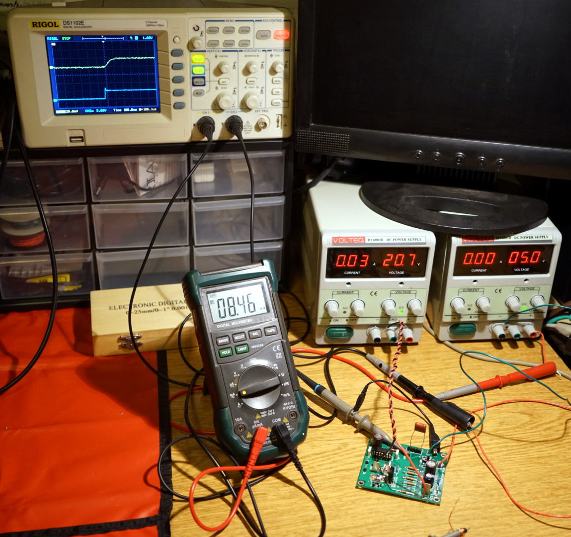

Chop chop board comes to life
The time has come to build the chop chop board. It's embarrassing because now you can all see my decidedly below average soldering abilities. But hey, outside of Lake Woebegone, somebody has to be below average. And the board powered up and worked correctly 1st time.
You might think that having built a PSU testing board, and having 2 bench PSUs available to test, the 1st thing I'd do with it would be to test a PSU. After all, it would be good practice for testing my own regulator design, which is the main reason I became interested in this borad. But this is DIY, not work, and we are free to pursue our curiosities in whatever directions may happen to take our fancy. As anyone who's read through this thread so far will know, I've been trying to develop an expression for how the current it will draw depends on C6 and C7, before actually building the board.
So I goofed off. Instead of testing a PSU I measured the current used by the tester. I'd never let myself goof off like that on a commercial project.
I left out the 7805 and 1 of the ground pins, to make space to solder 2 wires onto the board, through which I power it from a bench PSU. My shunt regulator is a low current design, and powering the chop chop box from it would use up at least 10% of it's capacity -- more at higher frequencies and values of Miller capacitor. Offloading the task of powering the chop chop board from the PSU under test, means that the tester can always test the full capacity of the unit under test. It also makes it easy to insert a current meter into the supply for the chop chop board.

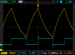

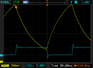

There hasn't been time to do very much yet, but I did make a few measurements because I wanted to know the current with the power MOSFET and the Miller capacitor *NOT* fitted. Later, by subtracting these numbers, it will be possible to isolate just the current used by the MOSFET and the Miller capacitor.
For each of these 6 measurements I attach an oscillograph showing the voltage at the trigger connection of the chop chop board (blue trace 5v square wave) and the voltage at the top of C7 I.E. point RCNODE on the circuit diagram (yellow trace, and my 1st use of a groundspring)..The photos actually show a slightly later test setup, with the MOSFET and Miller capacitor fitted, but otherwise identical.
This website
Linear Regression Calculator
graphed the current (vertical axis in mA) against the frequency (horizontal axis in kHz) and did a least squares fit for a straight line, yielding the expression
I = 8.5442108428714 + 0.0013271419445407*f [ I in mA, f in kHz ]
with a correlation coefficient (r) of 0.99850660936517.
Reducing to 3 significant figures and normalizing to amps and hertz yields
I = 8.54E-3 + 1.33E-9*f
I am still thinking ...
Code:
C7/nF Freq/kHz I/mA C7 pk-pk/v
0.1 2577 12.02 3.12
0.22 1502 10.51 2.9
0.47 811.7 9.49 2.74
1 406.5 9.09 2.66
10 44.25 8.64 2.6
100 4.425 8.61 2.62
This website

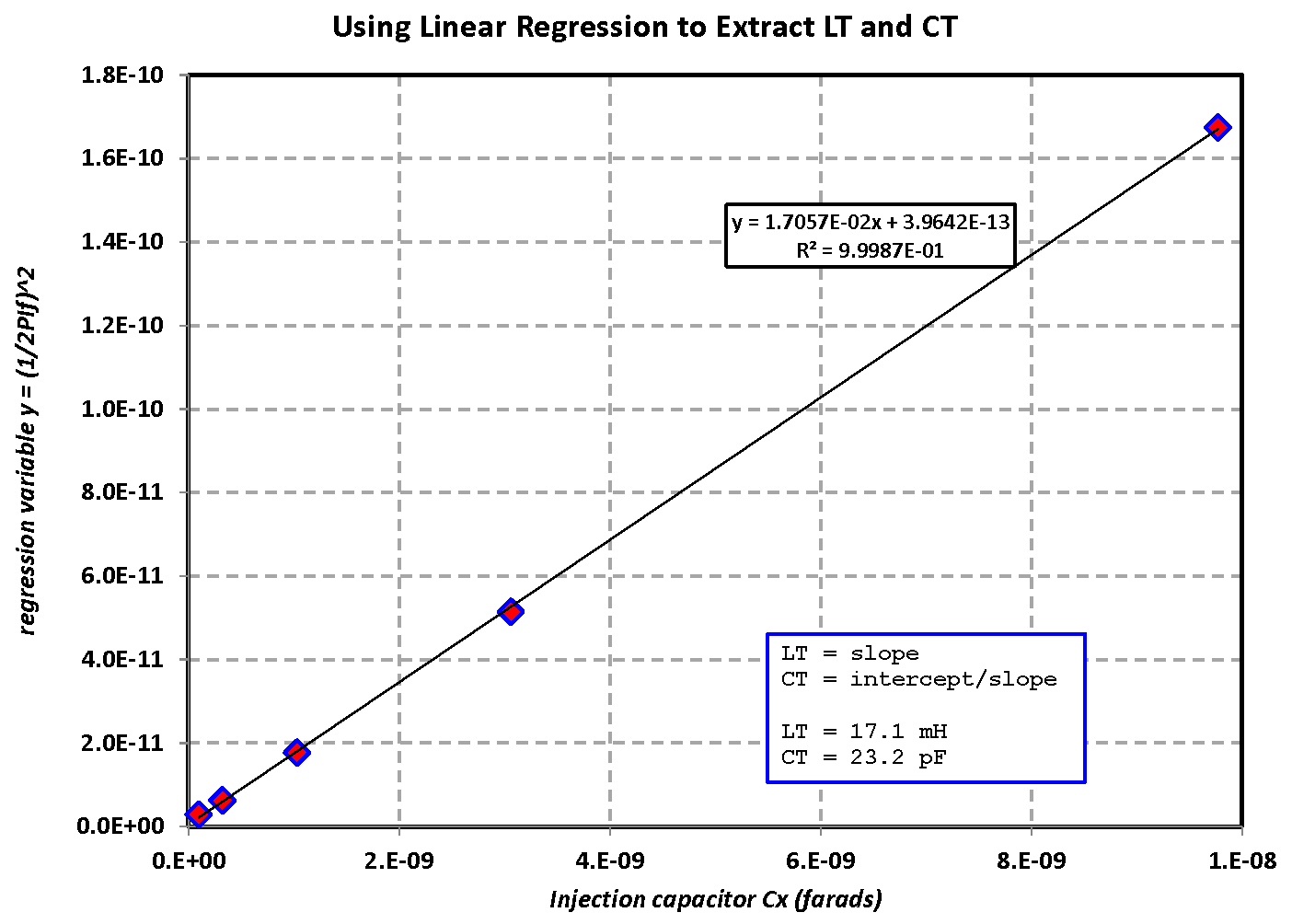

MS Excel will perform linear regressions too. They are called "trendline" and you really want to (1) make the equation visible on the chart; and also (2) tell MSExcel that the equation display box should present the coefficients in scientific notation with 6 decimal digits after the decimal point. But at least it's on your computer and at least you can plot the measured data versus the fitted equation.
It took 12 hours for me to remember that I put an example of an Excel linear regression, in the Quasimodo design note. It's Figure 17 on page 20.
Excel's fitted trendline equation is displayed (black box) in scientific notation with four digits after the decimal, and I told it to display the goodness-of-fit statistic Rsquared too. This box comes straight from Excel and all I did was fiddle with the formatting.
The blue box lower down, is merely a "Text Box" which I created. Excel had nothing to do with this except allowing me to write it, and to place it where I wanted it on the figure. I deliberately changed the font to something very non-Excel, to indicate: hey this is just a human comment.
You can compare the numbers in the lower box versus those in the upper, to learn whether my Casio calculator made an error going from y=mx+b to LT and CT.
_
_

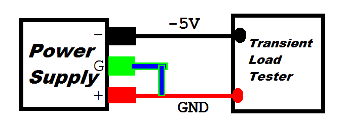

I keep wondering how one might tweak a board such as the circuit in post 1 to transient test a negative supply... I guess one could cut the supply to D1 (from what would ordinarily be the +12V input) and power the inverters/pass transistor gate from a 9V battery.
I'm new to thinking with -ve voltages. Am I right that the same n-channel MOSFET can be used if the foregoing is done? Presumably -12Vin would be connected to the GND connector tab on the board and Supply GND to the +12V connector in order to maintain the same direction of current flow through the pass transistor. R15 should still drain the FET gate capacitance in the normal way.
I'm not sure how C6 is affected though.

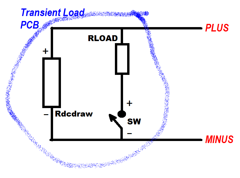

Perhaps the figure below might be helpful.
The Transient Load Test Board is represented by a very low inductance load resistor RLOAD, an ideal switch SW, and some other ancillary support circuitry that I have lumped together into a single element called Rdcdraw.
Like every single Special Relativity homework problem in University Physics 201 that you ever worked, we start here by assigning an observer and an observer's frame of reference. In this case the observer is a small creature who sits on the Transient Load Tester PCB. He looks out and sees that his two connections to the external world (named "PLUS" and "MINUS") are attached to a power supply. {maybe an oscilloscope too}
From the point of view of the observer, does it make any difference whether the outside world exclaims "GROUND IS MINUS!!" or "Ground is PLUS!" ??
If not then the selfsame PCB can test "negative 5V power supplies" and also "positive 5V power supplies", if you make certain not to connect the two leads PLUS and MINUS backwards.
Or, perhaps am I guilty of making an incorrect / incomplete / misleading diagram ? If so, please state what should have been drawn instead.
_
_
Is this not circular?
Certain circuit components which may be lumped together in your diagramme may be sensitive to what's connected to PLUS and MINUS. For example, I understand the 7805 won't regulate a negative voltage supply. Also, the 74AC14 requires a Vcc of -0.5V to 7.0V.
Where I get confused is if I try to step back and think not in absolute terms but in relative terms and conclude "GND is just a relative concept and with a negative 12V supply GND is just 12V positive with respect to -12V and hence I can connect Supply GND to the board's +12Vin tab and Supply -12V to the GND tab so that the board's 'Vin' is maintained 12V positive with respect to its 'GND' as before."
But does the 7805 regulate and the 74AC14 work? Does the FET gate charge and discharge?
Hence I found it easier to think about breaking the circuit at D1 and keeping all that drives the FET gate driven by +X volts.
After further investigation I think they do. The FET charging was easier to get my head around as it is Vgs that matters and so Vg just needs to rise far enough above Vs which will be -12V. Investigating the 7805 was complicated by various internet articles saying a 7905 had to be used for a negative voltage rail but here Vin to the 7805 would actually be Supply GND and GND for the 7805 would be Supply -12V. I struggled more with the 74AC14 but I guess Vcc is, again, relative to "GND" and so again, Vcc just needs to be 2-6V above -12V.
So I would relabel Mark's graphic slightly to assist my slow brain and name the connections High and Low. So long as the board's High connection is connected to the higher supply voltage potential (GND in the case of a negative regulator) then all is fine.

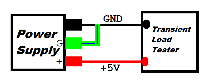

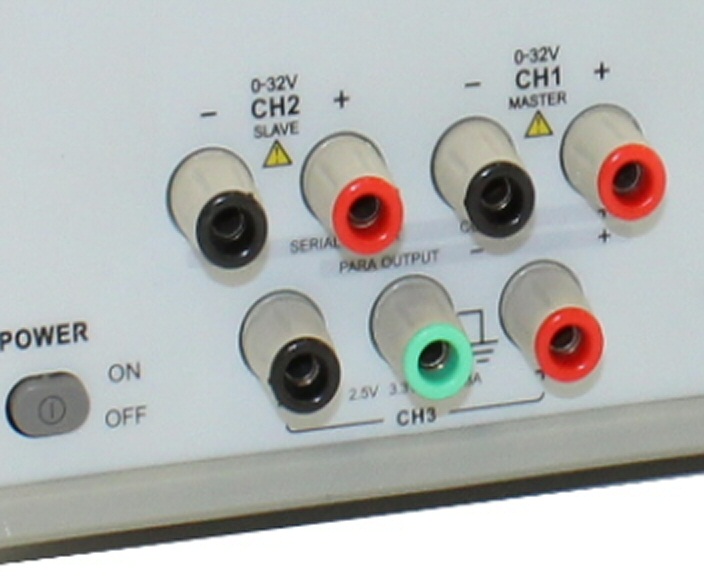

I am very happy with my PPS2320 power supply. Attachment 1 shows its front panel connectors. I will discuss the bottom set of connectors, "channel 3".
Thanks to its multi-secondary power transformer, this is a Fully Floating power supply. If you set it to "3.6 volts" then the red terminal will be 3.6 volts more positive than the black terminal. Neither red nor black are connected to ground (or "earth", or "common") -- they are Fully Floating. The user (that's me) gets to make that connection however he wishes. If I ground the black terminal, then red is +3.6V and black is GND. If I ground the red terminal, then red is GND and black is -3.6V. Cute! It's either a positive power supply or a negative power supply, depending on how I hook it up.
They also provide a green connector on the front panel, which is connected to Chassis Ground (the third wire in the AC mains cable), in case you might wish to use it. If you do then of course it is no longer Fully Floating, but is instead referenced to Chassis Ground.
Attachment 2 shows how I connect this power supply to provide +5V and GND. Attachment 3 shows how I connect this power supply to provide GND and -5V.
Everything works just dandy in these connection; fuses don't blow, components don't overheat, connectors don't melt, and the safety GFCI (called "RCD" in UK and Ozzie) doesn't activate. But is this a lucky accident? Is it truly dangerous, and will soon explode in a bomb burst of molten copper (some of it piercing my eyeballs and genitals) at any second?
