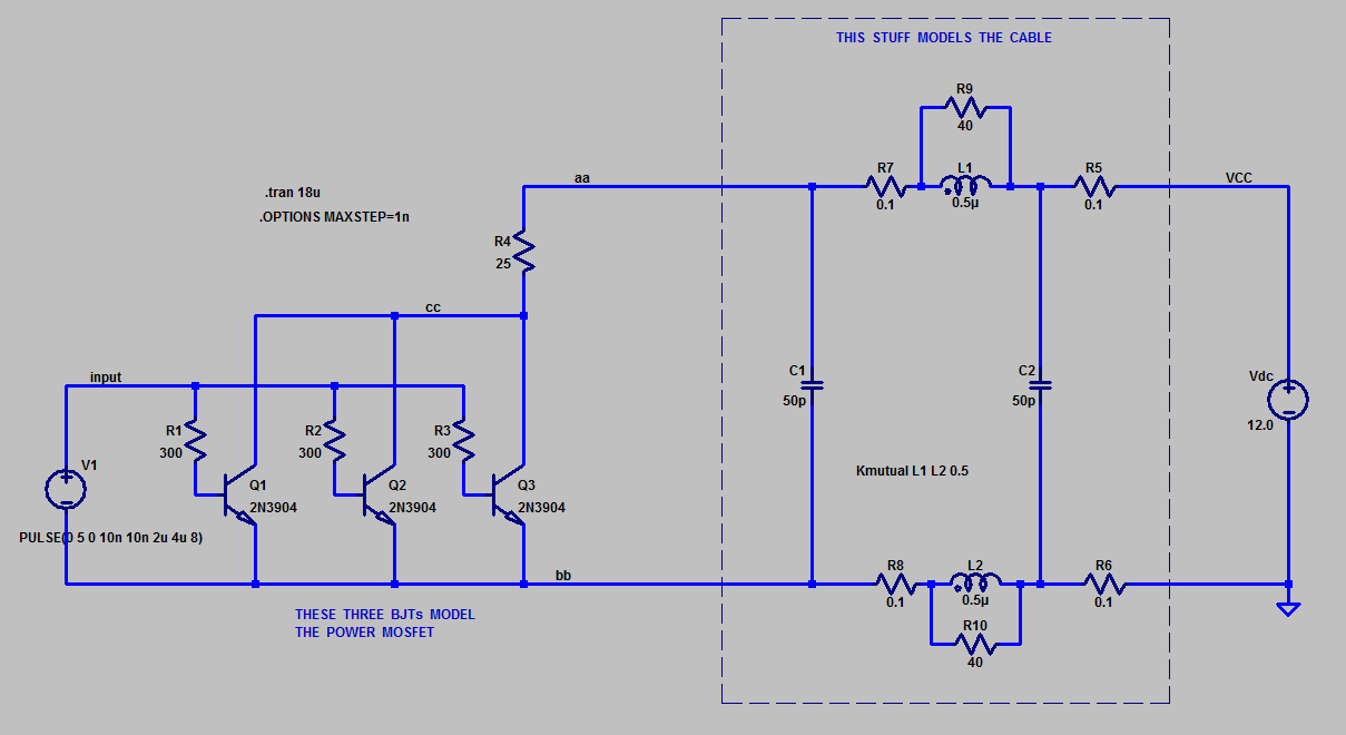

Here's a quick slapdash simulation model of the crappy 1 meter zipcord cables shown in post#14. I can't justify any of the values except to say they don't look completely crazy to me, and the resulting simulation waveforms have the same general shape as the scope photo. Don't bet your life or your money on its predictive accuracy!

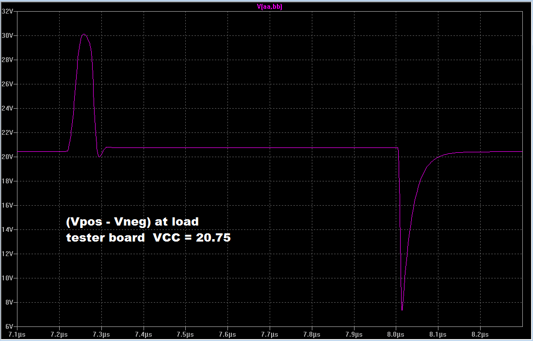

When the supply voltage cranks up to 20.75 volts, the cable-induced overshoot goes above 30V, too high for this MOSFET. So I would suggest taking active measures to prevent big overshoots from happening.

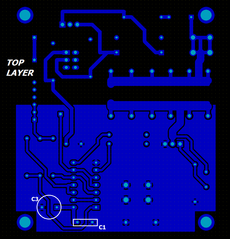

I've been looking at the board, and I have a question.
I notice 2 ground planes (1 on each side) connected in multiple places. The ground plane on the bottom covers the entire board. But the top ground plane covers only a bit more than half the board. It doesn't cover the area around the regulator positive input, the load resistors, and the 7805 & associated components. It seems like the parts uncovered by the top ground plane are all parts that might be effected by noise on the output of the power supply under test.
My question is: Why this partial coverage with the top ground plane, but not the bottom ground plane?

A favorite detective novel of mine includes a scene where the detective agrees to work on a vexing problem for a group of eight lawyers, all of them Harvard graduates. The detective presents his specification of work and schedule of payments (which are punishingly high) in the form of an employment contract. This drives the lawyers insane because they are not accustomed to getting screwed by a legal contract. Finally in desperation they agree to the enormous fees and all other demeaning aspects of the contract but they insist that the detective remove the provision that they shall be be liable for the full amount "jointly and severally".Why this partial coverage with the top ground plane, but not the bottom ground plane?
Our detective protagonist blandly replies, "Of course. I only put that in so that you gentlemen would have something to take out."
Similarly on this PCB, I put in a huge visual distraction (partial plane) so that viewers would have something to complain about.
In my opinion this board works just fine as-is, and I am using it for its intended purposes myself, with great success. However if anyone wants to design a new PCB layout that has a full ground plane on the top layer, I offer my best wishes and my prediction that you will probably succeed in the endeavor. I would add a gentle reminder that if you wish, you can pay an extra $1.60 per board and have both layers made with 70 micron thick copper instead of the standard 35 microns. You can cut all resistances in half merely by writing a slightly larger check. In my opinion the boards work fine with 35mm copper, but readers should be aware they have options. "If some is good then more is better" is a commonly heard recommendation here on DIYA. In this case the price of "more" appears small.

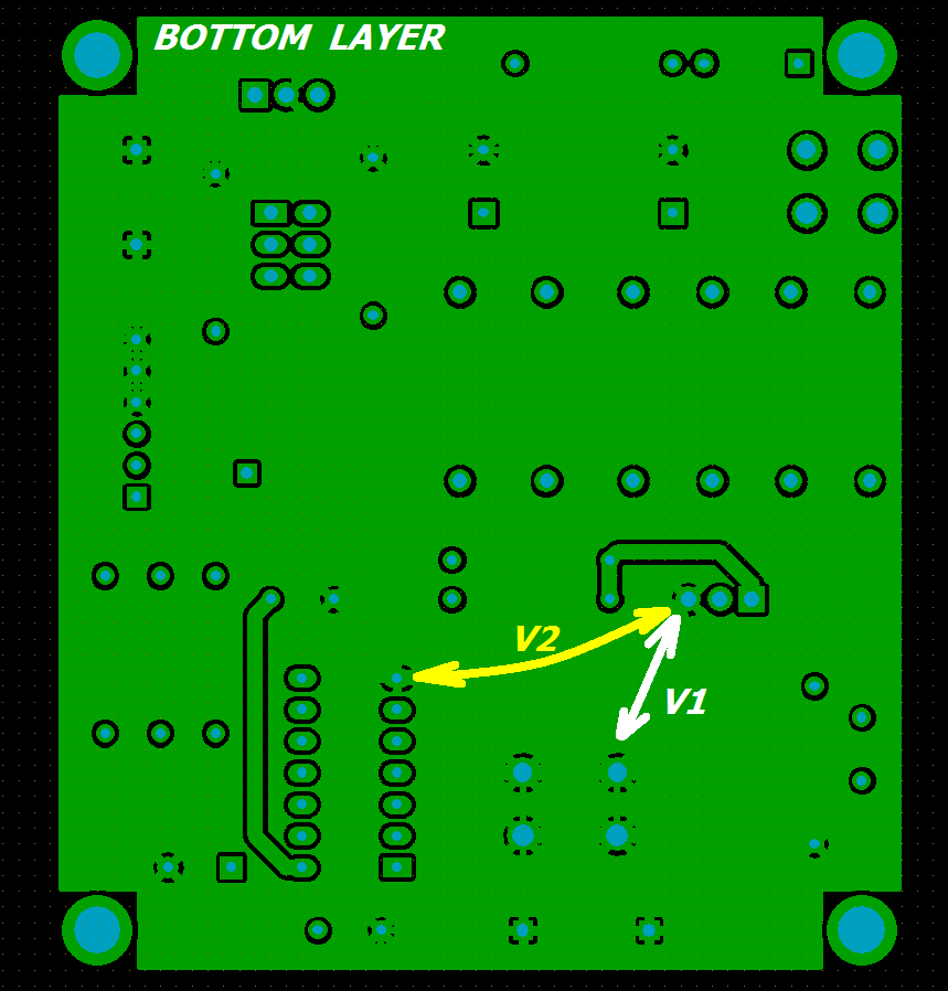

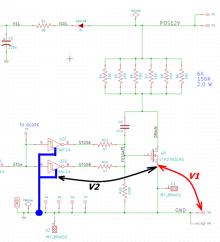

The main goal of this PCB layout is to minimize the voltages V1 and V2 shown on the attached schematic. I wanted very low resistance and very low inductance in these two layout paths. These are indicated on the Gerber plot images below. In my opinion, V1 and V2 are indeed minimized.
The plots also show the power supply bypass capacitors for the CMOS hex inverter IC -- named C1 and C3. The inverter has VCC on pin#14 (lower left of the DIP) and GND on pin#7 (upper right of the DIP). You can see that the traces from C1+C3 to ICpin14 are very short, and the traces from C1+C3 to ICpin7 are as short as possible since they are on the groundplane.
Me, I'm satisfied with it. Anyone who isn't, has my permission and blessing to make whatever improvements they wish.

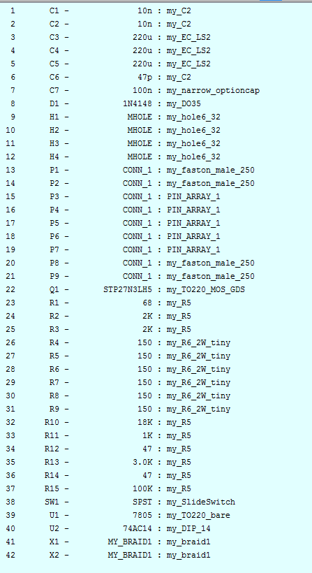

Maybe this will help. It's the KiCad list of footprints. The names are meaningful to me but perhaps not to anyone else, so here is an explanationI made a minimal BOM for schematic Rev.B for normal 12v 500mA operation:
- C2 . . . . . . . . . . capacitor with 0.2 inch (5 mm) lead spacing
- EC_LS2 . . . . . . . 10 mm diameter electrolytic capacitor with 0.2 inch (5 mm) lead spacing
- narrow_optioncap Socket for capacitor having 6 pins at 0.1 inch spacing
- PIN_ARRAY_1 . . . A pin to attach a scope probe or crocodile clip
- R5 . . . . . . . . . . . thru hole resistor whose drill holes are spaced 0.5 inches (12.5 mm) apart
- R6_2W_tiny . . . . . the smallest 2 watt metal film resistor DigiKey sells (0.6" lead spacing)

Could you give us some information on the C6 Miller Effect capacitor. I spent a couple of hours searching for an explanation and how to calculate it, but i only found site after site talking about Miller capacitance and amplifiers. I could not find anything on switches.
SGK good link, and a surprise. The C6 miller capacitor actually slows down the switching. I thought it was put in there to speed up the switching. That for a load bank you wanted a fast straight pulse.
My next guess is that the slowdown lessens the inductive effect of the wires connecting the load bank to the power supply.
The PCB layout includes C6 between MOSFET gate and drain, because I wanted to have the option to play with different capacitance values there. Zero pF of extra capacitance is of course one option: merely omit C6 entirely.
But I got lucky; the physical PCB matched the SPICE simulations pretty closely, and the match got even better when I reduced the series resistors R12+R14 from 47R to 22R. So I haven't felt the need to perform further fine-tuning by adjusting the value of C6. 47pF gives what I want.
Curious readers can explore these kinds of ideas by experimenting, either with a physical board, or with an LTSPICE simulation. You can model a 74AC14 logic gate as an ideal voltage source, whose output series resistance is ~20 ohms. You can model the goofy MOSFET from ST Microelectronics, by one of the LTSPICE presupplied MOSFETS whose GateCharge is <= 5 nanocoulombs, and whose Ron is low. Luckily LTSPICE lets you click on column headers in the "Pick a MOSFET" dialog box, and sort by parameter value. You might decide that Si7218DN or IPP147N03L or BUK9K5260E could serve as possible "models" of the STP27N3LH5 . Maybe you actually want to simulate with all three, just to give yourself extra peace of mind, that you're not totally dependent on weird accidental quirks of one oddball MOSFET.

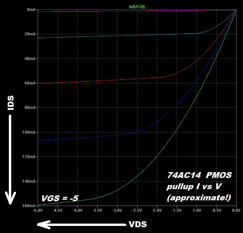

It may help to remember that we deliberately chose the world's best thru-hole MOSFET with the world's lowest (RdsON * Qgate) figure of merit. So this little baby has got the lowest available input capacitance, while providing the low Ron that we demand.
The capacitance itself is wildly nonlinear but we are brave people and for the purposes of estimating power and heat, we will use a simple linear approximation: CMOSFET =~approx~= GateCharge / SupplyVoltage. Thus CMOSFET =~approx~= 5E-9 / 5. Thus CMOSFET is approximately 1000 picofarads for the purposes of estimating power and heat.
Do integrated circuit I/O pins burn out when you ask them to drive 1000pF load capacitances? No they do not. Especially when you don't switch the big capacitances very often, as in this little transient load tester board: only 9000 times per second. For comparison purposes, fast digital circuits switch their I/O pins hundreds of millions of times per second (with ~ 50 pF load capacitances).
I've attached the I-V curve of an IC transistor, similar to the transistor used in the 74AC14 gate. It's a Pchannel MOSFET, used to pull up the I/O pin of a chip similar to the 74AC14. As you can see, the max current this transistor is able to pump out, is 160 mA. And it only does that if you short the output to ground so that VDS=-5.0 volts. When the output pin has risen up to within 0.5 volts of the supply (where VDS = -0.5 volts), transistor current is "only" 40 mA.
When I connect this transistor to a 22 ohm series resistor and then to the gate of our power MOSFET, I get the time domain waveforms shown in the second figure.
The green waveform is the MOSFET gate; it has that little Miller Effect Pedestal that we see in scope photos of real circuits on real PCBoards. The blue waveform is the MOSFET drain, which falls from the external power supply voltage (12V) to ground. I plotted current in red, and power dissipation (voltage * current) in blue. Neither the current nor the power, jump to ridiculously large "instant burnout" values.
Now we are able to give the final answer: No, this MOSFET's gate capacitance is so small, that two 74AC14 logic gates working in parallel can drive it easily. There's no danger of overcurrent or overheating.
