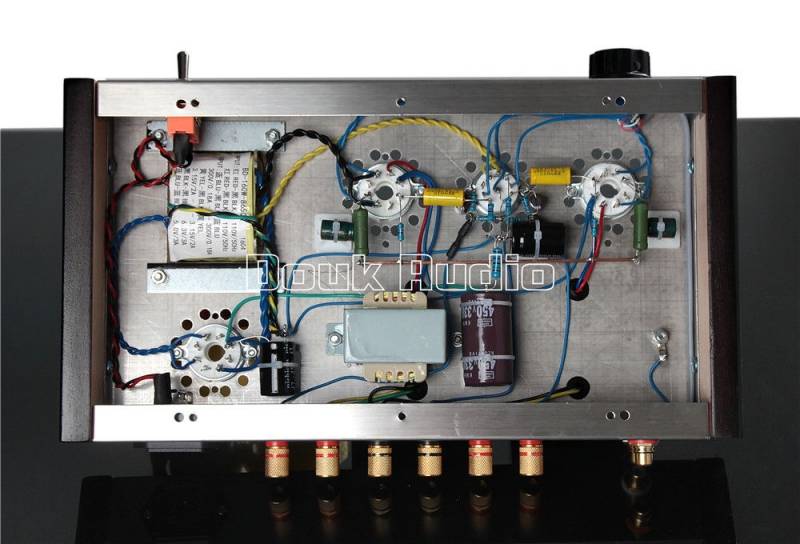

First thing to research is pin orientation on the tube mounts relative to the case😕

Tube pinouts are always from the bottom of the tube, as far as I know.First thing to research is pin orientation on the tube mounts relative to the case😕

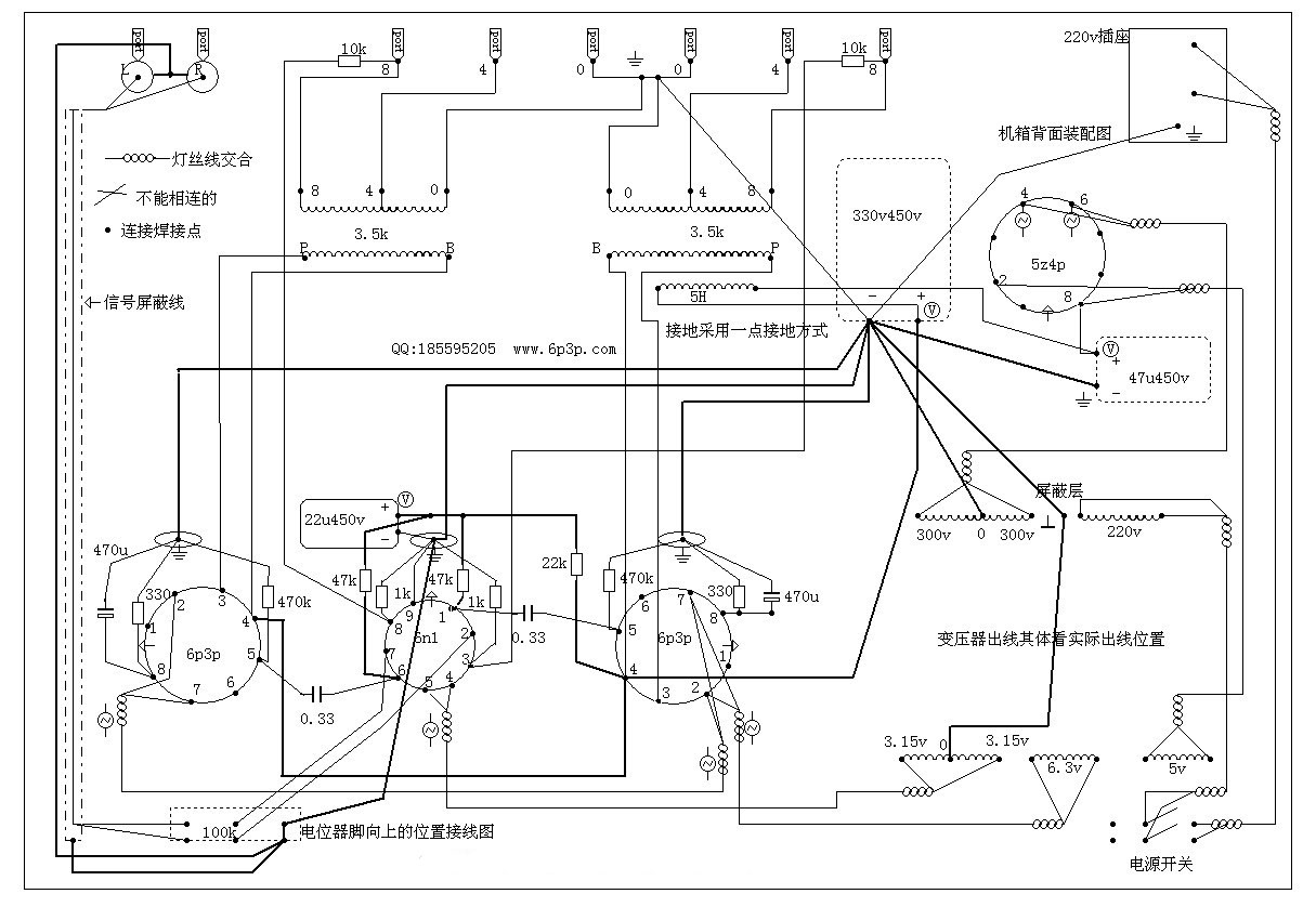

Folks, from the mod schematic back in post #3, there are 100 ohm added to the output heater lines; what wattage resistors? Are these wirewound or carbon?
Lets say AC is 7V. Current is = 7V/100R = 70ma P dissipated =I2 * R = 1/2 W. I would use 2W, Carbon/Metal film resistor.

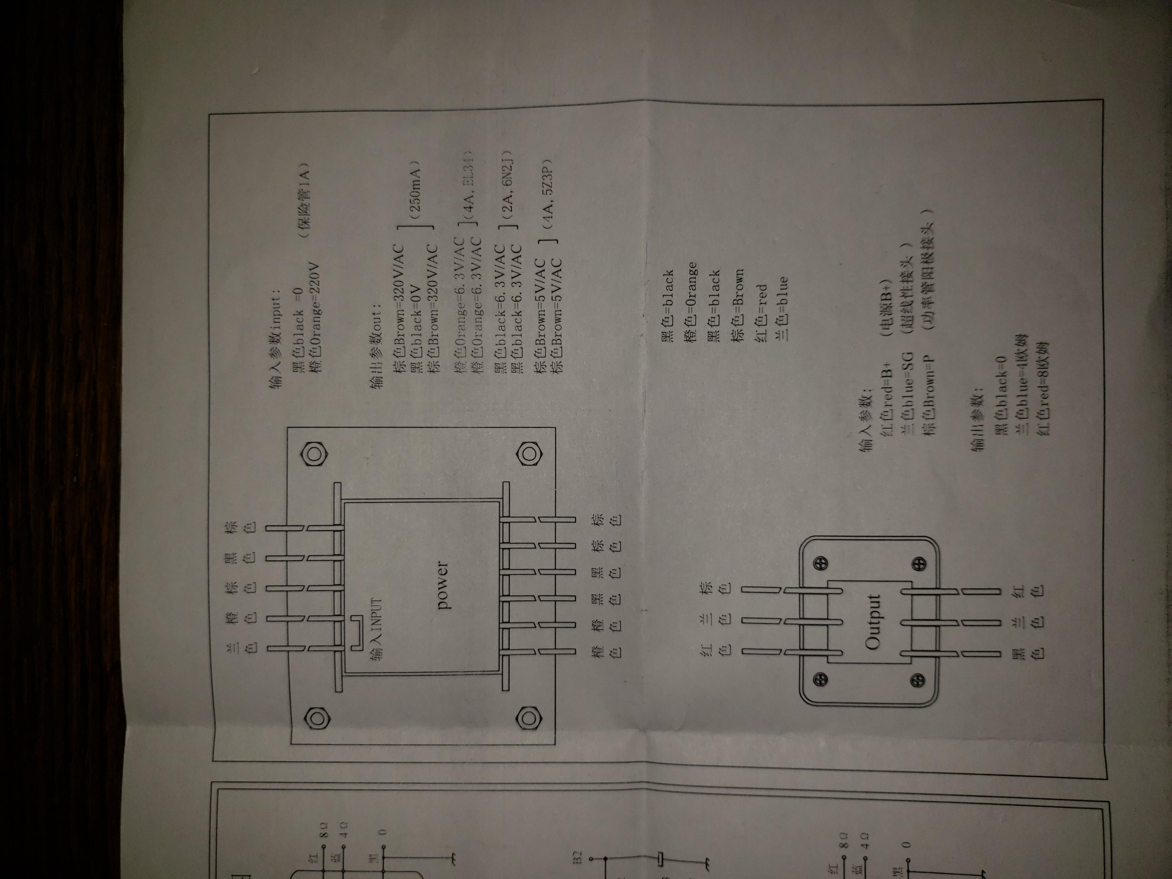

Yes, for 220-240V in the outlet. The switch in the kit and on the picture is different from what was drawn, it is single pole.

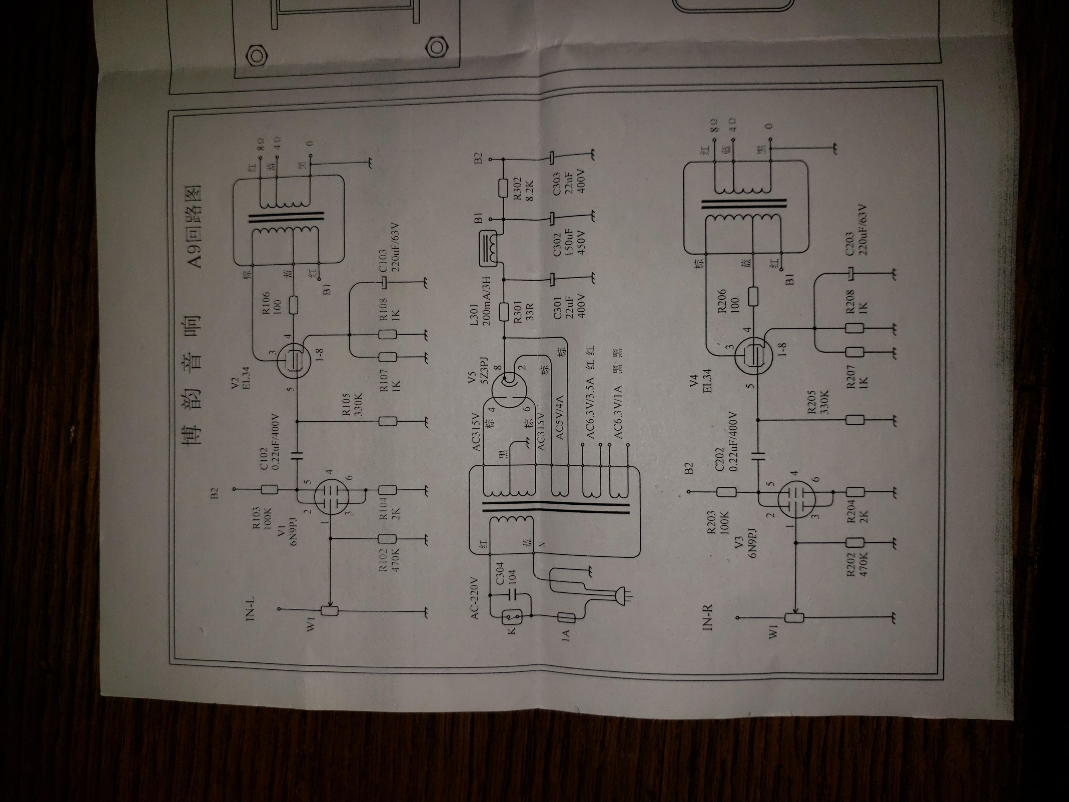

DonQ,
Just a quick look at Post #3 schematic, and your wiring diagram in post # 70 are not the same.
There are some important dissimilarities.
One of the differences is in the negative feedback circuit and parts.
Perhaps the output transformers are different, and require different negative feedback circuit and parts values to keep the amp stable.

navydiver,
On your schematic in post # 64, do not forget that the input tube pin 4 is left unconnected (not good).
How about a couple of 100 Ohm grid stopper resistors, one on pin 1, and one on pin 4 (connect them right at the tube socket tabs. Then connect the other ends of the 100 Ohm grid stoppers to the 470k and wiper of the volume control.

Yes...I have Googled for this kit and have run across various versions with variations, one didnt even have the feedback at all...my schematic has a 2K, another layout had a 10K...
Some versions move the supply caps on either side of the choke...
Ergo my question on who actually has one running, LOL.

edit: I'm GUESSING this is a 120 volt line transformer; but prospective purchasers might need to be prepared to deal with either a 120 or 230 v xfmr ( I am ) ...
