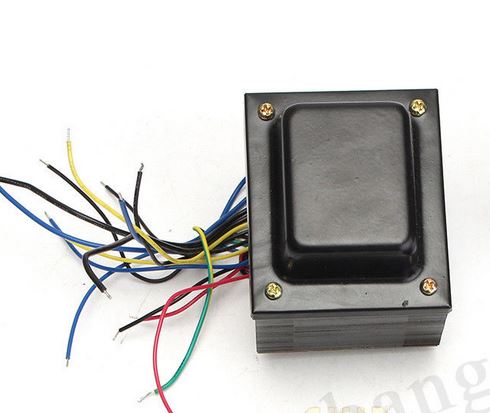

The power transformer runs a little hotter than I would like. By my Pass finger thermometer, I would guess around 160 degF.
Insulate bolts, as I mentioned before, and the transformer will be decent.

Newbie here: could you please quick explain why insulating bolts will lower heat and/or make decent? Seeking to understand.
Bolts form a turn around magnetic field that is shorted. Magnetic field causes in this turn a voltage, loaded on it's DC resistance. Electromagnetic energy gets turned into heat.
I had to noodle on it a while as the bolts are not in the winding window, I questioned the shorted turn theory. The bolts are NOT outside the laminations. They are half way through the flux field in the laminations, so they do make sort of a 1/2 shorted turn (but 2 of them).
Another solution would be lop the corners off of the transformer core, but that would likely saturate the iron at the truncated corners, and be difficult to do neatly.
I need to make a trek to the local electronic surplus store to get some insulating fiber washers. I think the easier way to insulate will be heat shrink the shank of the screws (hoping it still fits the hole) and using a fiber washer on the top cover for all but one bolt. I'll leave one uninsulated to ground the cover bell.

1. You have to insulate bolts in the transformer to remove the shorted turn that they cause. Remove them, add plastic T-nuts, and heatshrink tubing on them, then put them back.

What they're saying is that the bolts that hold it together need to be insulated from the lamination, to reduce eddy currents, which could cause a heat buildupI don't understand how this power transformer is different than all the other (laydown) power transformers I've seen over the years, and they were all fastened with steel bolts, to the chassis.
