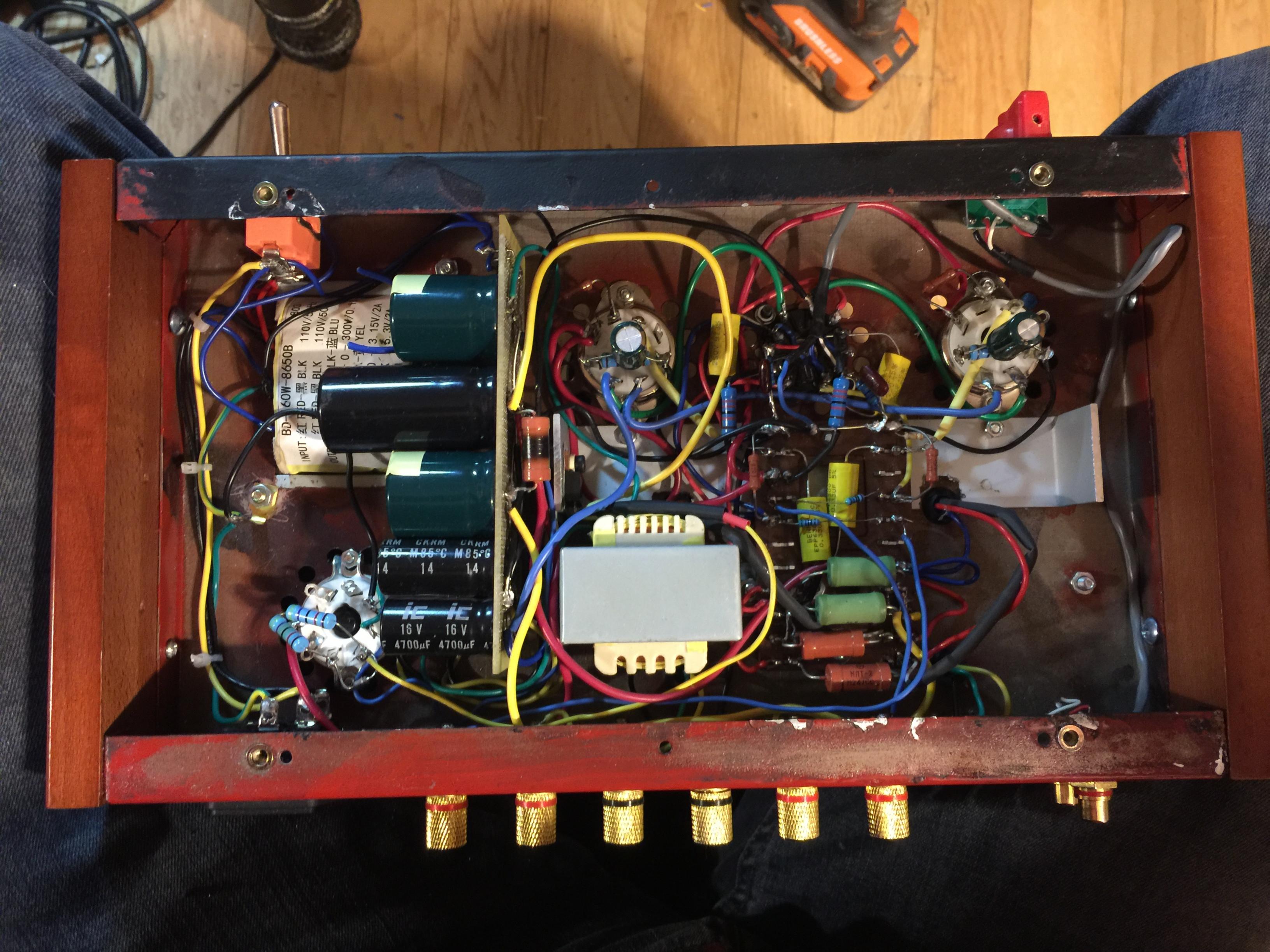

Hi all,
just found this thread. Caught an almost similar kit after spending useless time on the internet (always dangerous) and built it as a sideway-project to my EL84 BH.
Originally it should come with Chinese 6L6W-GB, 6H9P and 5U4S. As I'm a fan of Russian tubes, I simultaneously ordered a set of Reflektor 6P3S-E and the others. Big surprise, as the kit already came with Russian 6H9P / 5U4S, but Shuguang 6L6W-GB.
Didn't find any big issues in the schematic and for that just put it together. Some minor tweaks were a 3mm copper wire working as ground (see pictures), better caps, heater symm. and an additional load cap. Ground has been connected to earth via a 100 R and a 100nF Y cap. It was planned to give the amp to a colleague afterwards, so I put in 2 additional RCA with manual source selector and a motorized ALPS-Poti.
Sound was quite OK with original tubes and schematic. I played a little bit around with FB (now 15k) and caps in the cathode circuit, but the biggest improvement by way was to put in the Russian Ladies.
Do not have the measurements at hand, but roughly 7 W @ 8 Ohms, no hum at all and really "fluid sounding" - do not find a better word. The Odeons with 93 dB SPL really get kicked by this little buddy. Temperature of the iron in the back is still inside the limits. After 1 hour approx 42°C (IR).
To cut it short: Worth, to put it together and let it sing, especially for the price. There are many options to make it better afterwards, and as one can see, the experts here will always find a way to push it even higher and higher 🙂.
BTW: No, my colleague still has to wait. This little guy will stay for a while 😀.

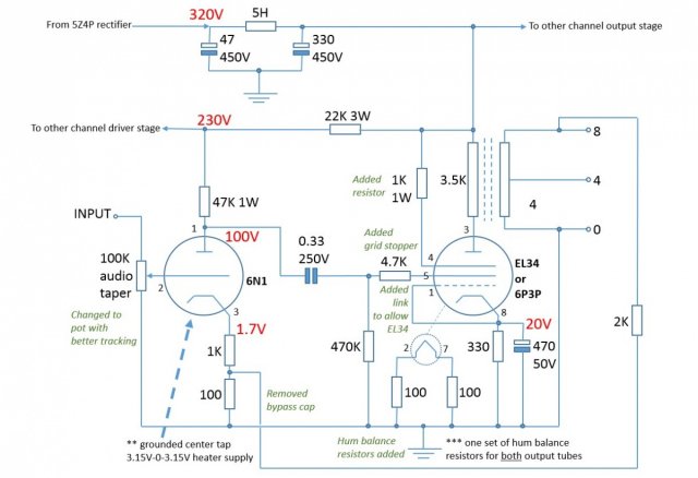

Folks, my rectifier tube was to be 5z4p from kit, but looks like 5U4C on the tube...any concerns?
Chinese 5Z4P is a copy of Soviet 5Ц4С tube, no worries here.
These were from mine...seems they juggle the values a little on feedback and other bits? Since I'm on 120V, voltages seemed a little higher off the bare transformer.
330uF cap only measured 252uF...may seek replacement.
(Thanks for the rectifier touchback.)
Honestly I would not use any electrolytic caps that come with these kits, replace them with name brand stuff, I usually try to use 105C 5000HR+ stuff in most build like this.

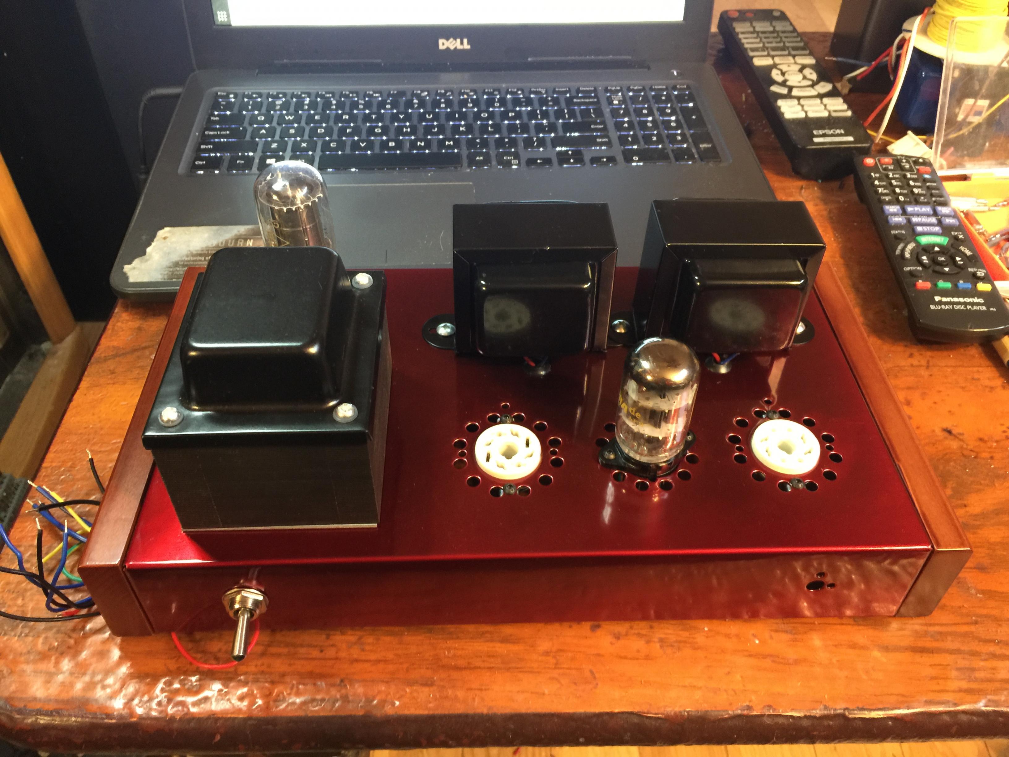

So I ordered one last week. For about $115 shipped, it's not a bad deal. I'll be building it as a triode output with no global feedback and re-working most everything else as well. I'll document it in another thread, but for now, my initial impressions:
1. It's small. Real small. The length/width is about that of a sheet of paper.
2. The iron is close together. Like sharing the same mounting screws close together. I'm a bit worried about magnetic coupling, but we'll see.
3. The power transformer seems to be big enough, from initial mass estimates.
4. The sheetmetal is SHARP. I sliced open my thumb within the first minute of unboxing. Five minutes with a bastard file and some sandpaper and now it's only mildly dangerous.
5. The packaging was excellent for the price point. No bespoke foam liners (naturally), but lots of foam and thick cardboard around everything.
6. The components look to be quite value oriented. Most everything but the iron, chassis, hardware, sockets, tubes, and maybe the power switch will go into the "use, but not on something critical" spare parts bin. All the components I use will be from my massive parts stash.
7. The output transformers are small for SE. Maybe half the size of my Edcor 25w P-P transformers. So maybe 5w max in SE?
