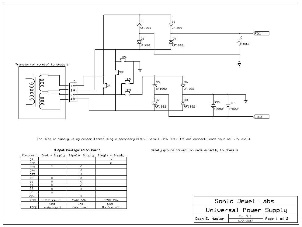

Now here's the first page of the schematic. Again, this was done in ExpressPCB's software, so it's not in an easily transportable format. I will share it with anyone who is interested. Don't worry about the official looking name on the title block - there is no commercial interest. Of course, trying to get the image down to the legal limit pretty much destroys the legibility, so...

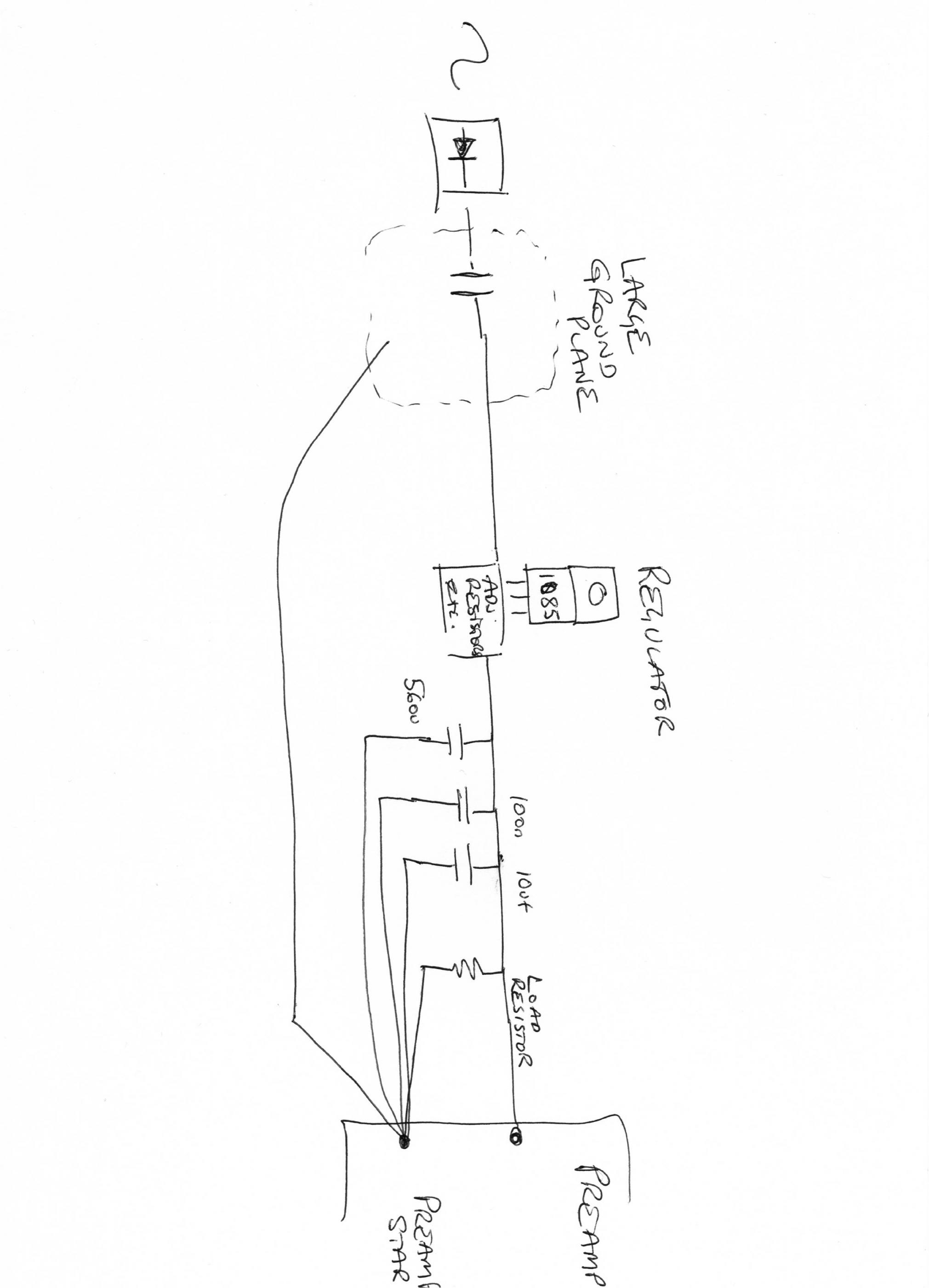

Ground planes and such
I'm having difficulty understanding the layout for the 1085 etc.
The data sheets show a 'star' ground configuration with the main star ground point being at the load.
Does this mean that the main input ground goes onto a large plane and the load ground goes as close to the load as possible with a return ground track from there?
I have seen many LM317/337 and 1085 layouts with EVERYTHING on the large ground plane.
I've attached a crude drawing drawn by my 3 year old daughter. Please excuse her drawing abilities...she has no idea 🙂
Rob

Without taking a side in a debate ground plane vs. star ground, I in general recommend 100 - 220 nF decoupling as closeas possible to input and output pins of linear regulators. That is, one capacitor between the ICs input pin and ground pin, and one between output pin and ground pin.
It is wise to prepare the PCB for such capacitors, and one can always leave them out of the circuit.
But, as always, read the datasheet and the application notes.
BTW it seems you have a series capacitor between the rectifier and the regulator. Probably this is intended between rectifier out and ground.

Hi RK
That is not a series cap AT ALL but a naff symbol to show that there is a capacitor bank there in that box.
It was more about the use of a ground plane vs star as I would like to build supply as the one in this thread.

Rob,
Proper PCB layout for Power Supplies and their regulators is critical to the performance of the regulated supply. Those who have built power supplies with just Big solid Ground Planes are just hoping that the Low impedance of the copper will sweep the problems under the rug. I routinely reduce hum and buzz and ripple from 317/1085 regulators from -50dBu or thereabouts to -85dbu or so -- mainly by fixing the layout problems on existing power supply PCBs.
There are heavy pulsing currents (Several Amps) that flow in a circle between power transfomer to rectifier to Main Filter capacitors and back to the transformer. It is critical to keep that path short and robust and in a small loop area to avoid inducing hum and buzz into other circuitry.
The Regulator's ground terminal (or in the case of the 317/1085 regulator the voltage set resistor's connection point to ground determines the reference point to which the regulator will try to regulate its output. If there are IR drops in that reference point due to heavy pulsing rectifier currents, then the output will simply follow. (Garbage in -- Garbage out).
It is important to think in terms of current paths when doing a layout for a power supply, because the currents cause voltage drops in the traces that translate to increased ripple in the regulator output.
You might want to get a consult on your layout, because if the layout is right, you will get great performance. If it is wrong, you never will.

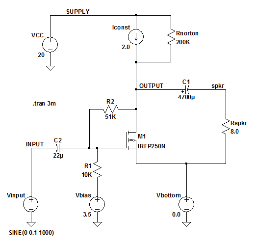

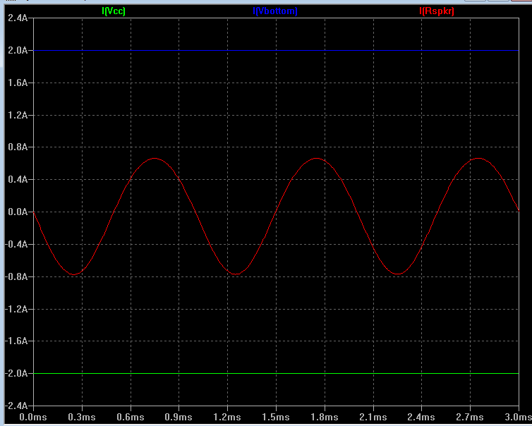

In the ClassA region the [current] loading [on the supply rails] is sinusoidal if the reproduced signal is sinusoidal.
Here's a ClassA amplifier, a MOSFET implementation of a "Single Ended Triode" design. It's delivering a 1 kHz sinusoidal current into the 8 ohm load; about 2/3rds of an ampere, peak to peak. That's about 1.75 watts RMS into the 8R load. "Firstwatt" territory.
I've plotted the current drawn from the top rail (green), the current in the 8R load (red), and the current drawn from the bottom rail (blue). Try not to be annoyed by the sign of LTSPICE's "reference current direction" for the voltage sources VCC and Vbottom 😡. The plot says: the current drawn from the supply rails is constant, i.e., non-sinusoidal.
Other forum participants may wish to try the same thing on pure ClassA push-pull circuits. You'll have some fun! For ClassA push-pull, is the supply current sinusoidal? constant? neither?

Tran,
you have chosen the one ClassA single ended topology where there is constant current.
You have placed the load parallel to the driving transistor.
If you move the load to parallel to the current source (or resistor for the resistor loaded) you will have the more common version adopted by most single ended builders.
Although most builders tend to use the upside down version, i.e. driving transistor connected to +ve supply rail and resistor or CCS to -ve rail. The load is then connected from output to -ve rail.
This is the non constant current ClassA in the supply rails.
Post the results so that all can see.
