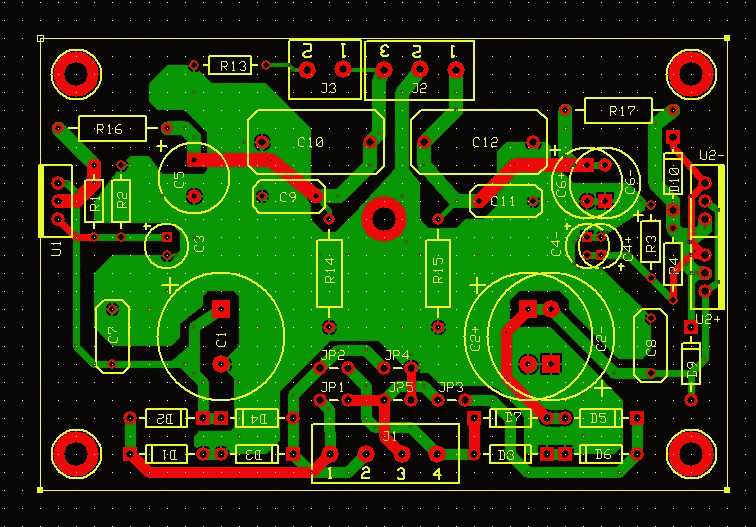

A Circuit Board Submission
I've been following this thread with great interest, since I was debating on using the 3 term regs or going all out with "super regs" for my preamp project. I decided to follow jbau's lead and try the 3 terminal reg approach first, due to its simplicity and cost. I'd been working on a power supply board design when this all started, so I've finished it up using the latest configuration as given in this thread. The layout was done in ExpressPCB, so I don't have gerber files available to share (sorry). The board is configured to allow for either bipolar supplies, dual positive supplies, or a single positive supply. Let me know what you think, but be kind - this is my first attempt.
