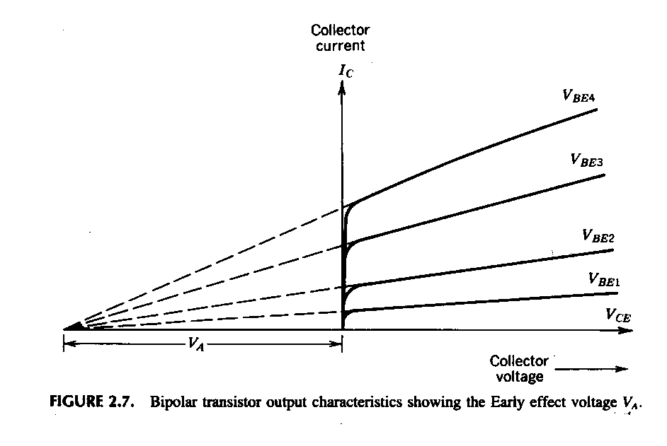

"but it's equivalent to a 2V anode voltage"
Ummh, yeah. The substrate diode ruins the voltage range. Maybe there are some RF Mosfets or something that don't have the substrate diode? I read where the analog mux chips just bias the substrate to some neg. voltage, below the signal operating range, to keep it from conducting.
There are some other options too. The Early effect in bipolars and channel modulation in Mosfets (smaller effect) puts some slope on the "pentode" curves.
One can use them as triode curves by putting a Mosfet cascode on top, load it's drain with a CCS, and then the drain/CCS point controls a source follower (with some voltage drop) back to the cascode gate. The source follower will then have Mu times gain versus the input (well, sorta for the bipolar case).

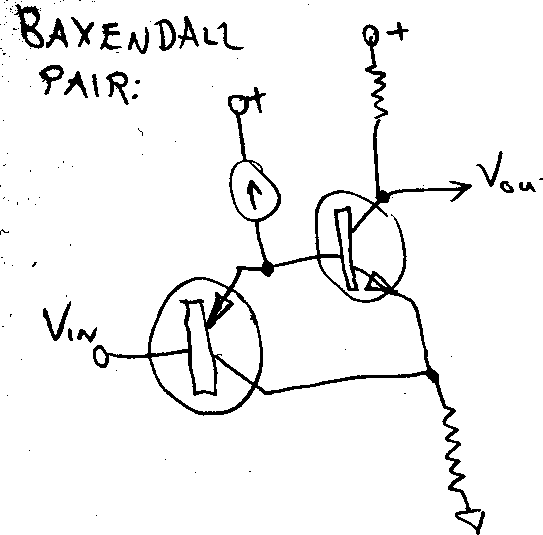

There is also the Baxandall/Hawksford (I think its called that, I would apply it here to the bipolar Darlington) cascode, where the top device base or gate is referenced back to an emitter degeneration resistor for the bottom device (100 Ohm typ.). That way top coll. - base capacitance and top base currents get subtracted out at the degen. resistor. (Gary Pimm made good use of this for his CCS designs to get very low cap. and very high Zout. )
That way a bipolar cascode could be used on top to minimize the voltage variation across the bottom bipolar coll. to base junction.
Also helps to get as much DC voltage across this junction as possible to minimize capacitance too.

There is also the Baxandall pair, instead of the Darlington. (attached) It has some advantages regarding capacitances.

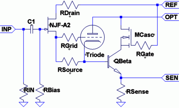

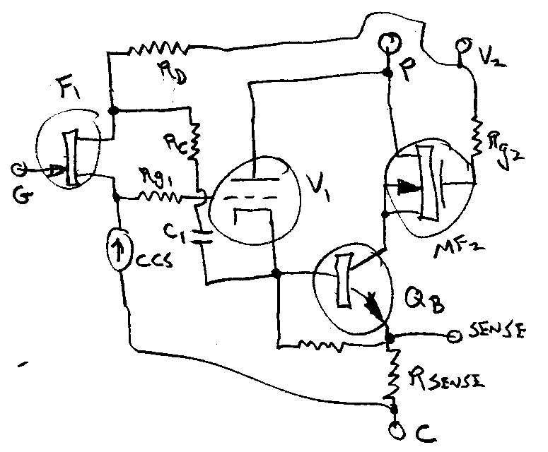

A2 vs RSense
I think I got a prob here. And this drawing is not a solution.
Want to keep A2 current out of the RSense (for Anti-Triode
not shown in this drawing). But this disguise for transition
to A2 drive current only makes it worse.
I would work on it some more before posting, but I am done
for tonight and wanted to show something for my efforts.
Even if its completely half baked...
RSource prollyshoulda gone to ground instead of QBeta...

Hi Ken,
I think I see what you are trying to do, compensate Qbeta base current for the G1 current in A2. Rsource does seem to be having two effects, changing the tube current down and changing the Qbeta current up. The net result probably not what you want though.
I think I would move Rsource to ground (maybe even replace with a CCS). Then an R-C from Rdrain/NJF to the cathode. This will reduce Qbeta base current with A2 current draw so as to compensate for the g2 current. It will also decrease the bias on the tube, causing it's current to increase. But the grid stopper causes grid bias to increase in A2 (causing tube current to decrease), so maybe one effect can be made to balance out the other effect on bias (becoming a nice fix for a common problem with A2 op.).
Just for fun, I scribbled up the same A2 mods on the Sziklai version, works out the same way I think. (Oops, left off a gate stopper on the Mosfet)

Hmm. I have driven my test amp into A2 and don't recall any strange behavior. I don't really have a good driver for A2 though; the 2nd generation amp I'm building now will have a circuit like the tubelab powerdrive and I'll be able to investigate the A2 effects further.
The particular currents and component values may be important in a grid current compensation scheme. Maybe the grid current can be subtracted out of the mirror current at the opamp input terminals.
NB some of the grid current will be due to the miller capacitance and goes into the anode circuit. Subtracting this from the cathode mirror current may introduce an error on fast-slewing signals like the 10KHz square wave test. I get up to 1-2 mA at max dv/dt in some cases.

re: Michael
"NB some of the grid current will be due to the miller capacitance and goes into the anode circuit. Subtracting this from the cathode mirror current may introduce an error on fast-slewing signals like the 10KHz square wave test. I get up to 1-2 mA at max dv/dt in some cases."
Hmmm, good point. I think maybe a small cap across the Fet drain resistor can compensate for this in the modified Ken's diagram. Will decrease the A2 current compensation with fast slew rate.
But then again, the A2 current onset is rapid too, so this fix would slow down the compensation for that. Need a more sophisticated comp. I guess. Need something like neutralization for the plate-grid capacitance, but I don't see any good inverted signal available here to do that. In the Sziklai case, maybe can get it from the Qb collector.

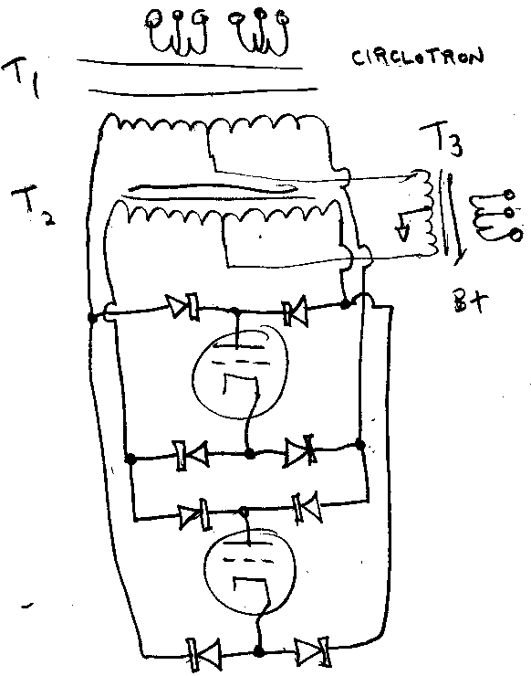

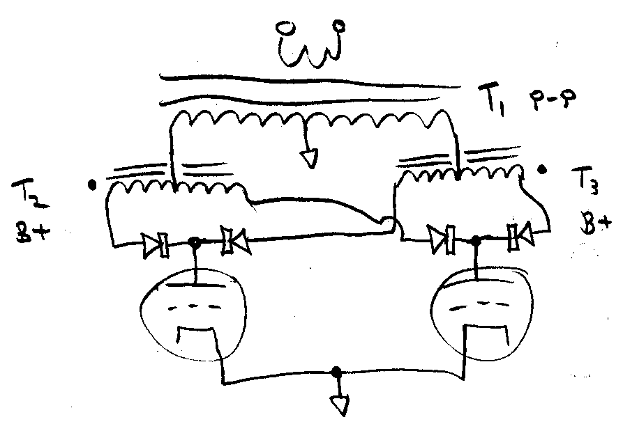

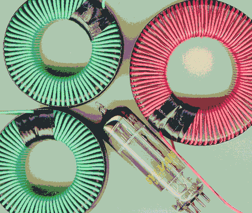

I finished up the latest toroid xfmrs for the Switchless Circlotron converter version. Using the same cores as before. All HV windings are single layer for low distributed capacitance. TFE #22 wire.
The two B+ xfmrs have 66 turns on the medium core, 36 mH, HF magnetization current is 2% of signal current, capable of up to 1160 V pk at 1200 Gauss at 125 KHz, self resonant at 167 KHz
The large core is for the Circlotron plate winding, has 88 turns, 68 mH, HF magnetization current is 1% of signal current, capable of up to 2700 V pk at 1200 Gauss at 125 KHz, self resonant at 107 KHz
I may go for a few less turns on the plate core next time to bring the self resonant freq. up to the 125 KHz range. I think having the self resonance (dist. cap. and primary L) at the switching frequency will mostly null out the magnetization current.
Now to get the controller wired up.
Don
Don
Hiding A2 grid current
By the time A2 starts, not all that significant by comaprison
to plate-cathode current. Am I worried about nothing?
My concern it might mess with DC offset in the Anti-Triode.
I might be multiplying this A2 error current many times....
Or I could be on about a problem that doesn't even exist,
I havn't had time to stew on the question and dream of
what happens when electrons start moving.
Clearly the PNP solution at the plate has no such problem,
its just that Korg patent. And I hate plagiarizing from other
peoples work when circumventing is so much more fun.
I wonder if the low voltage output > plate step-up could be
replaced by a simple diode (or synchronous) ladder and no
transformer at all? I don't wanna copy off Berning either, if
I can cook up a plausible way to avoid it.
I keep thinking bilateral FET opto-isolators might be helpful
somehow. Especially if there were such thing as a matched
pair of them... How to drive a synchronus ladder?
And baluns... True baluns (Transmission line transformers.)
Not really a magnetic transformer as such, merely a balanced
transmission line with a common mode choke... A few of them
tied together parallel on one end, and series on the other...
That might work, but Trasmission lines are limited to around
75~100ohms impedance apiece, or the spacing between the
bifilar or coaxial pair becomes absurd...
Is a balun still a balun if sum impedance of the transmission
line(s) do not (in parallel or series) match either end? Does
mismatch matter at all when the lines are likely far shorter
than a quarter wave at the switching frequency? Do I care
only about the common mode blocking impedance?

multiple cores
FYI, baluns are usually not wound all on the same core.
Or if more than one is wound through the same chunk
of core material, never on the same magnetic path.
Don't remember now the exact reason why... Or if it
only matters (separate cores) in certain circumstances.
If each transmission line blocks an equal share of the
same common mode signal, I don't see why it would
be a problem?
That would be a question for W2FMI.
be a problem?
Roswell Circlotron
After reading the latest TubeCad blog, where J.B. mentions that some think the Circlotron came from Roswell, I had some dreams about Roswell and the aliens were insistent on reconfiguring my Switchless Switchmode Circlotron! (maybe it had something to do with listening to that "1st Sound recording" Backwards! Hehe) So here is the Roswell Circlotron version (attached). 😀
The general rule uncovered here is that the B+ xfmr and the plate xfmr in any of the configuratins can be swapped. Giving 6 front-end versions total. So I'll have some more schemes to post. (The Roswell Circlo. is the swap of the U.C. Switched Circlo. in post 115.)
Don
Don
So, here is the backwards swap of the Switchless Switchmode Conv. front-end. (from post 83) Call it the Inverted Switchless Switchmode converter front-end, or ISSC front-end. T2 and T3 can be combined on one core.
I'm not going to bother posting the swapped version of the variable % CFB version in post 90, too complex to draw again. Just call T1 the B+ xfmr, and T2 the plate xfmr and you have it.
With this increased selection of front-end configurations, there are some useful optimizations for xfmr winding to reduce distributed capacitance. For example, the inverted SSC has only one P-P plate winding (versus two in the SSC), and this generally has twice the turns of the B+ windings, so this is a good choice here.
The Roswell Circ. version only uses one B+ xfmr and two plate windings (or xfmrs) (T1 and T2 can be combined on the same core). But the plate windings here are only half the usual P-P xfmr plate winding turns (like all Circlotrons), so this is a good choice here.
Don
Don
