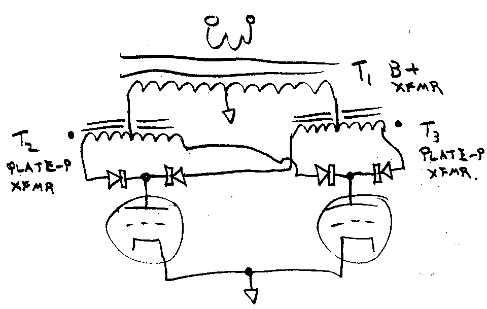

Just to be complete, here is the original Switchless Switchmode Conv. front end. SSC (T2 and T3 can be combined on one xfmr.)
I'm experimenting with different ferrite toroid winding configurations lately to reduce distributed capacitance. Latest is winding two wires bifilar in one layer, then removing one to leave an air gap between turns. Hoping to get the winding self resonance up to 250 KHz or better without having to reduce the turns too much.
It appears that some similar swapping around of xfmrs on the LV demod. side can give some new configurations there too. More work to do on that.

Oops, correction.
The B+ xfmrs generally have a similar number of turns on them as the full plate to plate center tapped xfmrs. So the main consideration between versions is the CM (common mode) capacitance issues.

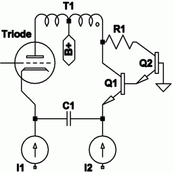

Re: Triode Clone
Looks like STC 😉
http://www.gem.hi-ho.ne.jp/katsu-san/audio/what_STC1_english.html
Kind regards,
Darius

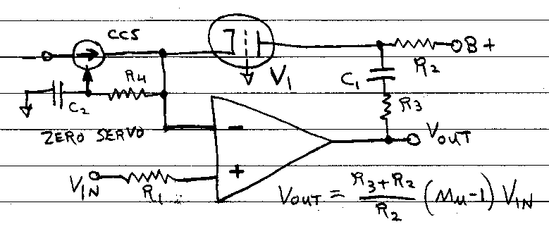

Originally #152 posted by smoking-amp
Then there is this:
(Uhh.., looks like I need to fix the zero servo though for the output instead. Arrgh.., and that Mu-1 obviously needs to be just Mu in the formula I think.)
Hmmm, wonder if there is an anti-triode variant.

"Looks like STC"
There is certainly a strong similarity in the circuit appearance between the two. And in the first post I made some years ago about the triode clone idea, I also linked to Kamijo's STC site.
But the two are actually quite distinct. The triode clone operates the triode at constant current (versus signal), giving a true gain of Mu. (notice the grounded grid versus the auto-biased grid between the two models) The STC operates with varying current (versus signal) thru the triode. Giving the same effect as a plate resistor loaded triode.
You will notice that the load lines given for the STC always slope rather than being flat. So, it depends on how you want to operate the tube. But the STC idea is certainly a valid tube emulation idea when combined with SS. Since it leaves some fraction of an actual load on the triode, some may find it to be a more "realistic" "triode" sound. (mostly 2nd harmonic dist. a little 3rd)
One problem I find with the STC, however, is that this "load" on the triode is NOT the actual load. Rather the triode current is programmed to increase with INPUT signal instead of the OUTPUT signal. (now for a fixed R load, the two will track, but not for a real reactive load) So this STC load is simulated in effect. This "simulated load" can be added to the triode clone circuit too, by just putting some resistance across the CCS to make current vary with input signal likewise. The triode emulations that Ken and Michael have done on the other hand, I believe, offer true loading by a fraction of the real load.
On the other hand, the triode clone has virtually ONLY 2nd harmonic distortion, which some may find more pleasing. One can also select how much 2nd harmonic by the setting of the CCS current and a fixed bias voltage on the "grounded" grid (to bring the cathode voltage on the inverting Op. amp. input back to zero volts). (the diagram really should show a bias pot. on the grid to select a voltage between ground and some minus voltage)
Don
Don

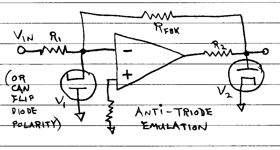

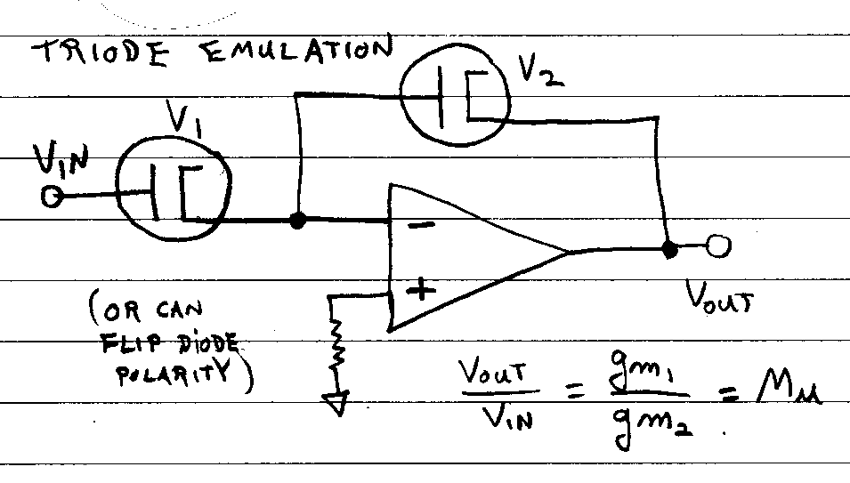

Some interesting extensions to the triode and anti-triode emulations in posts 150/151 would be to use a square law Mosfet (gate controlled by a resistive divider between source and drain) in place of ONE of the devices (or even both maybe too). That way we would be playing off 3/2 power (thermionic diode) versus 4/2 power (Mosfet) laws between the two non-linear devices, might give some interesting distortions.
Putting in the square law Mosfets for BOTH devices would nominally return the overall response to a linear one. But Mosfets change their characteristic power law versus current from a square law thru 3/2 law down to near linear law at high current. So by biasing one device at a different DC operating current than the other, some intentional mistracking could be generated. Maybe could be used as a low order corrector for the whole amplifier. Fun, fun...
Don
Don
Ohh..., for the Anti-Triode tube clone (variant of post 152) all you have to do is just put the input signal thru a resistor to the inverting input, instead of to the non-inverting input as shown. (anti-triode is just a true complement to triode) Should be a high value resistor if you want to maintain near constant current thru the triode however. Or, could put a feedback resistor in parallel with the triode to compensate for the inverting input signal current.
#154
Hi Don,
Thanks, you are right, I agree. 🙂
Kind regards,
Darius

Basakwerd Triodieodieodie Upsidasium
Lets clarify that the Anti-Triode has a triode curve flipped upside
down , and dynamically re-centered below 20KHz to balance out
in the current domain. Nothing about the curve's reference shape
in regard to plate or grid voltage is otherwise altered.
A gyrated triode, trading plate voltage for plate current. Flips the
curve along the diagonal, is something else completely different.
Not be confused or blindly substituted for the Anti-Triode.
I am not accusing anyone else of getting this wrong yet, though
I almost just did. An easy oops to make with these unintuitive
(for me) feedback circuits...
smoking-amp said:Ohh..., for the Anti-Triode tube clone (variant of post 152) all you have to do is just put the input signal thru a resistor to the inverting input, instead of to the non-inverting input as shown. (anti-triode is just a true complement to triode) Should be a high value resistor if you want to maintain near constant current thru the triode however. Or, could put a feedback resistor in parallel with the triode to compensate for the inverting input signal current.
Yet Another Anti-Triode
I have a feeling that Smoking may have suggested this before.
Funny thing, if you were to drive this from the other side, and
the triode were "good" enough to keep up. It would become
an Anti-Darlington...
To behave as an anti-device, the anti-side must not react to
input or B+ variations, only to current in the tail. It must also
exceed the performance envelope of the virtual device to be
emulated.
Clearly in case of a differential twin triodes, each side attempts
with only partial success to drive the other as an anti-triode.
The result is some blended curve inbetween. Neither end ever
entirely dominating the overall behavior...
Here the Anti-Triode is entirely dominated by the behavior of
the reference, it has no say of its own....
