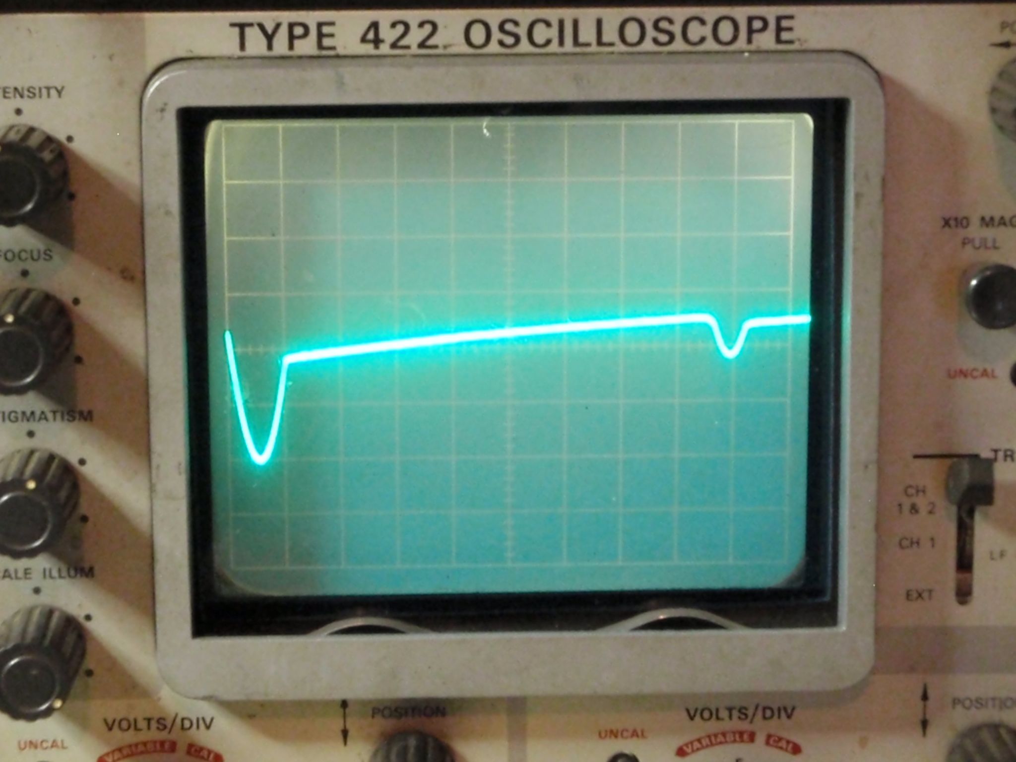

Here's what I did:
  • I used my Elenco XP-720 power supply for a test source. I set it up to put out 15 vdc into an 8 ohm load (big 100w resistor on a heat sink).
  • I connected the scope probe (set to 10x atten.) and ground to the + and common of the PS.
  • I set the scope coupling to AC. I set the AC gain to 10x.
  • With volts/div set to .1/div and time/div set to 1ms, I obtained the wave-form in the attached pic.
If I'm reading it correctly, the wave-form shows approx. an 800hz, 250mv ripple.
Did I do everything correctly?

Close. Your supply is rated for 1 amp up to 15 volts. Your 8 ohm resistor with 15 volts would be 15/8 or 1.875 amps, well above the rated current. I'm surprised it's doing as well as it is. This little 'pips' are the regulator 'dropping out' at a 120Hz rate (North America). I predict if you stay in the ratings of the supply you will find nothing (or next to nothing) ripple wise.
The Adcom supplies aren't regulated and just show as 120Hz sawtooth that gets larger with the load. With a 150 watt lamp on the 80V supply the ripple is 250mV P-P.
Hi Fred,
G² is spot on there. Now you know what a regulated power supply in crisis looks like! 🙂
Your scope setup is correct, always begin with a high volts / div setting and work down. Each and every time! Always remember that the setting will refer to volts per division and <unit time> per division, or square as you see the screen.

Thanks guys. That was educational! I hadn't seen any ripple at 5 volts fixed (as G2 predicted) so I switched the leads on the PS to 15 volts without remembering to redo the math for the load. So that's a number of useful lessons learned!

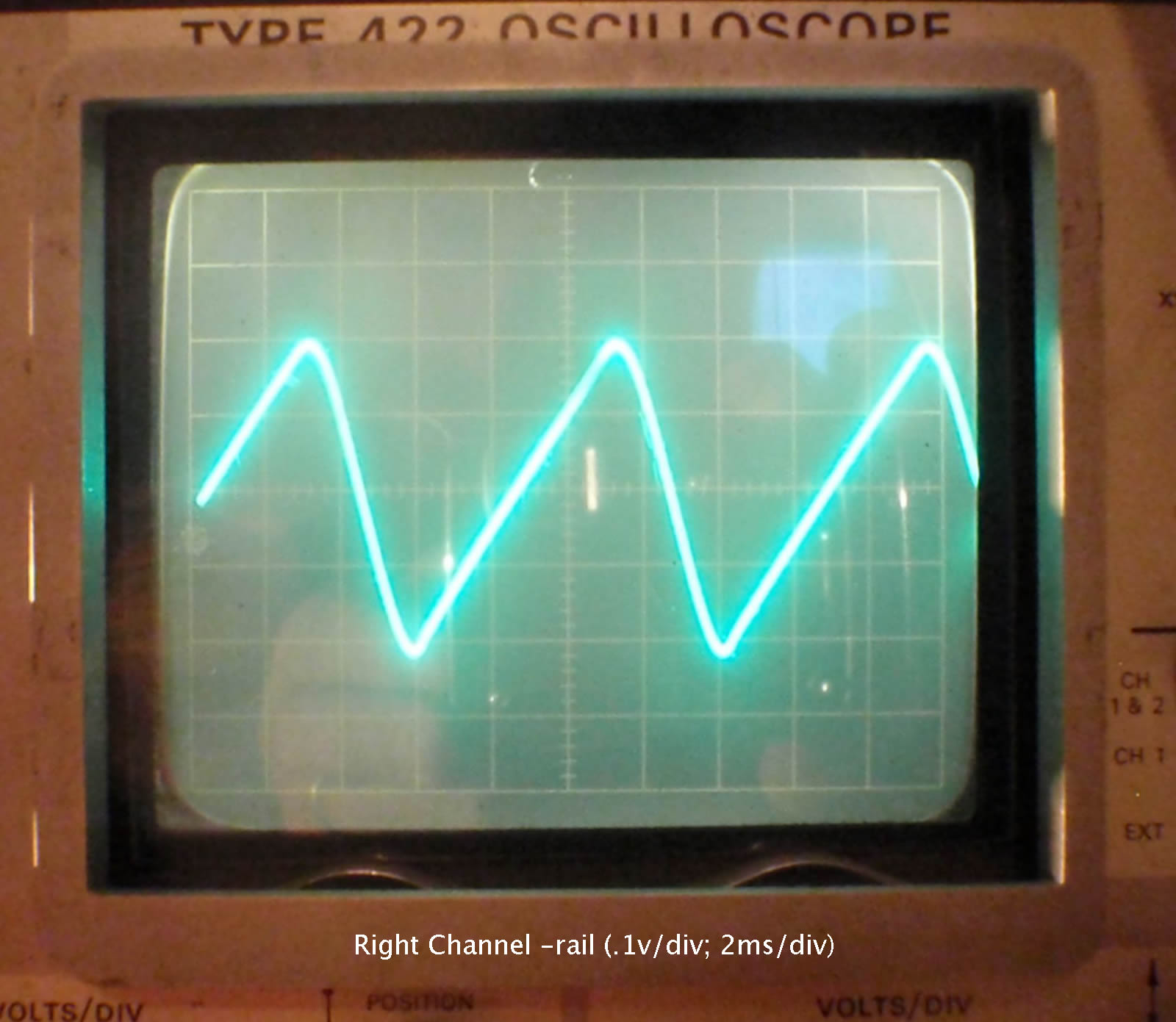

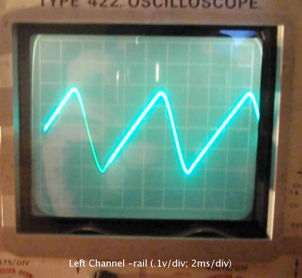

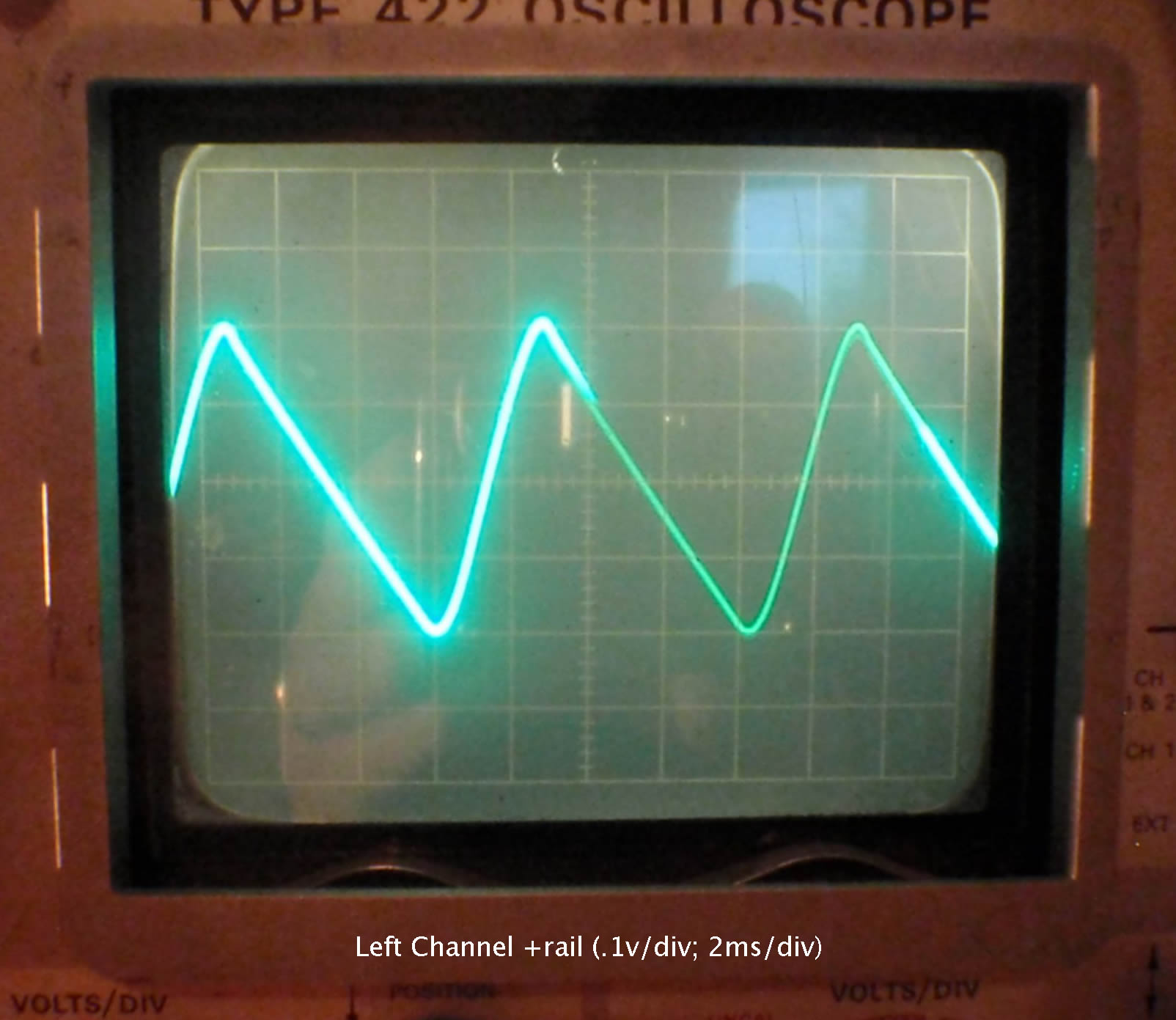

Back on track. Finally able to do the PS testing. Here's how I set up the test:
1. Disconnected the output section by pulling the fuses
2. Connected my scope and a 150 watt bulb (as a load) across the + and - terminals of each power supply cap. The scope was set to AC coupling and ranged to .1v/div and 2ms/div. The probe was set to 10x and the 10x gain on the scope was on.
3. Ran up the power to full voltage.
The result was the attached traces. Also, with the DVM each supply measured about -/+76vdc under load and 84vdc without a load. The amp pulled about .5 amp under the load, btw.
I think I'm seeing something similar to what G2 described in #152, except this is a 125hz, 400mv p-p ripple. Am I reading the trace wrong or is my ripple nearly twice his?
In any case, I think I can safely conclude my PS is okay. Do you guys agree?
What's my next move?
