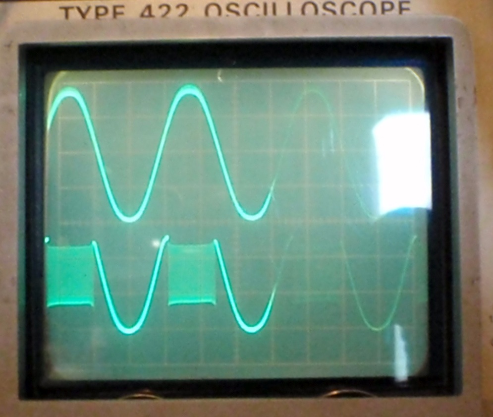

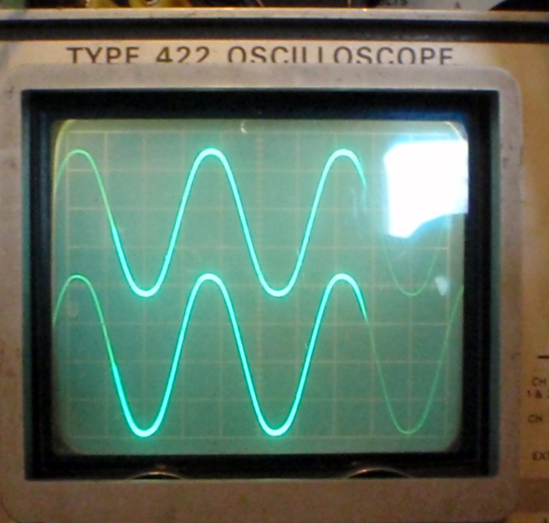

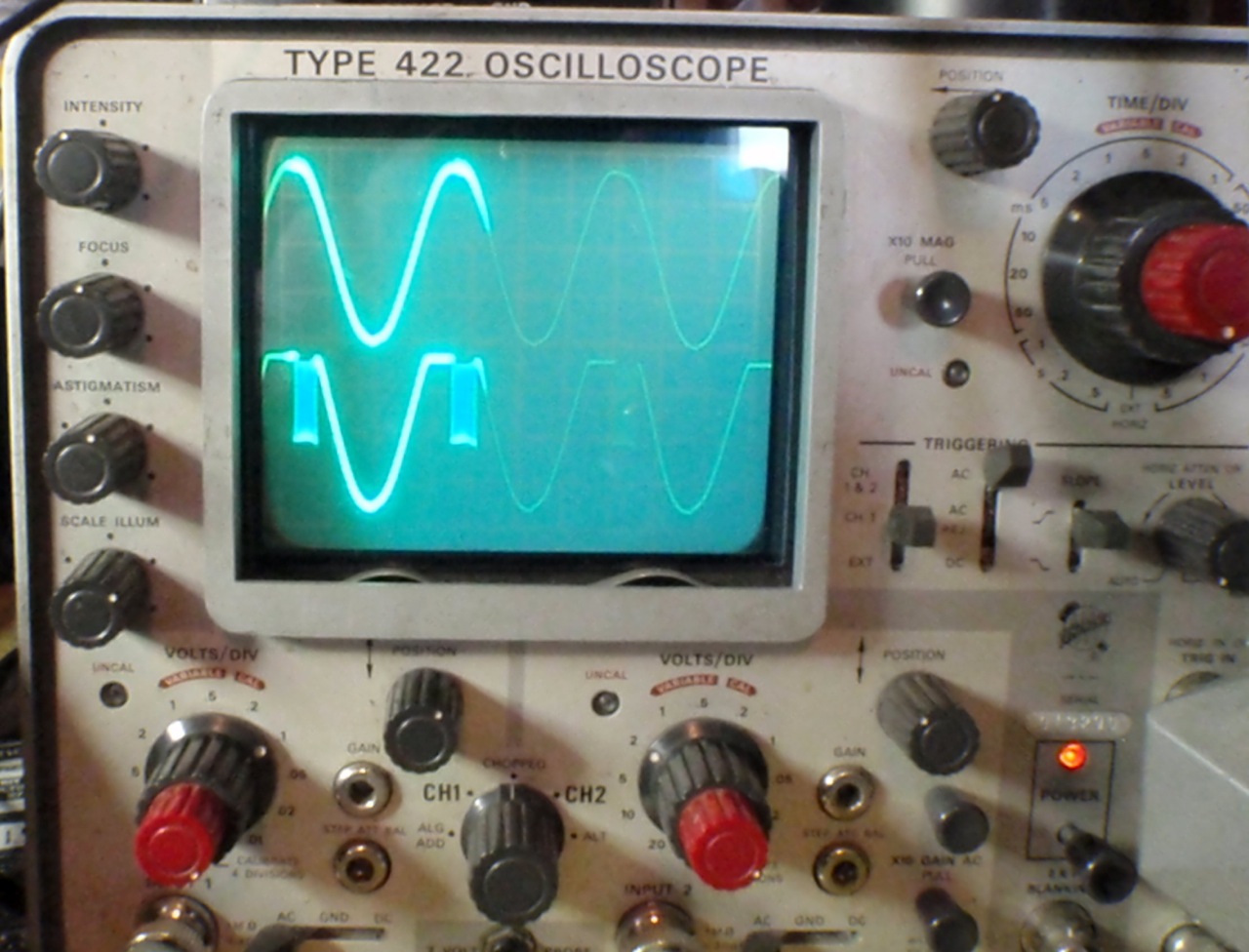

Finally got some more work done on this.
1. Removed and tested Q9 and Q10. They both passed the diode test with my DVM and the IT-18 leakage test. Their gain was borderline (203, 179hfe) so I replaced them both with tested 2240 and 970 transistors with in-spec gains (390, 379hfe).
2. Tested R21, it was dead on. Replaced it with a tested new resistor since it was unsoldered.
3. Removed and tested C5, it was correct at 4.84uf. Replaced it with a fresh new 'lytic (tested at 5.01uf).
4. With no load on the amp, I put 1.0vac, 60hz sinewave in at the RCA input. With power at 30% (approx. 36vac), I measured VDC and VAC at D+ and D- on both channels:
Good Channel: D+ 0vac, +1.0vdc, D- 0vac, -1.0vdc
Bad Channel: D+ 20.6 vac, +3.8vdc, D- 20.3 vac, +1.9 vdc
5. With the same input, I raised the power to 50%. I obtained the attached traces. The upper trace (ch1) is the input signal, the lower trace is output at the speaker outs. You can plainly see it is still oscillating.
So I guess the next question is, why do I have positive VDC at D- and VAC at D+ and D- on the bad channel?
