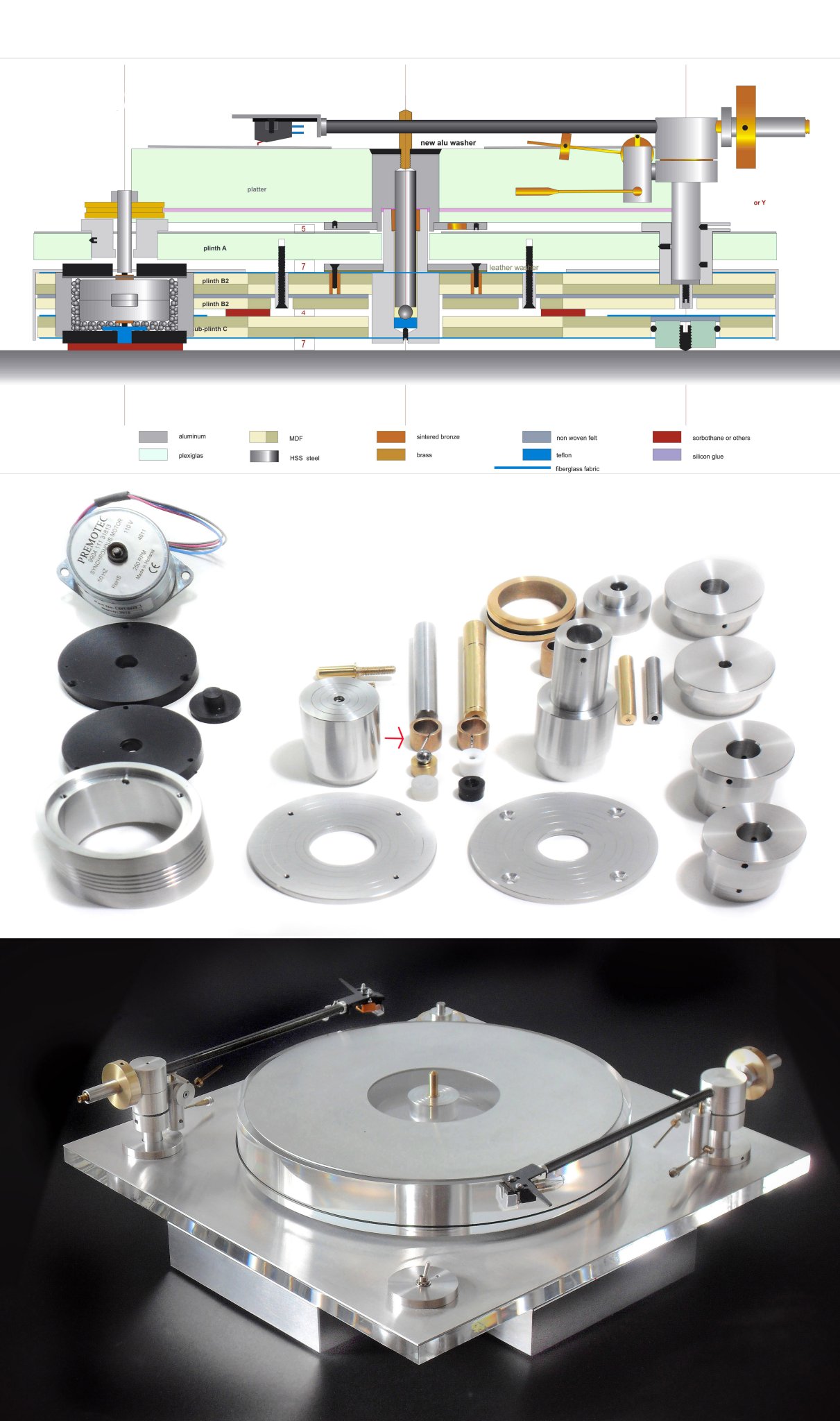

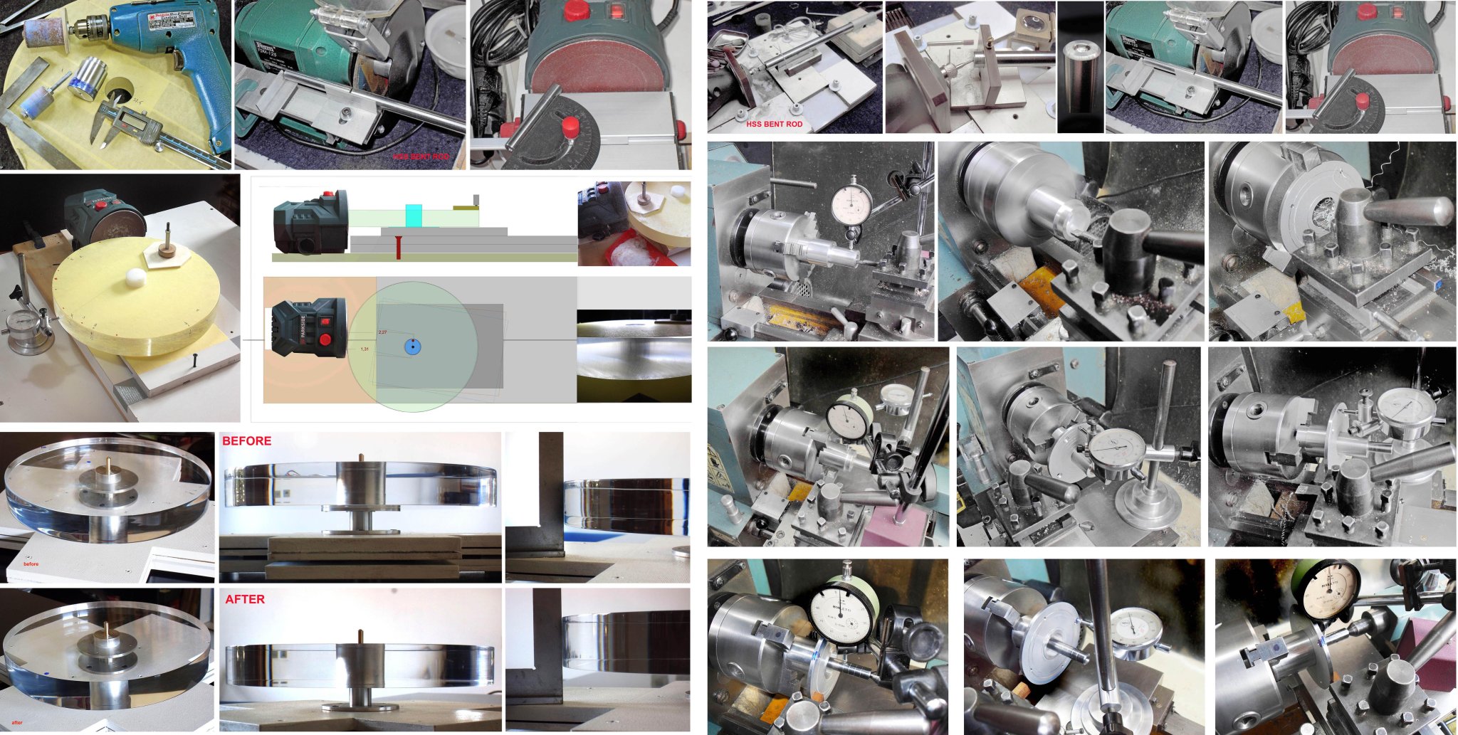

My 2 cents for those who, like me + some of us, do not have "toolroom machines" and, more, the adequate skill to use them.
(Sorry, no micron tolerances, just matching, ending with 1/10mm ca wobble and eccentricity on platter edge, measured)
First - be wary of AliBay claims: to avoid some previous diy disappointments in turning spindles, this time I bought a HSS rectified rod, "lab grade" = bent, for bananas measuring? dumped. And I had the 40mm plexy platter CADCAM precision laser cut by a well known workshop (sounds hitech, isn't it?) = slanted + offset laser cuts.
So, landing on earth. For the spindle I had to turn it myself from scrap on my ol' rubber BV20 lathe = never, never remove the spindle from the chuck, to get it true. But, after the lapping, the "perfect" spindle was a few cents undersized. So I simply cut the sintered bushing diagonally. Together with an accurate mating of the ball + seat materials (various trials), with some tuning all works fine to have a really quiet spindle. (stetho)
For the second one, the crooked platter, I had to center and rectify it carefully by blueing + that simple gadget = two days spent + lots of dust to breath

hope photos are clear - that's all, folks
