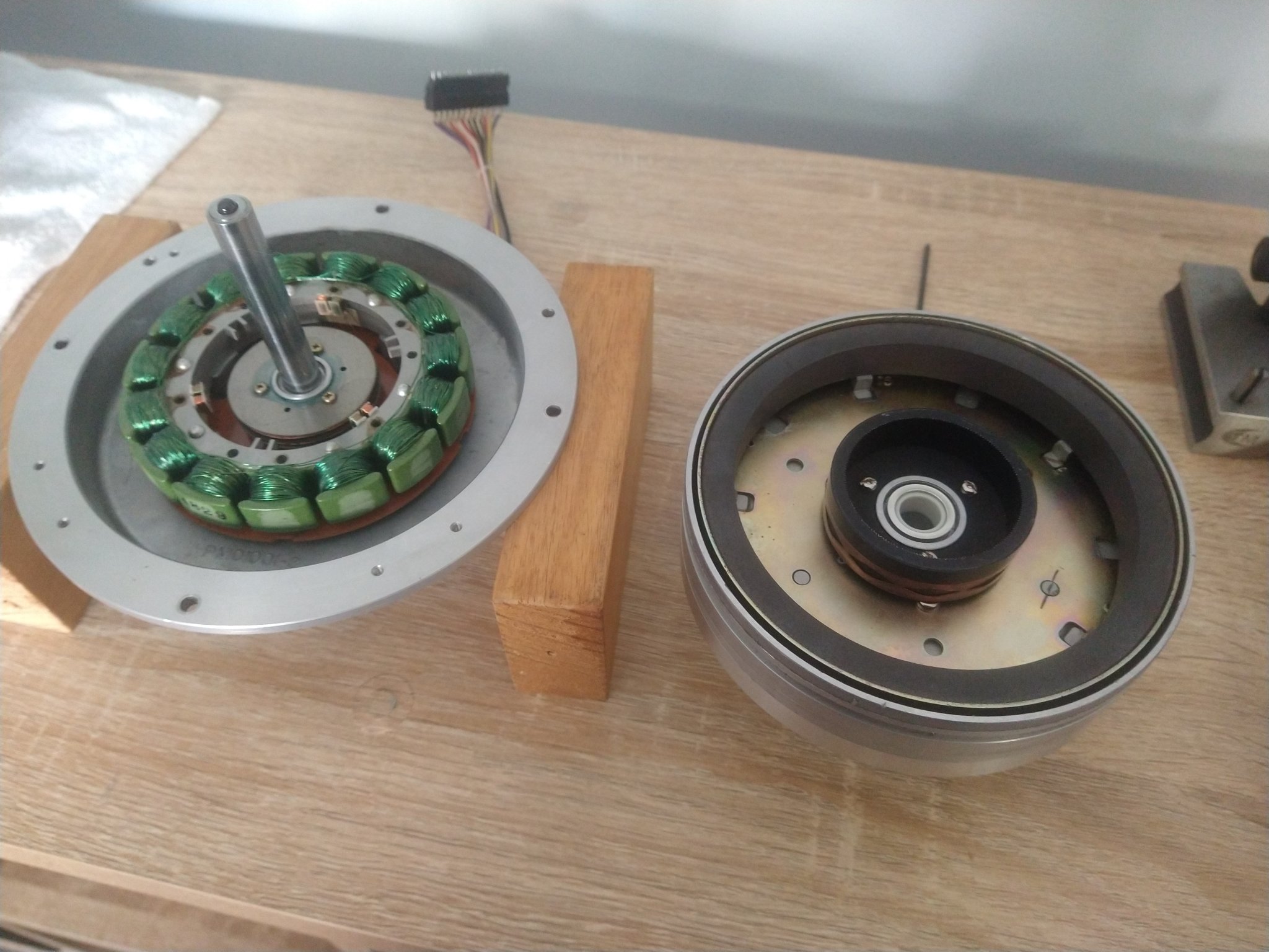

I have built a few TT bearings now including modifying the mighty Technics SP10mk2. My first inverted bearing SP10 motor used 12mm Silver Steel rod polished with diamond paste to 0.5 microns. M2 will do a good job too. For the journals I used Vesconite HiLube with a very tight running clearance once the journal has run for a 10-20 mins it becomes extremely quiet even though there is no oil film. I did use a thin film of oil initially.
I tested this bearing with a contact microphone on the bottom of the housing against an LP12 Cirkus bearing for noise and the Vesconite was significantly quieter even though the LP12 was hydrodynamic.
Here is a photo of the modified Technics SP10mk2 motor. The journal is BS-1407 Silver Steel with a 5mm SI3N4 ball. You can see the bottom journal sleeve in the rotor. The thrust pad is also Vesconite Hilube.
As you have the capability to bore in situ this is the way I would recommend to achieve a great TT bearing. Because it's a non clearance running fit with less than 0.0004" clearance the platter rotates with increased stability.

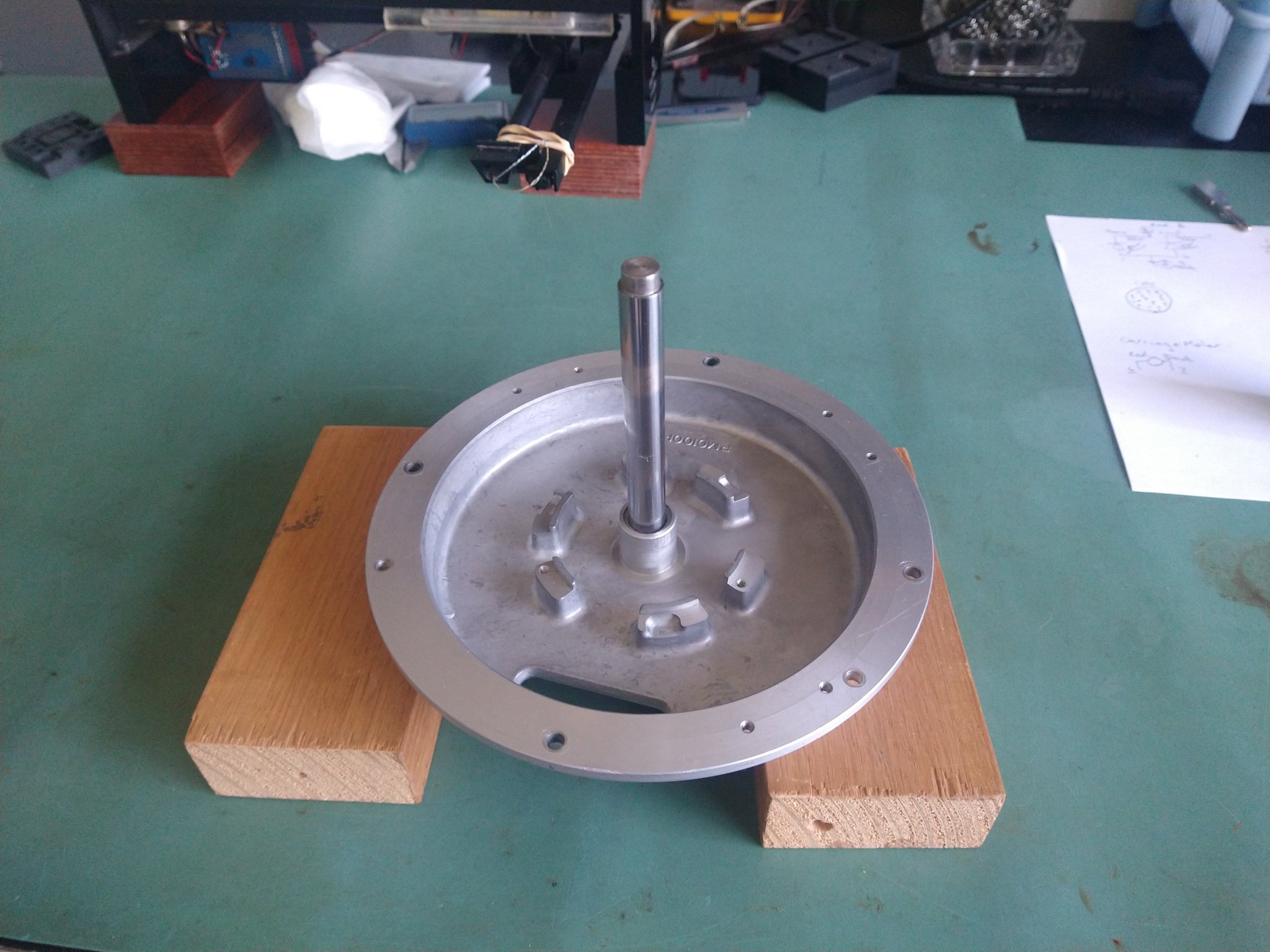

In my first prototype inverted bearing I used 12mm linear shaft which worked well. This is a photo of the first iteration.
