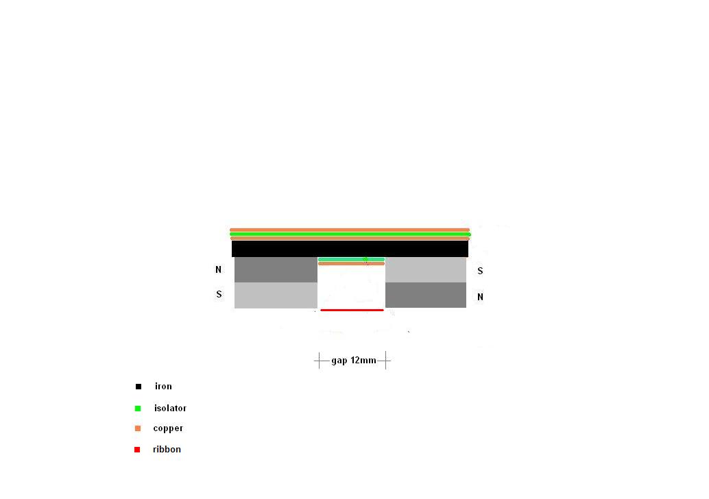

Here is the drawing.
my.php
my.php
Here is a graph that shows field along the red line.As you see it goes both + and-
my.php
This one is without steel in the gaps.
I dont understand why the field show reversed polarity at magnets ends gap
And neither do I understand why it shows as having even stronger field there as well
Well, it may seem more likely with the back pole iron "streching" through end gaps to the front pole
But with air gap it would seem different
Makes me wonder whether the backpole iron should be sliced/cut at magnet ends gap:scratch2:
Maybe its the backpole iron causing the polarity reversal
Though, I have the iron back pole iron mounted as in planars
and with copper as well
maybe that makes a difference

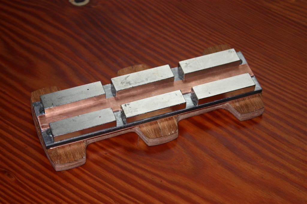

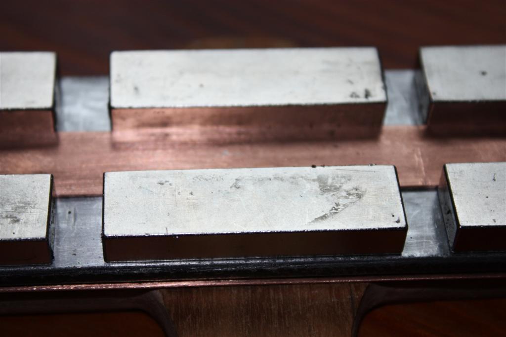

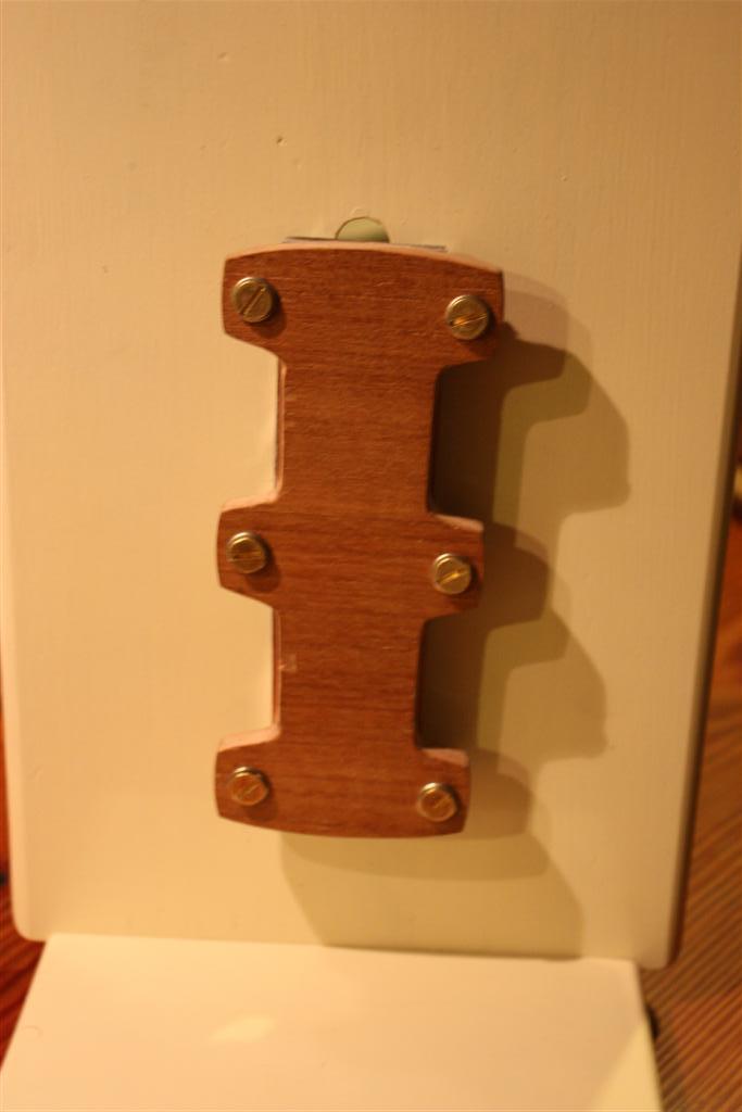

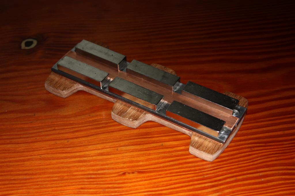

Regarding field reversal between magnet ends
I have tried with a compas
It shows no other than a slightly bending field, but no reversal
Compas method may have flaws tho
Then I tried with a very small magnet
It appears that there may be something like a null between magnet ends
Certainly not reversed field
Or at least it is very weak
My conclusion is that the possible reversed fiel causes a near null effect, but certainly not a strong reversed field as suggested and shown by sims
Or at least not in design shown below
I claimed earlier that theres a general increase in magnet field with slighter greater gap at magnet ends
My theory is now that the null effect is there, and its spread remains the same, no matter how big your end gap is
With magnet ends closer together the null effect spreads into the magnet
Hence you get a slightly weaker field, instead of a null effect

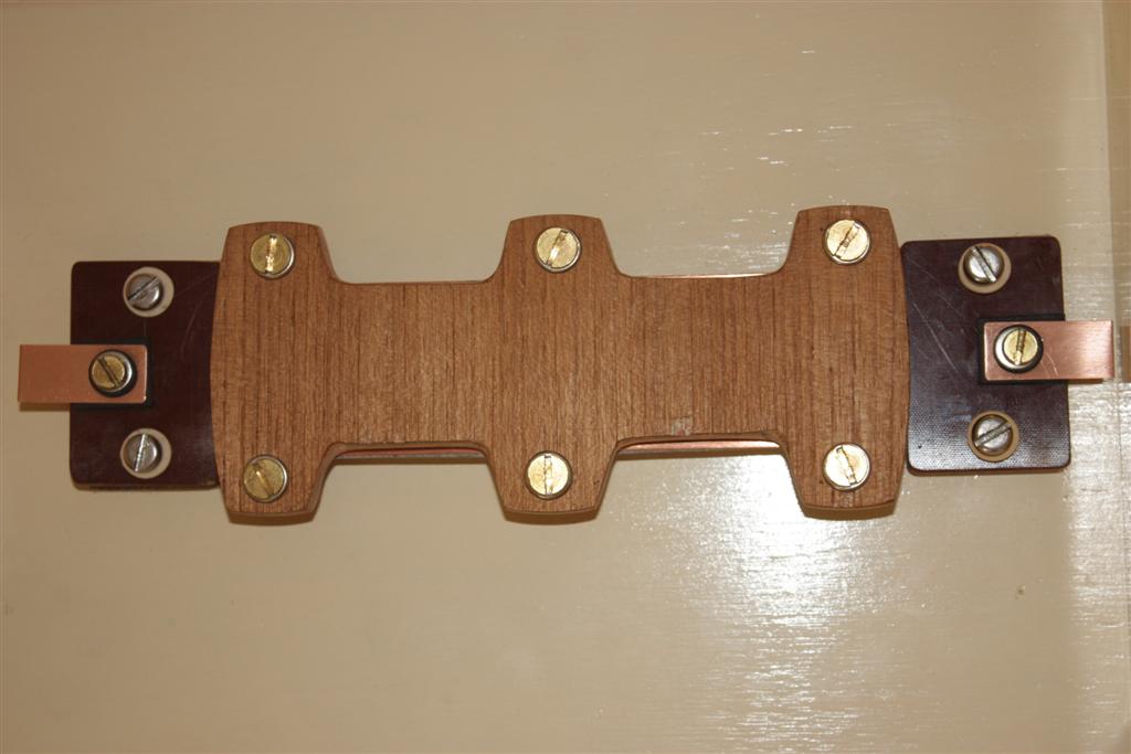

I must agree with you Tinitus .I have just done a test that shows the same.I have been confused by the 3.dimension.Sometimes you see what you want to see.
I made 2 tests.The first with the end of a magnet held tangentialt to the rows and it repelled in the gaps and atracted at the magnets,but as i tried with a thin aluwire supplied with DC. it shoved that there was no differece regarding gab and magnets.
Sorry for my wrong simms,but glad that i dont have to change my magnetsystems.
Bernt "bånd"
