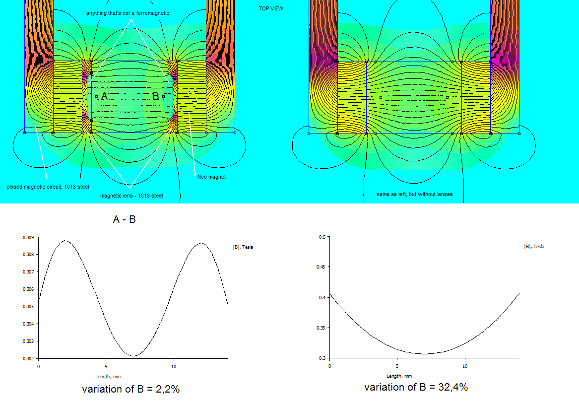

What do you guys think about using magnetic lenses? I've tried that and result are better than expected. Homogeneous magnetic field enables using flat ribbon and that has obvious advantages over the corrugated ribbon - higher sensitivity and lower THD (proved by real life experiments performed by Verhagen and described in his book).

hhf_pm: What do you mean by magnetic lenses ?
The FEMM simulation shows that the magnetic field decreases with the length of the ribbon. I can not check if this is true since I don't have a gauss meter. See post n. 581 (http://www.diyaudio.com/forums/planars-exotics/50162-another-diy-ribbon-thread-59.html#post2208504)Brunob, can you explain that difference in the value of B? If all physical dimensions are equal (magnets, steel bars, gap), it's impossible to get 8 times lower B for longer ribbon.
Corrugated ribbon have lower THD at low frequency and higher THD at high frequency. I have seen this in the German magazine Hobby-HifiWhat do you guys think about using magnetic lenses? I've tried that and result are better than expected. Homogeneous magnetic field enables using flat ribbon and that has obvious advantages over the corrugated ribbon - higher sensitivity and lower THD (proved by real life experiments performed by Verhagen and described in his book).
It's true if magnetic field isn't homogeneous (90% of commercial speakers). Lower frequencies require higher excursion, so if the magnetic field isn't homogeneous, THD will increase with decreasing frequency. Magnetic lenses in magnetic circuit can greatly lower THD at low frequencies with uncorrugated ribbon, so ths way (magnetic lenses + flat ribbon) we get THD lowered in entire band of the speaker - that's what I'm trying to achieve.

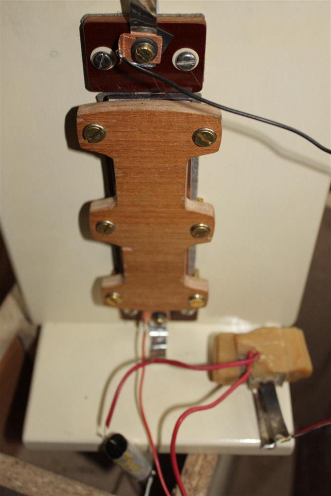

Ribbon...and now its playing 🙂
Connected through old Gamma trafo
1. try with 1uf series cap, sounded VERY subtle
2. try with 2.2uf, a bit more sound
Finally with 10uf cap it plays louder
quite smooth and detailed, "airy" and soft, easy on the ears
After its disconnected again, it could sound like it may have played louder than I first thought
Suddenly it becomes obvious what I have been missing for way too long
But at the moment I have no speaker that it could be implemented into, its just experimental right now
I have a pair of Betsy, and a Lowther horn, so maybe that will work, just lack of free time
try it as a supertweeter......
for that it would be better to build them much much smaller, with very narrow field gap 😉
anyway, I etimate sensitivity to be around 90db, or so
Thats too bad 90db is not gonna work with a Lowther.
yeah now that I look at the photo closer it is a little big for that.

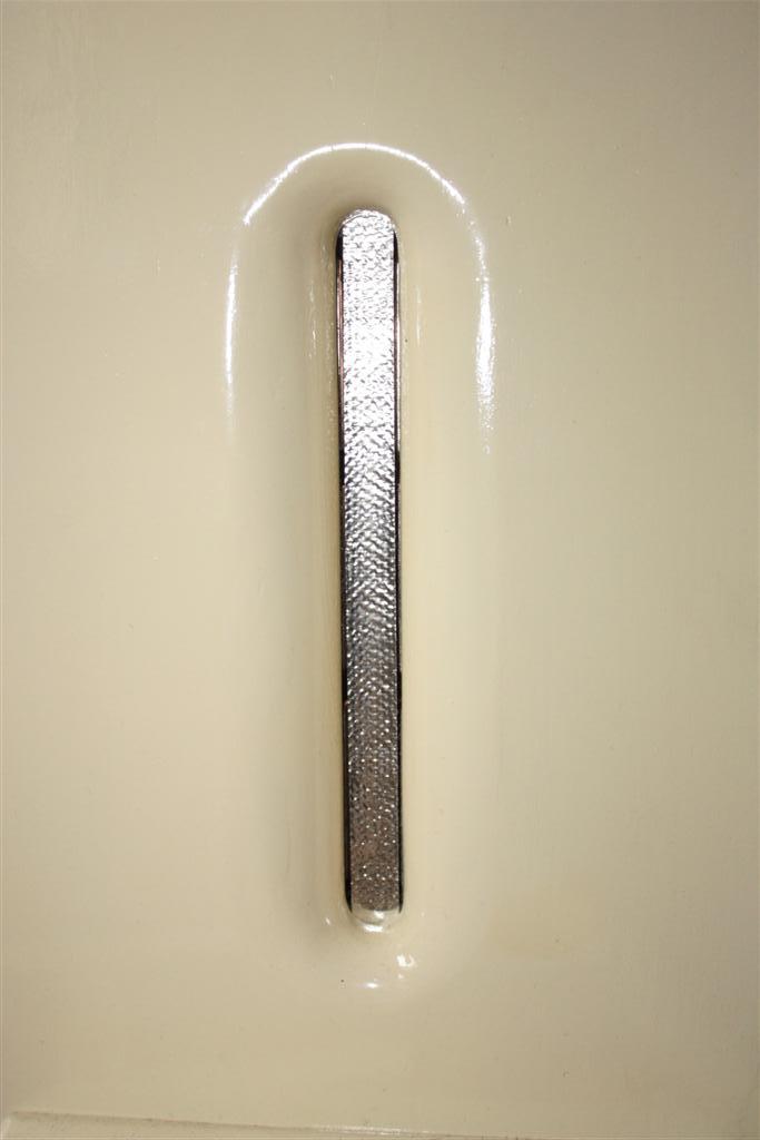

ribbon diaphragm itself is 170mm long, 12mm wide
cheap sandwich "paper"
paper on one side, foil on the other
corrugating is easy
place diaphragm on a fine cloth, and roll a piece of hard flag line back and forth

my magnets are relatively small/thin
just some I got for free, a long time ago
They more or less determined the size of this one
and trafos are as said from burned Gamma's(Decca copy), of which there have been plenty, burned ones
these trafos are not much bigger than the tip of a thumb
and poorly assembled in wax
but one side(primary?) is soft silver plate
I suppose thats worth something
I am thinking about having quality trafos made by trafo specialist
I think its worth it

Could you provide more details about the sandwich paper (brand, ...)?ribbon diaphragm itself is 170mm long, 12mm wide
corrugating is easy
Did you remove the paper from the foil?
