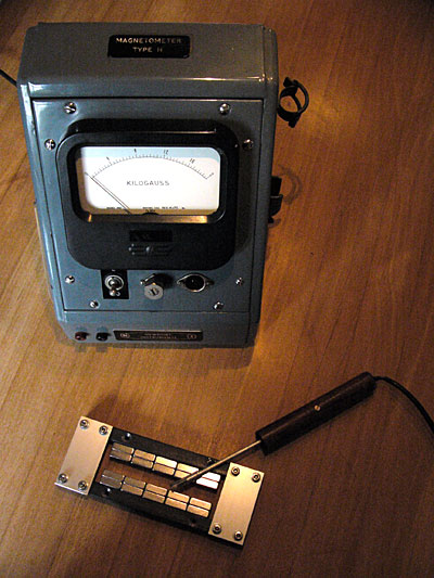

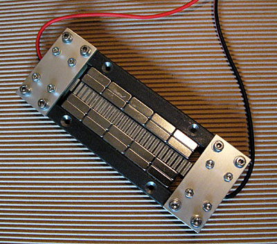

Magnetic field strength
Hello again,
from a friend I borrowed a gaussmeter which measures the strength of magnetic fields with a probe small enough to be positioned in the gap of my ribbon speakers. Here are my findings: Fortunately the field is
a) highly concentrated in the gap
b) linear across the length of the gap; linear part begins after half of first magnet block (some 10 mm) so that total homogeneous field ist just one neodym block shorter than magnet row (9 out of 10)
c) as far as the old gauge is correct field is strong at some 0,5 Tesla (5000 Gauss) in the middle of a 12 mm wide gap between double rows of magnets - see foto.
By the way: I also tested if the field is influenced by the addition of iron pieces across the ends of the frame to close the magnetic flux in the rear of the ribbon. Varnhagen seems to be right in his finding that this doesn't make much of a difference in efficiency - I could hardly see a deflection of the meter pin.

Is the result similar to simulation in Femm? I can't get gaussmeter so i need correct simulaton results.

Sorry, but I didn't simulate the ribbons so I can't say if measurement correlates well with FEMM-Findings.

Michael - your gaussmeter tests are very interesting, especially the crossbar results. How big (cross section) was the steel crossbar? Are the plates that you have at the top and bottom of your ribbon made of aluminum?
Denis
Denis
Crossbars
Yes, the plates are made from aluminium. Crossbars were same material as frame of ribbon, i.e. 12x12 mm^2. Measured difference in field strength was really nil.

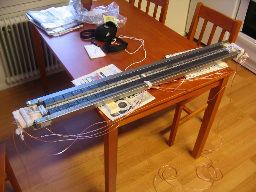

Thought of sharing a picture of my first ribbon mid/tweeter that i just got finished.
Magnets i'm using are normal ferrits that i've had laying around for a couple years now, about time they got use 🙂
The next version will probably get some changes in ribbon hook-up and the metal structure at the ends, also have some other ribbons i want to try out. Effective ribbon size is approximately 2,5cmx100cm
