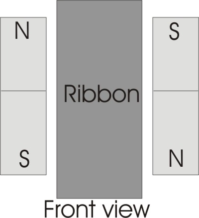

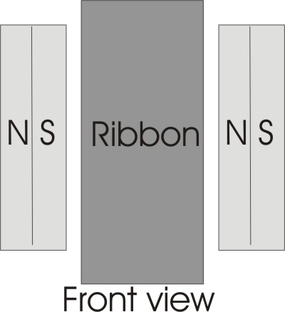

Not only they are curved, their direction of magnetization is in different position, so if you make a ribbon with them, it will turn around it's center .

Bellow are pictures (simle sketches). You need direction of magnetization that is normal to electricity flow in ribbon. Also you need magnets that want to get closer to each other (N-S, not S-S or N-N orientation). And whole ribbon needs to have N at one side or S at the other. There are some other arrangements of magnets but this is standard.
First picture shows how it should be done, and the other one how it would be if you put magnets from hard drive).
