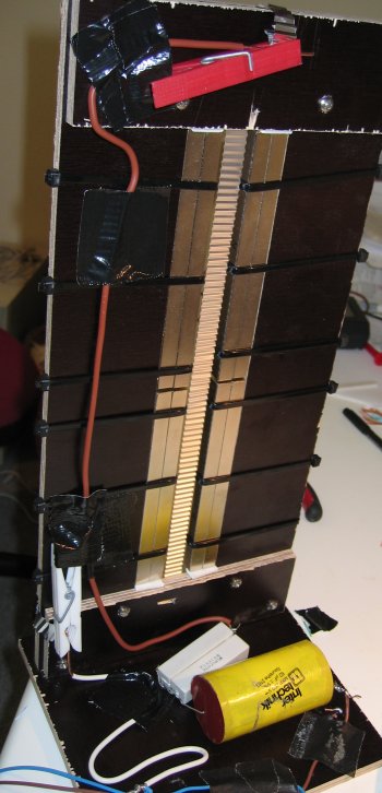

Hey
I`ve followed this tread with a large talk about those wonderfull diy ribbons for a long time, and would like to supply.
I`m in the planing phase of building a big line source system, with effective ribbon length 165cm.
In the weekend I`ve made at little eksperiment, as you can see on the picture. It shows the back af the ribbons!
-2 pcs. N40 i each side (4 in each side), fastnet with plastic strips!
-Pure 11my, 13mm (Width), 30cm (High) aluminiumfoil as membran,
fastnet with Gaffatape.
-Serie capacitor (1khz/6db-oct) and -resistor (1,3ohm)
This work well with my low ohm killer amps 🙂
It sound wonderfull, and better than my old dometweeters 🙂
But also a little "thin" and "touchy?", but this can well be my filter.
When I changed the serie resistor to a 3m long, 1.0cm (width) cut out alufoil, the same materiel as the membran, it made the sound more detailed and delicate 🙂
But to my questions:
How do you construkt your magnet system?
a: The magnet on to each other (flat to flat), like my little eksperiment?
b: Attach the magnets to a piece of iron, and then let this magnified piece of iron do the field
c: What about those ironpcs. acros the back of the magnetics.
I don`t like serie restors, but don`t know about transformers. Haven`t heard them yet....
I planed to use 2, length (170cm) of 10mm width, thin alufoils glued to a mylarfoil, witch shold give me a resistans of about 1,5 - 2,0 ohm, this should do well.
The ribbons should work from ~400hz - 20.000hz, with a area at 2cm width and 165cm high. The baffel should be about 18cm width.
But I like my new pure eksperiment ribbons, and they are much easyer to make than compound 🙂
Cheers Jan Jensen, Denmark

That looks very nice, especially since you only consider it a prototype! Read through some of the earlier posts or take a look at my website to see how I constructed my ribbon:
http://home.comcast.net/~hendentures/
A quick summary is that I placed the magnets flat on each side of the ribbon. The magnets are attached to steel bra pole pieces with steel cross pieces.
Good luck and keep us all informed!
Denis
Hello Jan,
your ribbon looks very promising indeed! For your questions please have a look at my homepage under "Lautsprecher" where I explained how I constructed my ribbon prototype:
http://www.michaelgaedtke.de
The magnets are glued 'flat to flat' as you put it to two rods of iron 12 by 12 mm squared. Up to now I don't let iron magnify the magnetic field; I left that for further experiments. I too experimented with iron pieces across the structure to close the field at the back, but that doesn't seems to make a big difference in performance so I left them out at the present model.
Hope this will help you. Good luck!
Thanks,
Dennis and Michael, I`ve studied your homepage a lot of times, and find good construktions tips 🙂
I`m just confused of choose the magnet layout. At first I`ve thought of doing it the Dahlberg way like this:
http://www.dahlbergaudiodesign.se/engelska/del1.htm
With to rows of magnetics side by side, but thinking it`s a litle waste of field. The ribbon don`t take large movements, or are ideed not intend to!
By arranged the magnets on to each other, I`ve get at lot stronger field for the same money 🙂
Another way to do the field is described here (The bottom of the side):
http://www.soundimage.dk/Different-col/Ribbon-DIY.htm
This can be made of a masiv iron piece, with cut of corners to hold the 2 magnets (1cm x 1 cm)
Seen something like that on this side (bottom again):
http://www.soundimage.dk/Friends/Andre.htm
Andrè have made a very interesting ribbon her, that is "talked about" in this tread on the danish hifi4all.dk forum:
http://www.hifi4all.dk/forum/forum_posts.asp?TID=9852&PN=1&TPN=15
It`s in danish, but I can translate if you like.
Have a nice weekend 🙂
Cheers Jan Jensen
Cheers Jan Jensen
