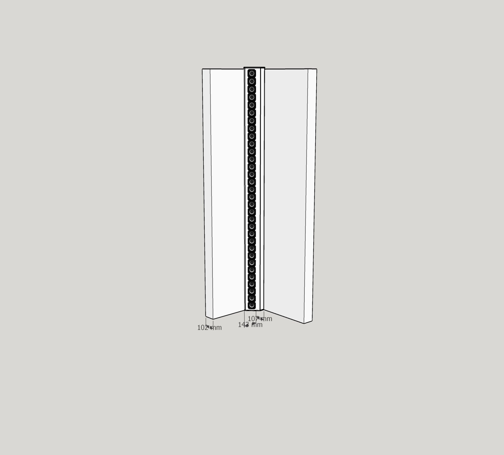

Attached is a sketchup export of what I built - an array of 32 2.5" drivers with 4" thick absorbers butted up to its sides. The sides are asymmetrical to shift the aiming point . If you leave some space between the array and the absorber, you can shift/fine tune the aim without losing effectiveness against those first reflections. With TC9s, this would work very well for you at very reasonable cost. The array cabinet could extend all the way back to the walls to provide more volume for the drivers, although I chose not to do that myself because I had designed it to work with subs from 80 or so Hz and up.

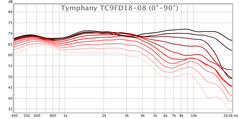

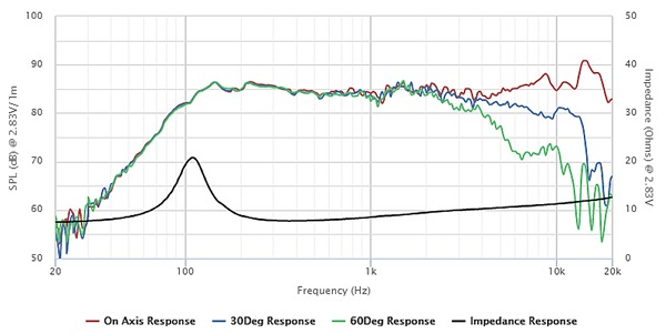

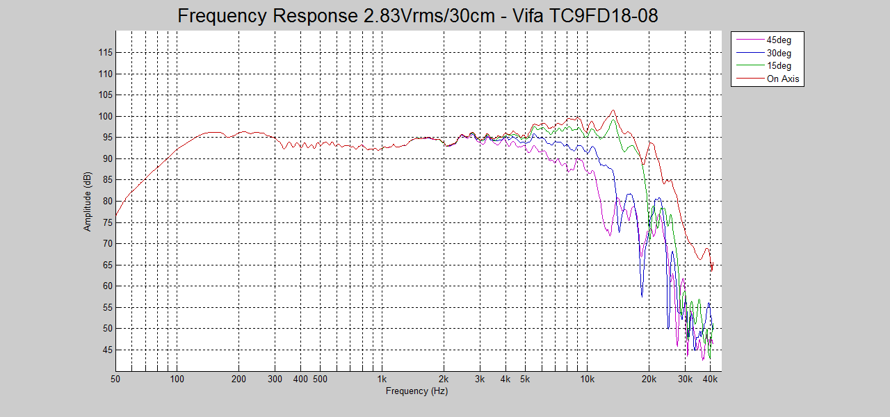

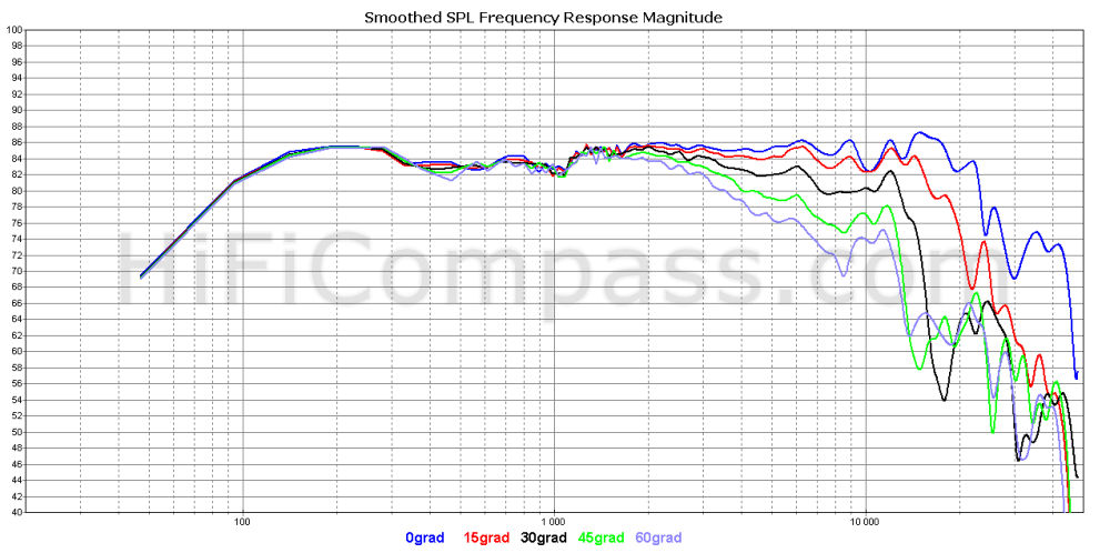

That’s the TC9 response……not unlike any other 3-4” driver…..cone breakup due to size is inevitable as is off axis behavior ………everything above 10k is a mess and demands extreme measures to correct. Of axis behavior?…….the graph says more than I ever could with words…….the rationale for a crossover less implementation falls apart completely after 5khz.
Again, combine four of these drivers in an MMTMM on a very slim free standing baffle with suitable bass support?……you have my attention…….a 4” wide and deep slim tower out 18” from the side and back walls?…….yep…..now we’re creating a soundstage with reasonable effort. Choose the right tweeter…….build it around a hybrid active/passive system with a .5 inductor rolloff on the outer TC9 drivers?……..yep. Cross the whole top over to a pair of 8” woofer per side with a Hypex sub amp at around 400hz?……..oooooooh…….now we’ve got some serious power handling out of just four TC9s and some wonderful midrange clarity happening……and a focused ‘line source’ too!……we’ve narrowed the vertical directivity within a passband that’s workable.
Build it artistically following linear minimalism?……..sure……….a tapered enclosure with a mild curve to the baffle to align the drivers acoustic centers?……oooh….now we’ve got form and function going on…..how bout that! A nice matte white finish with a charcoal baffle ……some nylon chord grills aka Sonus Faber?……..some eye candy.

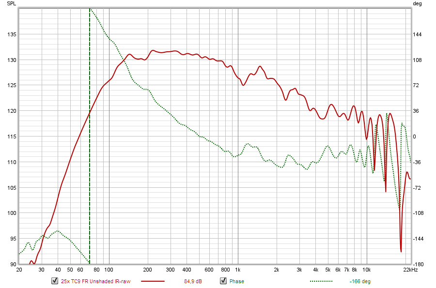

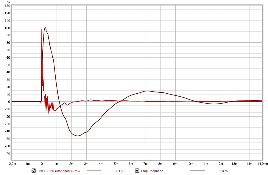

Here's what the IR looks like from an array as measured RAW:
And the SPL graph that belongs to that:

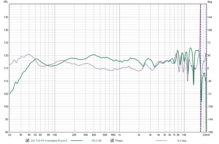

To get things into the window of using DRC-FIR, I'd have to apply some pré-EQ, just to make sure my output that I want to correct isn't filtered out because it is below a certain threshold of the filters I've set. So that changes the IR completely, because we boost the high frequencies by a lot.

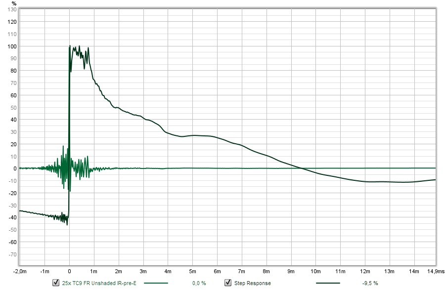

The IR after pré-EQ:
And the belonging SPL graph:
That makes it pretty clear to see all those arrival differences, doesn't it? Mainly in the IR, we now see about a 0,7 ms hash in the STEP response, mainly consisting of high frequency arrivals fighting each other 🙂. The SPL graph shows the result of that, many dips and peaks on that top end. From 7 Khz and up the pattern shows us the combing.

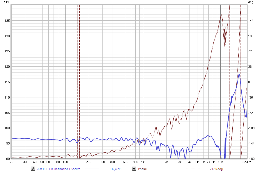

After that, DRC-FIR does it's thing, again first the IR:
We see that top end is more gradual and arrivals are harder to see (but still there)

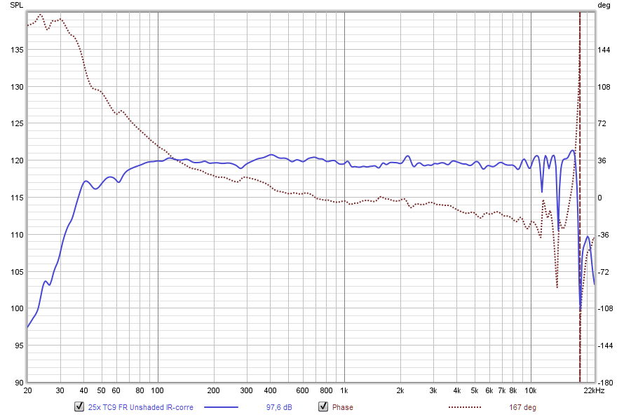

And the beloning SPL graph:
Dips aren't prevented completely, but the top end is corrected to nearly flat.
We do see quite a bit of movement in front of the peak in the IR though, that must be pré-ringing. So at what frequencies is that happening?

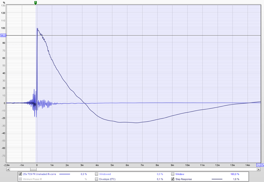

Let's filter the IR to look at what happens before the (official) IR start:
The blue parts are filtered out, we look at what happens before the peak. This gets us the following SPL graph:
This shows us the preliminary wiggles that are seen in that IR are dominated by high frequencies.

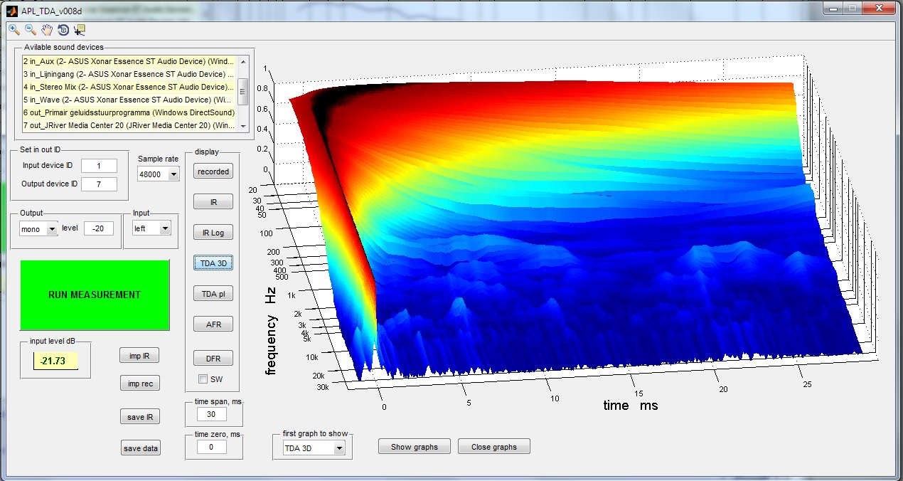

What that manipulation of the IR does in real life can be seen more clearly in the APL-TDA graphs. That is a tool, producing a graph as created by @Raimonds to show tiny timing differences.
After fine tuning my processing for unshaded arrays, my APL-TDA graph, as measured in-room looked like this:
You still see a sort of step-up above 10 KHz, but this graph here kind of functions as my "proof of concept" of that first wave-front arriving "in tact" at the listening spot. Prior to running APL_TDA I had never seen this in such detail. Mr. Raimonds Skurels had posted about his useful tool in the Full-range forums and I simply ran his Demo version of that tool to see what I got. That story is here from back in 2016: https://www.diyaudio.com/community/...can-we-do-with-dsp-power-now-availabl.284916/

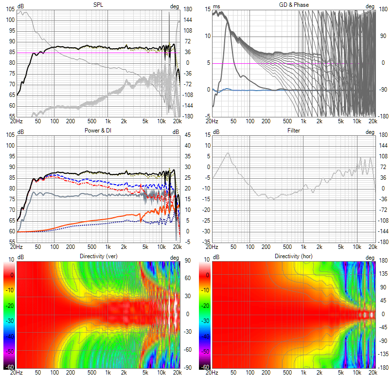

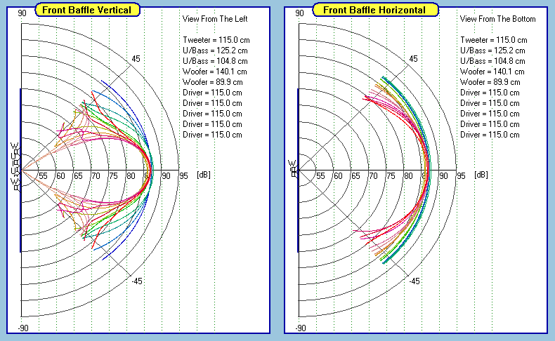

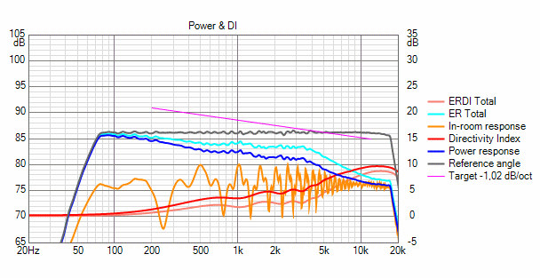

On the subject of high frequency directivity in the room of an array of drivers. I just have to say a couple of things about it. I've spoken about my back-up plan by sticking a tweeter in the middle. I just never needed it. Want to know why? In my listening area the arrays are using toe-in that I determined in listening sessions. I simply chose the toe-in that did sound best to me. Wherever we sit (or stand) in our room to enjoy the speakers, we get satisfying high frequency results as our ears are never really further off axis than about 20 degree at the main in use positions. The further drop off-axis would have a larger effect if I had not used absorbing panels at first reflection points. Maybe then I'd hear/perceive that drop in output that the 3.5" drivers show in off axis graphs as posted here. But there's another que that's important to notice. Look at the graphs of directivity that VituixCAD produces for us:
In the left-middle graph look at that red solid line. That's the DI index. A prediction of directivity in-room. Due to the spray of the arrays to the ceiling, you know, what we called "lobes", the directivity stays somewhere between 10 and 15, which isn't bad at all. The most important part is that it climbs gradually when going towards the higher frequencies. That's how we perceive the speaker including that high end. We don't particularly hear the combing as something separate at higher frequencies.
I've already compared and shown the result of a single driver compared to an array. A single driver shows even more in-room combing than the array "as perceived" from floor and ceiling reflections alone!
So it isn't always that straight forward to say how it works until we take a closer look. I'd love to see @mayhem13 produce a DI curve for his proposal, just to see if he can arrive at an as smooth climbing curve as an array actually produces. But I'm not the one that's going to make such a comparison. Believe me, as the tools exist, we tried to include a single tweet (and expecting great results) but it sure isn't that simple. There's a good reason I never went that route. 😉 If you've seen what I've done over the years one conclusion might be appropriate: I wasn't afraid of the amount of work to not try a single tweeter. As I've done many time consuming projects if I was convinced it could mean I'd achieve a true improvement. I just never was convinced an added tweeter could give me that. While having a great set of ribbon tweeters on hand! I still might use those tweeters at one point, just not in the middle of the array.
Is this the single best speaker one can build? No, I don't think so. But it still is the best compromise I could come up with to suit my needs in my room. And the end result sure was rewarding and satisfying. My curiosity will probably never see me stop trying to improve, but I could have stopped all that back in ~2016 and be happy with the results too. I just like to tinker, I'm wired that way.

I'd simply like to see what the MMTMM does 🙂. As far as in room behavior goes, in other words: that DI curve.
I can see the attraction of the Kef Blade 2 Meta concept. Even though coax drivers have their own drawbacks.
I also see the attraction of a MEH, even though that will become quite large to get the most out of it.
Curious to see more data than words on the MMTMM.

Here is a line array paper I started but never finished and probably won't but in the distance that it does go, it shows quite clearly how multiple drivers combine to serve as one.
I agree with Mayhem that a tweeter in a line doesn't work. I proved that to myself a long time ago, then followed a chain of simulation/development that led to Dave Smith's (RIP) expanding array - which is a particular kind of MMTMM or WMTMW or WWMTMWW and, in effect, very much like a shaded array but where the shading is accomplished with driver diameter as well as amplitude and frequency response coefficients.
So we aren't really in disagreement overall so much as arguing for different sets of implementation details.
I disagree that equalization leads to phase issues. No doubt it does if you use a typical bank of sliders in a recording studio. It need not if you use FIR.
One thing I've learned in over 50 years of engineering is that its extremely rate to get multiple engineers to agree on what the best compromise is! Each of us evaluates tradeoffs differently so what one should do is listen to everybody, then choose what seems best to him.

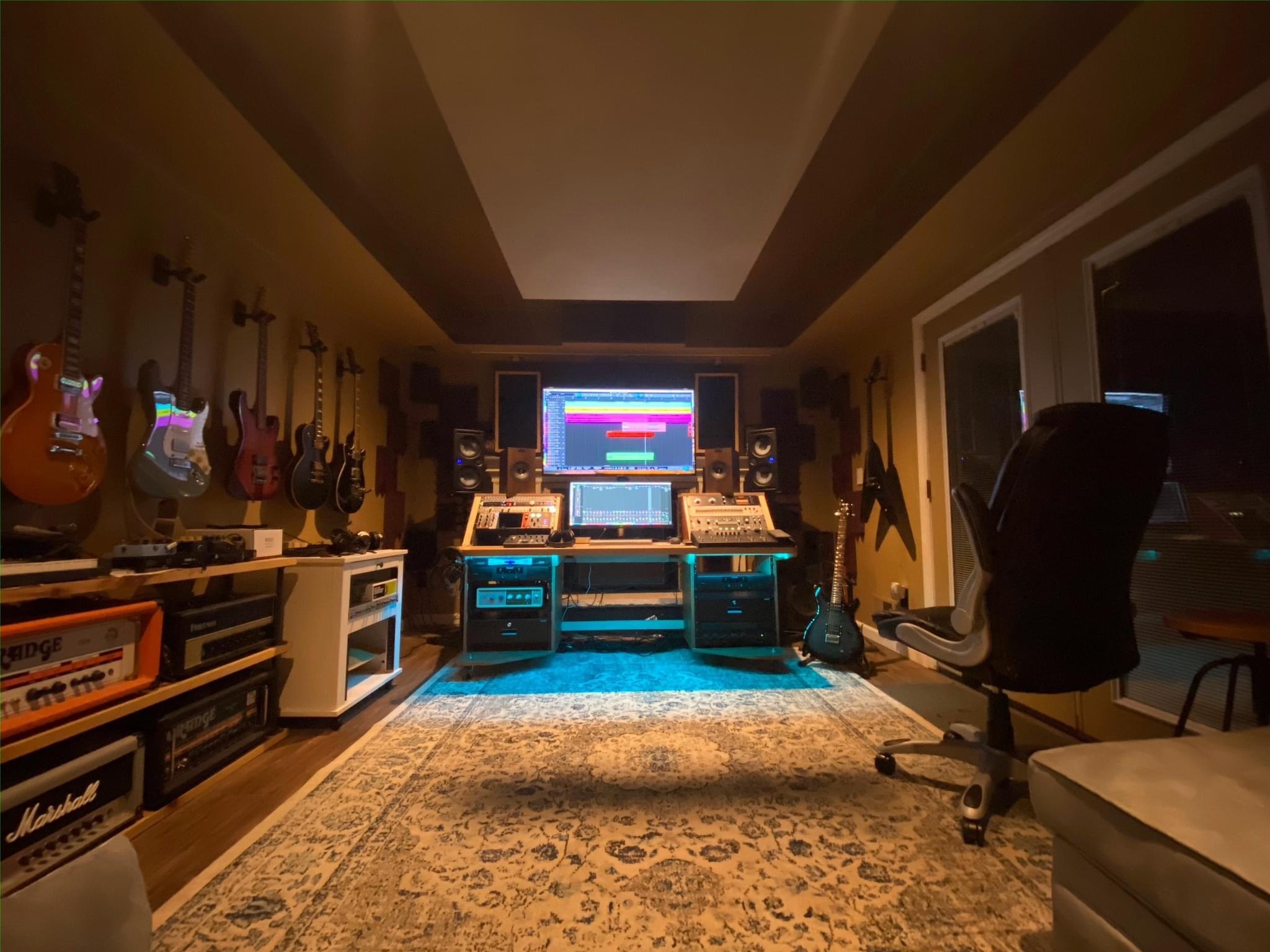

Here’s my in home work space….when I need to get things done in comfort……notice how my commonly shared principles are Implemented in my own space. Notice the very inexpensive, simplistic and yet elegant ceiling reflection mitigation method……that cloud is four eye bolts, around 2 hours to fabricate, weighs around 35 lbs and costs around $80.…..I have no 3d acoustic ceiling in this space.
The KEF Q150s are modified……but they’re still excellent point source and allow me to make very accurate decisions based on phase……I could NEVER listen to them recreationally in the nearfield BECAUSE they expose so many horrible phase decisions that are embedded into some of the great recordings……🤢
