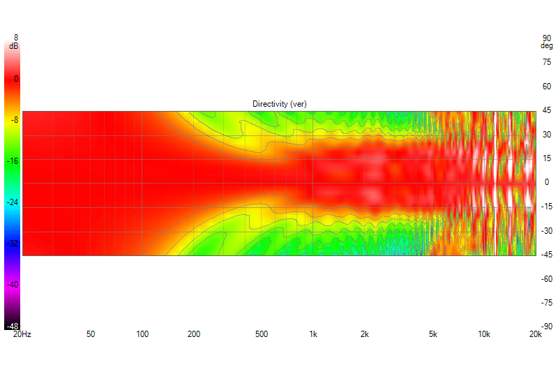

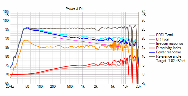

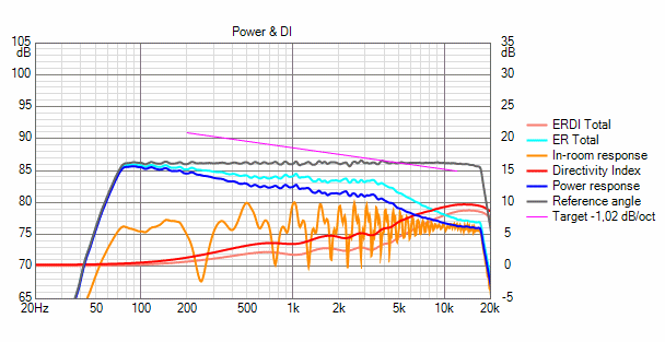

Meanwhile, just to understand, why do they have any less reflections from ceiling and floor than any other type, or is it that with the complete vertical line all reflecting, they don't have the one dominant vertical reflection that a conventional speaker would produce and be limited by?
Yes, a single driver would suffer from one strong reflection off of the floor and one off of the ceiling. For an array of drivers, every driver has a unique position and that makes it act different, the effect of the reflection of each driver is very small. Let's see it in a graph:
The orange line is the combined result (direct sound and floor+ceiling reflections) at the listening spot of a single driver vs an array. The restlessness of the output above 5KHz is due to the lobing of an array with this particular center to center spacing. We can see that lobing in a vertical directivity graph:
(I have limited this graph to about 45 degree to show where the ceiling would be approximately. You see the energy that is directed towards the floor and ceiling. The lobes are caused by the center to center spacing. Using smaller drivers, packed closer together would raise the frequency where that lobing starts.)
Reactions: NeonDriver

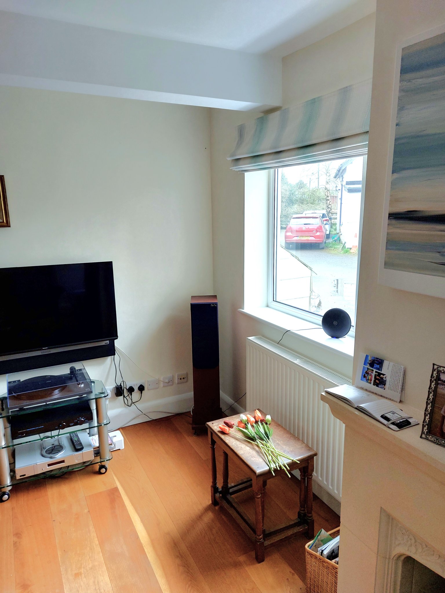

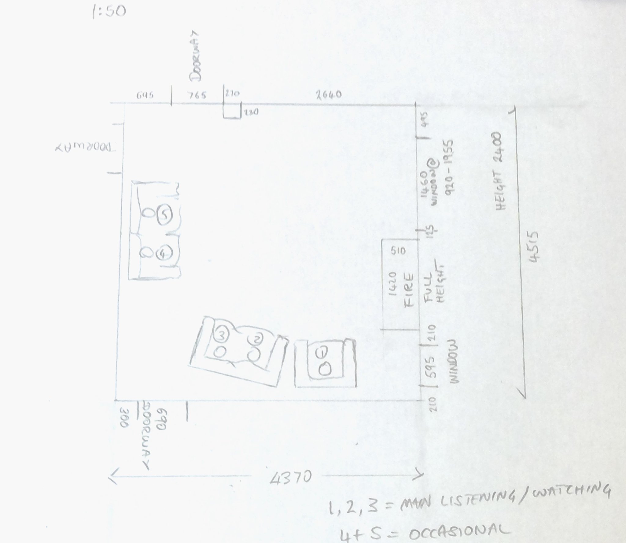

The room is not ideal, that's clear and there is more, although it may (?) help.
The left front corner is really a wall pillar 270 by 230mm, the right corner is a real corner but just 495 away is a window, and then the fire place sticks out, so listening height first reflections will be window and fireplace influenced, the little bit of wall (495) will have little opportunity to first reflect, a scale drawing is attached.
Wesayso asked about computer aptitude, clearly i don't do CAD...........
The listening positions at 1 and 2 are not perfect, but seem like they may have a reasonable chance, 3-5 are less important.

You should design your in-corner arrays to aim at seat 2. That results an asymmetrical shape. Their beamwidth will be wide enough for 1 and 3. In seats 4&5 there won't be much high treble and in fact combing might be audible in seat 5 due to proximity to the left array. Don't let a critic sit there 🙂
Make the arrays as close to floor to ceiling as you can. You aren't limited to 24 or 25 drivers; 32 and 36 are numbers that work. With 32 8-ohm, connect drivers in 8 parallel sets of 4 drivers in series for a net Z of 4 ohms...

Height, 28 x83.7 =2343.6, if they really butt together, room is 2400, just 56 mm left, half each end, is that a benefit over the 25 or does that take the top end of the line into some reflecting mess behind the cross beam?
Do i understand that the null is a first reflection null at the listening positions? If they are tight into the corners of the walls at say 15cms (centre of driver?) that's going to be around 2300Hz? there isn't much wall space there........and i forgot to mention the radiator under the window........! what would absorb that sort of frequency, fairly thin panels? the corner position is all about aesthetics so i cannot go too far with panels etc..........
Aim, just aim the baffle at the head of seat 2?
Its a boundary freflection null, sometimes called boundary interference and it is a result of a (first) reflection from sound wrapping around the side of the cabinet and to the side or front wall and then out to the LP/mic. The frequency depends on the path length difference which is roughly half the width of the baffle plus the length along the cabinet side wall. Null occurs where this is half a wavelength (as you know) and could end up being circa 2300 Hz. that is a good thing that it is that high as an inch or two of absorber will likely make it vanish. Make the cabinet deeper or wider than it needs to be and all of a sudden, you are wondering if you can get enough absorber in there.

I took a picture on the line from seat 2 to the problem corner, it shows the small amount of wall available, or causing problems and the window, radiator and fireplace. my current thought for this is to have learnt it may be a problem but assume it can be resolved and continue to address other matters.
M

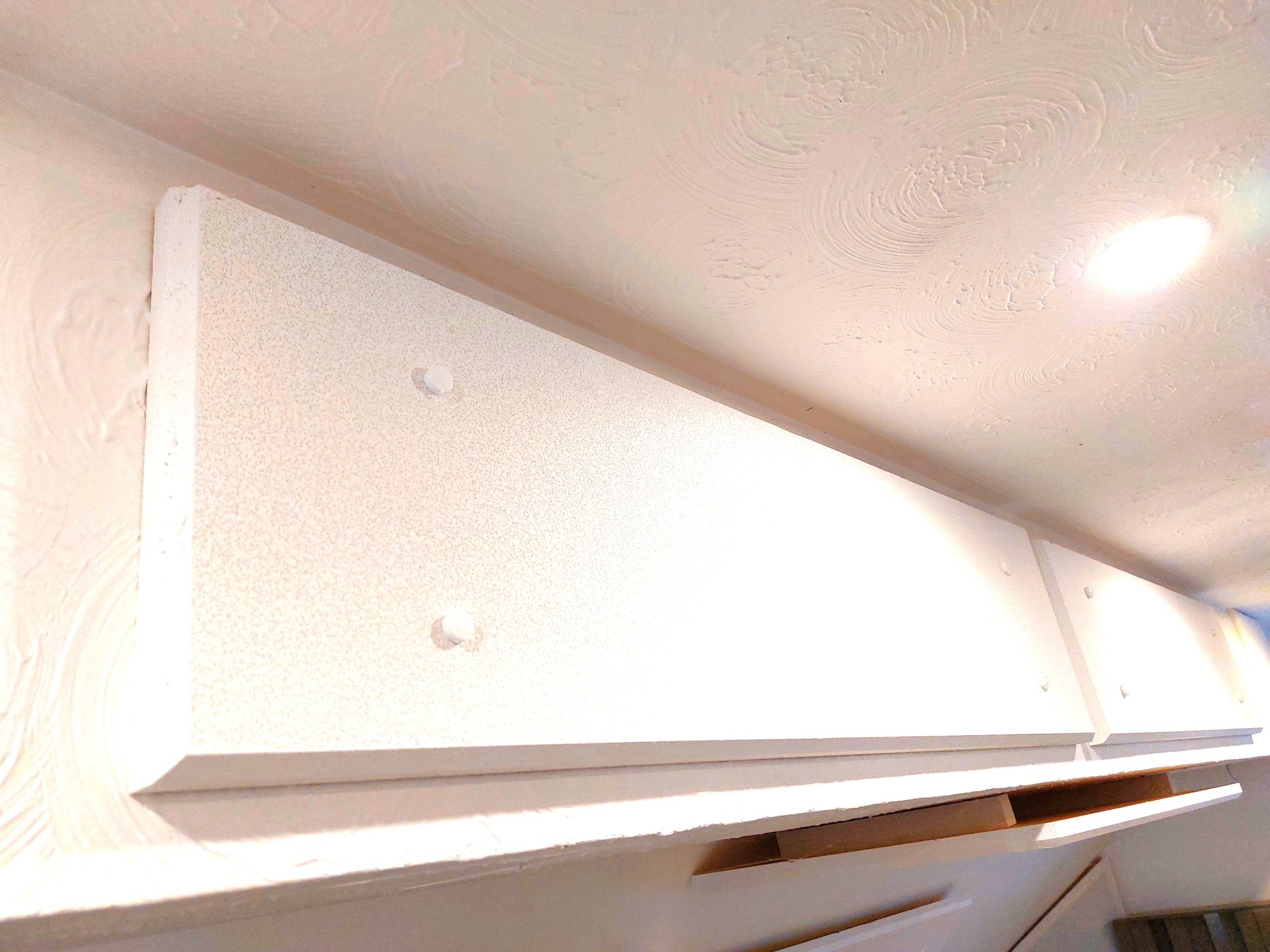

White room, white panels like these in my “office” /listening room, where I play with my Radial arm experiments. These are 300mm wide and would fill a gap between the speaker cabinet and the window recess if the cabinet was 195mm which all seems around feasible.

win_20240327_14_51_41_pro-jpg.1291320
My advise for aiming the arrays (when the position is fixed) would be slightly different from @nc535 as I would aim the left speaker at the left ear position of seat 1, the right speaker at the right ear position of seat 3. It will provide some intensity trading to create a broad listening area.
You could create a round shaped speaker (with a flat baffle for ease) and place it in the corner. That way you can play with aiming while having a shape that provides less diffraction off of the speaker itself. That round shape taken to the extreme gets you something like this: https://www.stereonet.com/uk/news/ruel-r-modular-line-source-loudspeakers
I'd opt to use something that's round already (for instance a huge cardboard shape covered with fiberglass+epoxy) and fabricating a flat baffle for it.

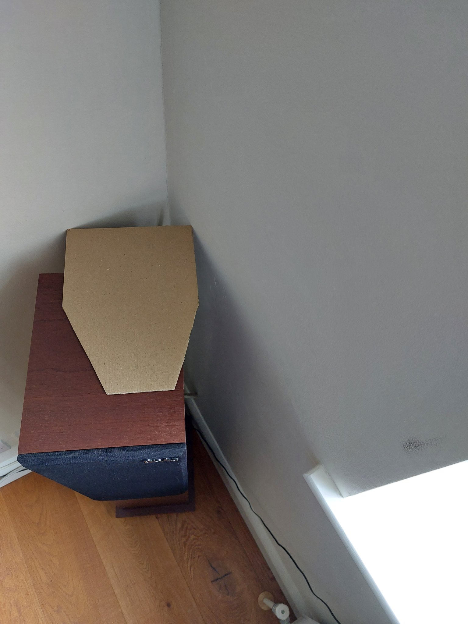

Should the cabinet front width be as small as possible to take the driver, like i think i see in Koldby and Wesayso? - or can it have space either side. if its free standing i can imagine a hexagon section would be similar to those but made of flat pieces..........
M
Or as you suggest a round something that aim can change, could possibly be laminated wood.
out of interest i took a pic of a 2 litre section sat on the proac in the corner........it can also be round with a baffle flat - for changing aim, plastic pipe?
M
Aimability is a good thing. You won't be sure of where to aim until you have something to listen to, which is a catch-22 re' a simple triangular or murphy style cabinet. A flat front, round back would work. It would be easy to build if you came up with a safe way to slice a plastic pipe. I would also suggest keeping the volume per driver small, say for a Qtc=1 instead of optimizing for maximum bass extension. You can make up the difference on the low end with EQ, extra amp power, and subwoofers.

If you examine or ‘take stock’ of your space and needs, you’ll find there’s no direct need for the design benefits of a line array, and far less from a corner built solution with wide horizontal dispersion. A pair of corner loaded horn based speakers with a 60x50 pattern would yield far better results in your space without the fuss giving you controlled directivity and point source imaging…..both ideal characteristics of small listening spaces.
I can give you my experience from living with my IDS-25 build for about 7 years and now dabbling in horns.
What I love the most about the line arrays is that anywhere I go, the sound is there. Stand up, sit down, side to side, other side of the room. I want play for the other side of the house and when I walk back to the listening room it doesn't murder my ears as I walk closer like my horns do.
I have been experimenting with line line arrays in a much different way than everyone else. I believe that good imaging is all about speaker placement. With that I've finally gotten myself to try moving them into the room. The location that worked best for imaging for me was 1/3rd of the way into the room. It's very extreme and easily 8 ft from the front wall. Wesayso's shading idea would probably be ideal with this positioning. It probably wouldn't need to be this extreme if I had effective room treatment. That's one of my future goals. My current project is to build a pair of woofer towers and row behind the couch with 16 x JBL 2226 drivers to better support the bass with the line arrays, especially with them that far into to room. I also plan to incorporate 2 JBL 2" throat horns with the line arrays to almost act like the hf shading that Wesayso is doing. I'm using a MiniDSP with Dirac and with basically set all of these speaker systems flat and them merge them all together in a very gradyal way, whether it be shallow crossover slopes or let that combined with Dirac reducing the sum of the speakers to flat.
