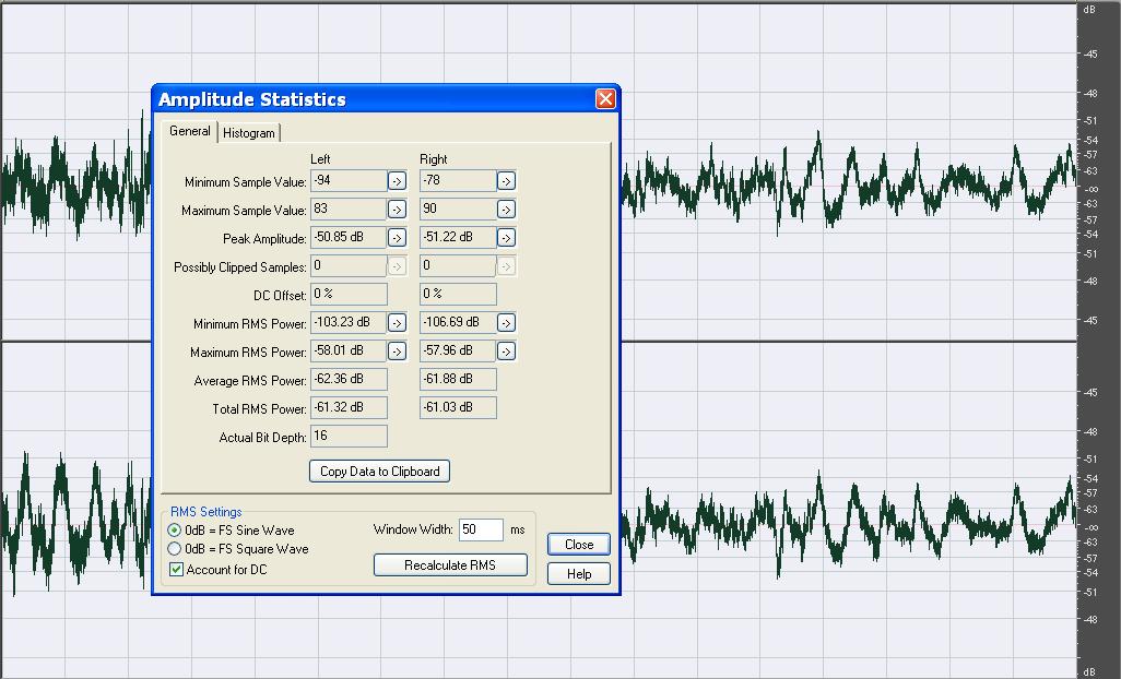

So, was the opamp testing data conversion at 16-bits or 24-bits? If at 24-bits, how did the test files get to be 16-bit?
The test files posted are in 16-bits. The reason is that the most silent part of the original track is about -60dBFS (attached), so there is no reason for 24-bits and wasting web space.
I am preparing a web page with more detailed description, but it will be posted on Friday afternoon when the poll will be finished. I would like to try to get something from the votes and not to disclose everything before the poll ends. Please feel free to upsample / resample to 24 bits in case your D/A converter works better then.
