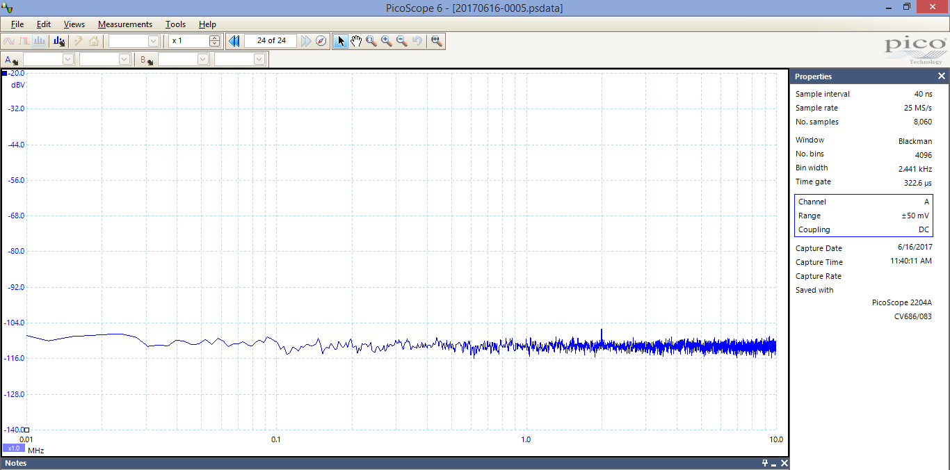

If, as is customary in these types of tests, we pull bb because of possible disclosure and bias, the three remaining are clearly indistinguishable. That is in itself is also an interesting and usefull result matching the measurements.

The measurable difference is also biggest between aa and bb, and audio diffmaker difference as well, though it is noise only and buried-in-noise mains components.
An input filter rolls of the high frequencies in the input signal and does nothing to the opamp.
I assume that it was the same for all cases.
The input filter does two things: it degrades sound quality and it increase stability. So it is not fair for a stable amp to have high input filter when the unstabke one needs it.
Imo, to be fair, each opamp should have their own circuit. Lm4562 and Opa2134 needs comp cap (across fb resistor) Tl072 does not.

Nonsense. Take a calculator and calculate -3dB frequency of the RC. Look at the frequency response measurements with wideband noise that I posted in my page.
BTW, no FB resistor there. You guys should at least check the page where I described and shown the test circuit. That is why the page was created.

Well if the statement shows clueless of the difference between comp cap and input roll-off, and then comment on a circuit that was not used, you know it's going downhill. Fast.
Anyway, kudo's to PMA for taking the trouble to set this up. I hope all the pundits here realize that this is not about someone's personal preference. Someone may feel happy because his preferred opamp 'won', but realize that for anyone that voted for your favorite, someone else voted against it.
Excluding bb for earlier stated reasons, it's about equal, within statistical errors, between the other three. What that means is that there is no audible difference between those three. You may not like it but that's how it is.
What I do hope is that a similar (or the same) test can be done with much higher signal levels to exercise large signal linearity and slew rate. That should also be interesting.
Also hope that people going to participate in any follow up test will be able to refrain from trying to influence others before the end of the test. Intellectual honesty and all that.

Yes, it can be done. At some realistic level, like 2 - 3 Vrms. And in 24-bits resolution, to prevent criticism, though I am sure it would bring nothing in this current test. If there are people interested in a new test, I can do it. At least I am able to assure correct technical conditions 😉
