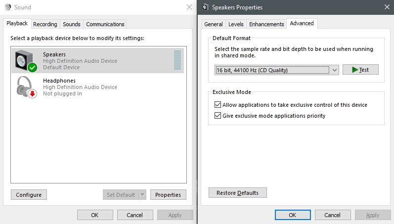

If anybody is trying to listen on Windows and not using ASIO drivers, to avoid sound quality degradation by Windows due to automatic sample rate conversion, it's necessary to go to the control console sound settings, and set the default sound format to 16/48, since that's the format of the test files used in this thread. See image below for reference which shows the default setting:

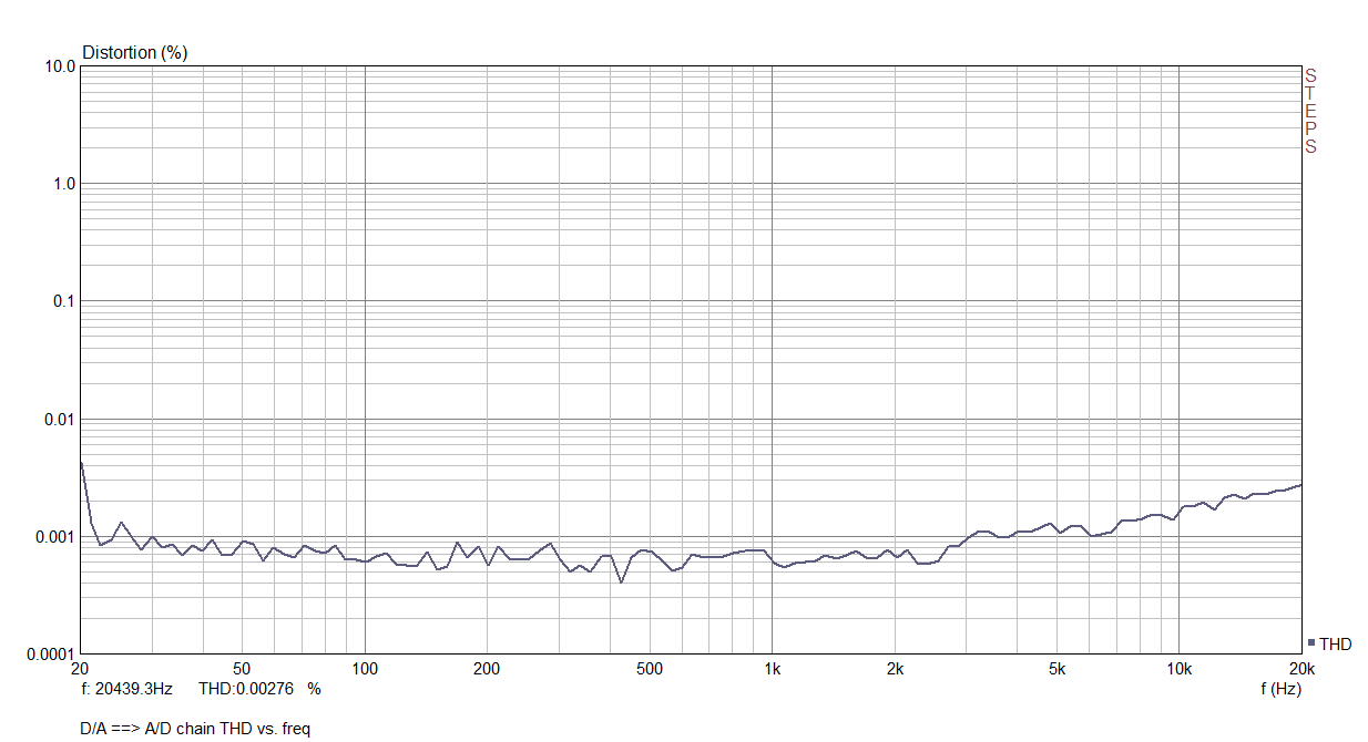

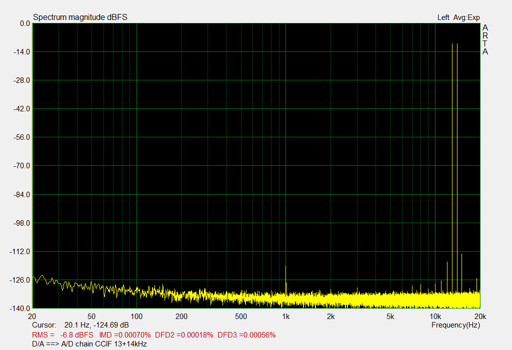

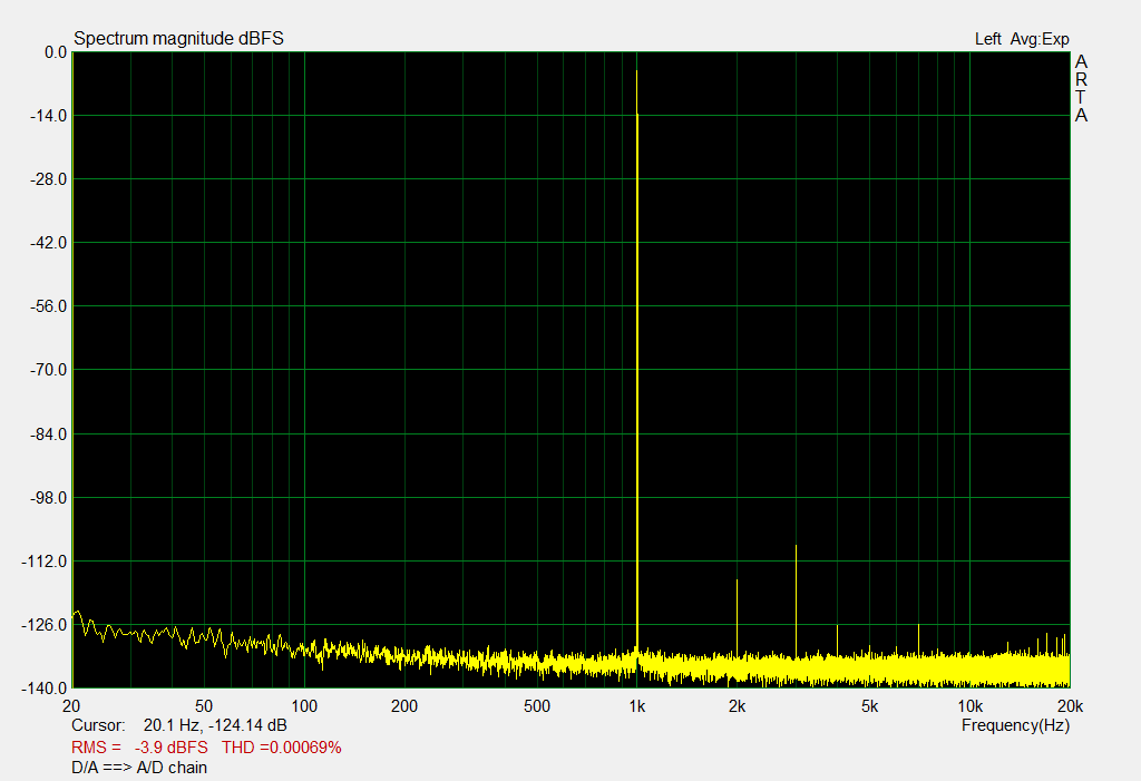

There were some speculations about distortion originated in the D/A ==> A/D chain in this test. Therefore, I am attaching basic measurements of distortion in the chain.
Second, I have created 4 difference files in Audio Diffmaker, they cover all 4 opamps used. The files can be downloaded from
http://pmacura.cz/optestdiffiles.zip
Once again I would like to repeat that direct subtraction is a poor idea, because of small time/phase shifts that get magnified as frequency is increased. Please take into account that you do not listen to direct sample values, but the signal created by the reconstruction filter. Thus, information of sample amplitude difference is meaningless.

I can see only 3 attached image files apart from the zip diff files. Two spectrum with test tones and one THD. Was there a there a spectrum control with no test tones taken? That is, a spectrum of the noise floor looking only at the testing chain internally generated spectral components?
