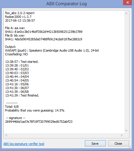

great result 🙂. So I took your hint and used one of the worst headphones I have here, JVC I bought at the Manchester airport 2 years ago at some 15 GBP (remember when I called you from Manchester?), and immediately got better result
Code:
foo_abx 2.0.2 report
foobar2000 v1.3.7
2017-06-13 13:38:57
File A: aa.wav
SHA1: 81e0cc3b0146df3562d4421385098251239b3789
File B: bb.wav
SHA1: 4da5d9045285da07488f69c24cda9187be2882c9
Output:
WASAPI (push) : Speakers (Cambridge Audio USB Audio 1.0), 24-bit
Crossfading: NO
13:38:57 : Test started.
13:39:28 : 01/01
13:39:40 : 02/02
13:40:03 : 03/03
13:40:44 : 04/04
13:40:54 : 04/05
13:41:16 : 05/06
13:41:30 : 06/07
13:41:39 : 06/08
13:41:39 : Test finished.
Total: 6/8
Probability that you were guessing: 14.5%

Still not sure what it means and I doubt I could make it repeatedly, however I agree that the worse the system, the more we "can hear" component changes like swapped ICs etc.
