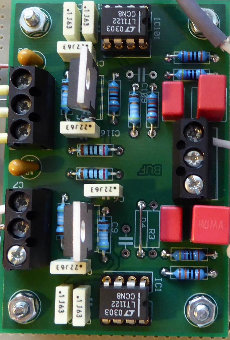

Next, from the look of the circuit layout it has quite few problems. The power supply pin decoupling capacitors have ceramics close and electrolytic far away. Also they are in parallel which creates a high Q tank circuit which is not good for damping any impulse response and subsequent feed or re-feed back into the supply pins. PSRR and what you think you will not hear in the noise floor is unbelievable.
Also the ceramic you chose was a ferroelectric type and not a NPO or COG type? Is this correct? Big no no for audio to use ferroelectric ceramic decoupling anywhere in audio.
Next is there a star pattern or solid ground? Perhaps not an issue so much with audio, but in mixed signal with noisy digital stuff around one needs to think about layout and noise contamination.

Thank you for your feedback. You might like to check my web page, especially re discrete circuits etc.
Pavel Macura audiopage
Yes OPA627 is a very nice part. I have been using it very often both for instrumentation and audio since about 1993. For example in the circuit as per photo attached (though LT1122 is there). And in many preamps as well.
Do you support your claims about bypass capacitors with measurements as well?

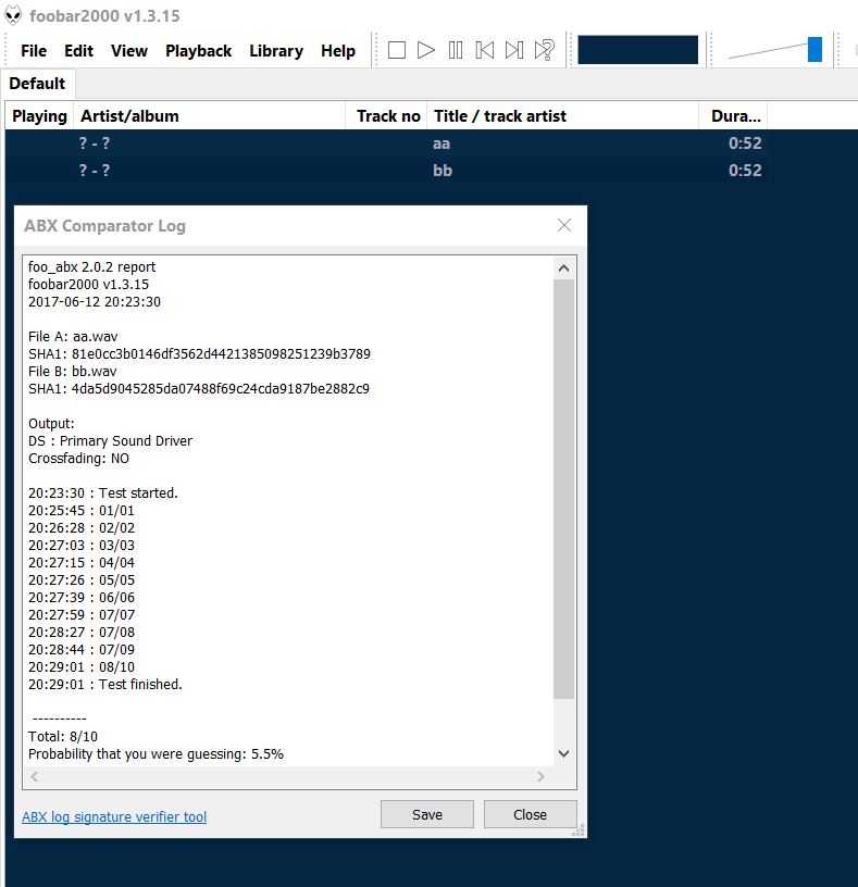

I am glad for every vote and opinion. But I would also appreciate if anyone would post a result like this
regardless the result. I know that the ABX is not popular, but it is the only way how to prove audibility.
Code:
foo_abx 2.0.2 report
foobar2000 v1.3.7
2017-06-12 20:29:10
File A: aa.wav
SHA1: 81e0cc3b0146df3562d4421385098251239b3789
File B: bb.wav
SHA1: 4da5d9045285da07488f69c24cda9187be2882c9
Output:
WASAPI (event) : Speakers (Cambridge Audio USB Audio 1.0), 24-bit
Crossfading: NO
20:29:10 : Test started.
20:33:02 : 01/01
20:33:21 : 02/02
20:33:36 : 02/03
20:33:51 : 03/04
20:34:02 : 04/05
20:34:27 : 04/06
20:34:39 : 04/07
20:34:55 : 05/08
20:34:55 : Test finished.
Total: 5/8
Probability that you were guessing: 36.3%
