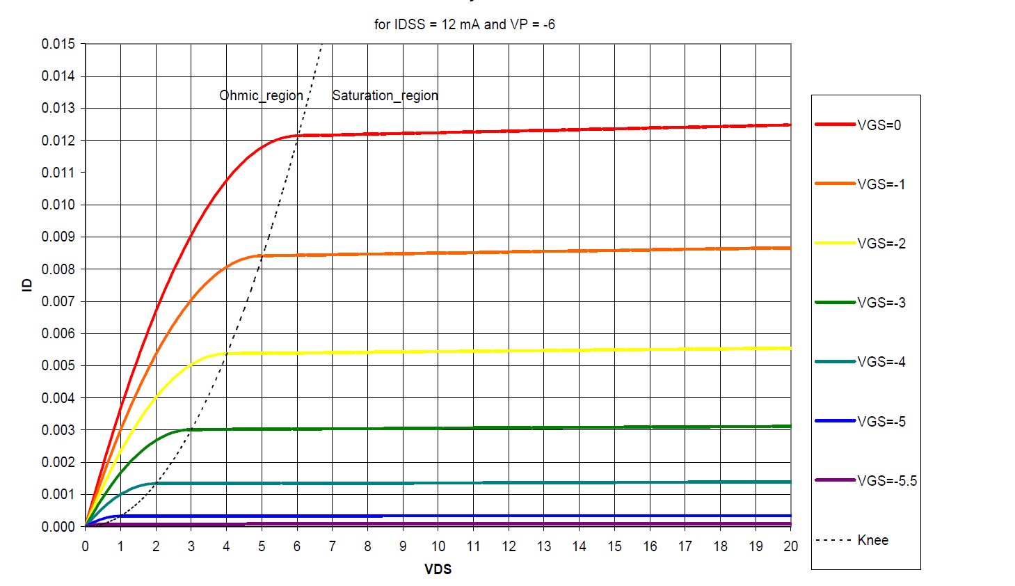

Andrew , sorry but something I can't grasp is how the VDS affect IDss.Yes it does change ID but once VDS meets or exceed the 2 times V-Pinch off ,current plateau and then until IDss it stays in saturation region.
So regardless how much more VDS one applies 25% of IDss , so for example mine are mostly in 15ma IDss BF862s, 25% of which is close 3.5ma. It only falls at Ohmic region of IDss -VDS plot.
So at more than 2 V pinch off the current can not be 25% of IDss.
What I understand is for a given Vgs, ID can not be 25% of IDSs once VDS exceeds V pinch off. It will be at least 75% of IDss .

Since you have plotted values on one curve I'll use the same curve for this example.
The middle curve shows Id ~17mA when Vgs=0V
When the Vgs is increased to -0.2V the current has reduced to 10mA
If we go up to -0.4Vgs, the current is now ~4mA
That tells you that for a 17mA Idss device you need to apply ~ 0.4Vgs to the device to set up a 4mA bias current.
Now look at the right hand plot and see if that confirms what I have just read off the Id vs Vgs graph.
We know that the Idss is measured when Vds is at 10V.
Look at the bottom and find 10Vds.
Go up till you reach the -0.4Vgs curve. Now read off the Id. Could be ~ 4.3mA
Pretty close.
Now go and measure your device at 4mA (Pq= 40mW, it will get slightly warm so results will not be identical to the datasheet). What Vgs do you need to apply to get that 4mA?
Now reduce the Vds to 7V, just to compare to the hypothetical example I started with yesterday. What Vgs is required to get 4mA when Vds = 7V?

Andrew,
I am not understanding why you are asking about a different VDS at a given VGS.
ID = IDSS * [1 - (VGS/VP)]2
ID has no relationship with VDS.
At saturation region IDS is not affected by VDS. It can be a VDS of 8V or 10 V or 12 V, IDs is only related to VGS.
So to answer your questionat 7v VDS it still need a VGS of -0.4V if you want to have an IDS of 4ma.
Since the IDS has a slope in real JFETs, there might be small changes in Vgs needed but it is still the same VGS.
Going back to my previous inference that ID you suggested is still in ohmic region of VI curve.Then yes VDS will affect the ID.
this is from page 30 of Borbely's article that is attached here.
The Transconductance Curve
As mentioned previously, you can use the JFET as an amplifier in the pentode, or
saturation, region. Here the VDS has little
effect on the output characteristics, and
the gate voltage controls the channel current ID
Look at the slope on those curves. It small but detectable.
Even you have stated:
Now look back at the BF862 data you posted, the slope is enormous by comparison.
Borbely tells us
The slope on the jFETs is similar to Early voltage in a BJT.
Borbely tells us
Don't you believe?As mentioned previously, you can use the JFET as an amplifier in the pentode, or
