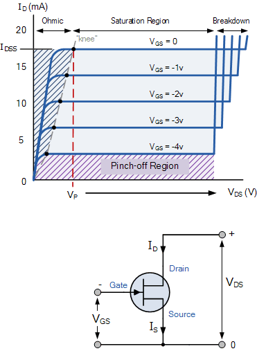

For Jfets the Zero-drift VGS is about 0.8V above the pinch-off (Vp)Voltage. Feucht names that zero drift VGS as VGSZ.
It is also the point where ID traces at various temperature intersects in transfer characteristic plot. Please refer the article attached.
(Pinch off voltage is the drain to source voltage after which the drain to source current becomes almost constant and JFET enters into saturation region and is defined only when gate to source voltage is zero.)see the picture attached.

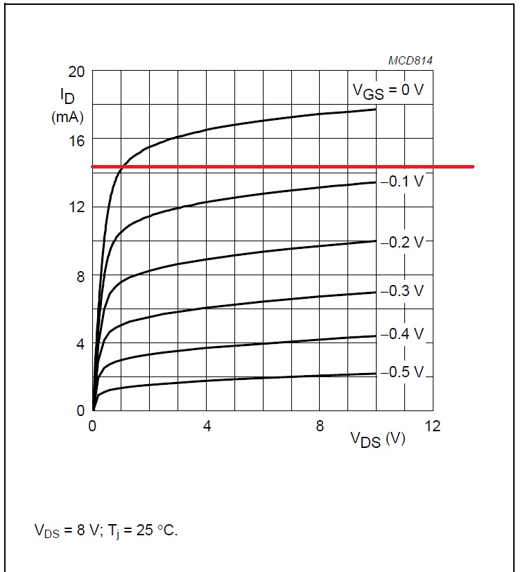

This is my calculations for BF862. Please correct me if you find it wrong.
Unfortunately for BF862 transfer curve with ID at different temperature is not available in datasheet.
But V-I curve is available. Id range for BF862 is between 10-25ma. I would limit the current at 12ma.
From the ID -VDS plot ( See attached) Vp= 1V ,so VGSZ=1.8V
Source resistors for each Jfets 1.8V/12ma= 150 Ohm.
I think keeping Id close to ohmic region( before Vp) in V-I plot ,will have linear output characteristic when used as a audio buffer.
Just having lunch.
Ohmic region is of no benefit for source follower buffer.
Please explain why? Actually what is the benefit in running at saturation region?
PSRR.
You're not looking for voltage gain so Ohmic region offers no benefits for follower.
Ok. No voltage gain. But there is no voltage gain in saturation region either. 2SK270BL has max IDSs 12mA. So why should we run BF862 at 16 or 18. When we use two in parallel even more 30-32 mA in Patrick's design.
Please explain how running in saturation region will improve PSRR.
Because it is a single ended design, and Patrick wants the circuit to drive anything with good results, eg Hockey Puck Amp.
This requires low output impedance and much more bias current than a push pull circuit.
This is something you can work out just by looking at the graph.Please explain how running in saturation region will improve PSRR.
I looked at it few times ,they say eyes won't see if mind don't know already. So please enlighten me. Or point me to somewhere where I can learn more.
No need.
You have a graph of Id vs Vds.
In the saturation region (let's assume textbook pentode curve) what happens if Vds fluctuates?
