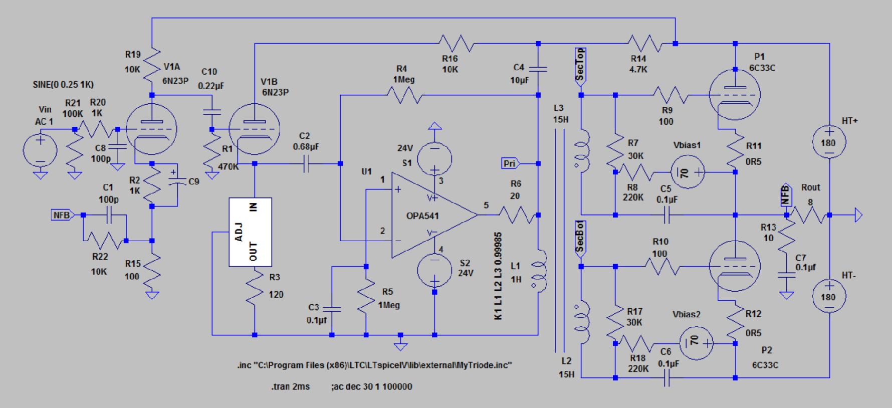

You are referring to this schematic, correct?
Hence, now there is C4 on your circuit since you are translating the op-amp on the tubecad directly to the op-amp on my circuit.
However, on my circuit, i translate the op-amp on tubecad's circuit as the whole amp, starting from the op-amp, interstage transformer and up to the output stage. So, the capacitor (C1) on my amp does not attach to the op-amp output. It attaches way further back to the speaker output of the 6C33C output stage. This means i am enveloping the whole circuit in the negative feedback. Of course this raises question about stability as i asked way back on my first post.
The C4 in Koonw's circuit makes just the front end act like the emulation triode. Leaving it out makes the whole amplifier act like the triode, via the global feedback from C1.
Broskie's circuit is using the Op Amp as an I to V converter. While Ballpencil's circuit is using the op amp as a V to V amp. In the Broskie case, the triode is constrained to maintain dVp/dVg as Mu, to maintain constant current to the Op Amp. In Ballpencil's case, the triode provides dVp/Mu at the cathode, which must match the voltage at Vin. So dVin = dVout/Mu. Both giving the same result (if C4 not there), other than the gain restriction on the Op Amp in the Broskie case from the 1 Meg local feedback path to get I to V conversion.

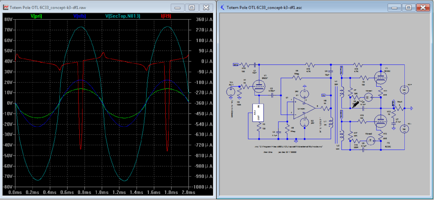

"Nope, the capacitance theory advanced by Smoking Amp is shot down."
Not quite! See Koonw's results below. The big current spike is obviously grid current. The little current peaks at crossover are from the global feedback making up for the low gm of the tubes at crossover by increasing the drive swing temporarily. This excites the Miller effect temporarily to give the small current peaks.

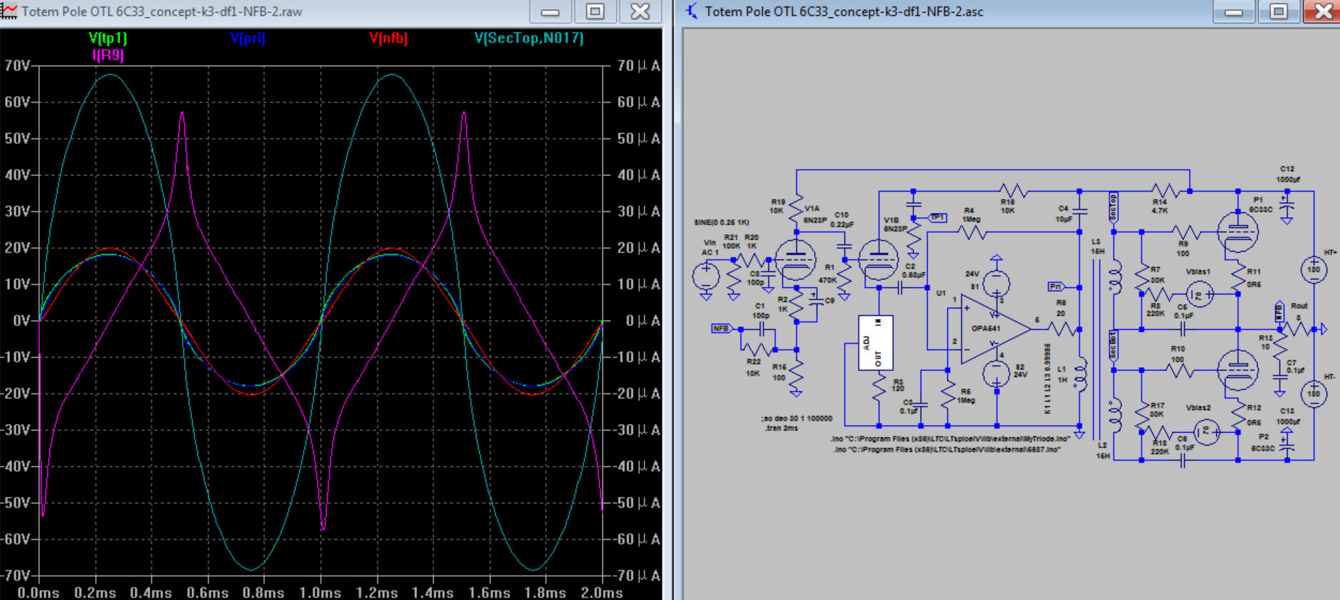

Here are 3 snapshot of my new schematic sharing any discussion.
1) The driver now is constant voltage limiter/ driver.
2) There seen no more significant grid current as driver voltage just barely touch the zero point clipping flat but no further.
3) Why? Already excited? Try to play with sim. it's really quite fun.
Welcome any comment.

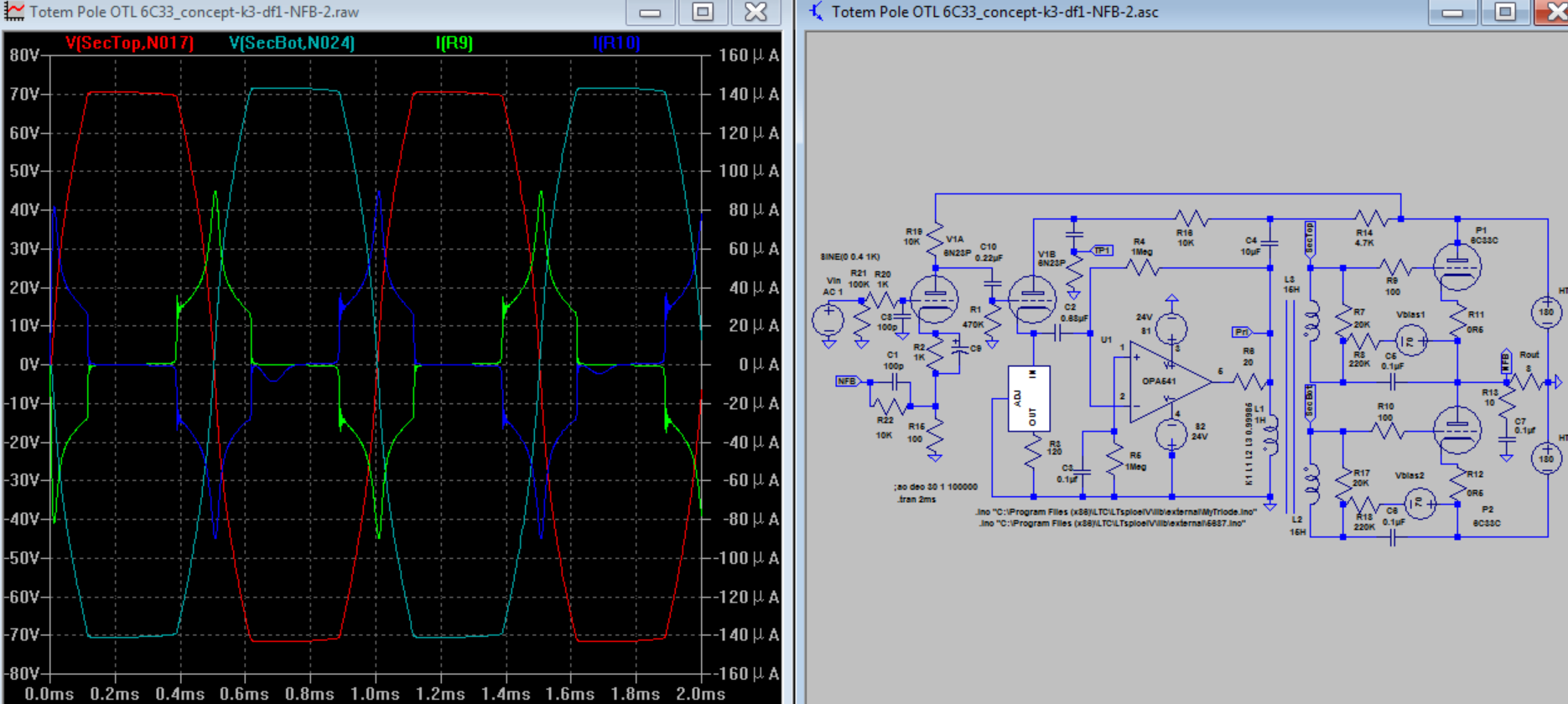

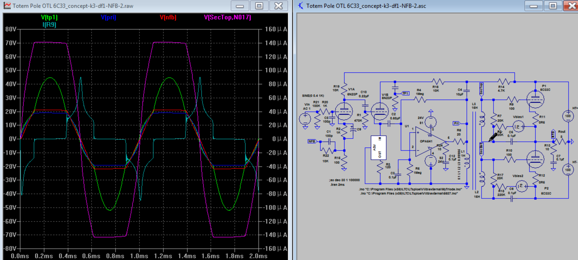

Add this to earlier note:
4) Reducing R17 and R27 inductor load resistors from 30K to 20K eliminated the extra grid current spike.
