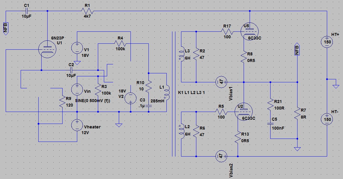

Want to spend more on your electric bills? Need a way to make a chipamp have much worse efficiency and lower output power? Attached schematic might help you achieve those goals 😀
Basically a chipamp fed to a dual primary toroid transformer (24V to 110V+110V, 24v secondary as input from chipamp) driving totem-pole 6C33C output stage, wrapped in super-triode connected GNFB.
It gives you 16W output while dissipating about 220W for single channel. Maybe it's the 6C33C model i'm using but some say at Vg=0 and Vak=150v, 6C33C might give 2.5A current, which translates to 25W to 8 ohm.
Chipamp shown is OPA541 which is unity gain stable. You can, however, use the more ubiquitous LM1875 or TDA2030 family since the chipamp itself is making more than 24dB gain.
The toroid model is also still too perfect, with no winding resistance, inter-winding capacitance and leakage inductance. Main question is how stable it is, wrapping GNFB around such "inter-stage transformer".

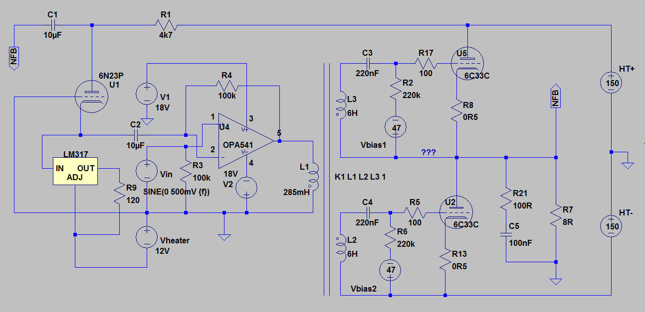

Attaching the asc and inc (changed to txt) file, i am hoping someone with better skills in LTSpice could simulate a more real-life condition and check the stability.

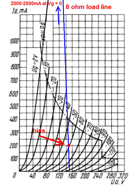

The maximum dissipation allowed in a 6C33C is 60W per tube. Therefore with your HT voltage the maximum allowable standing current is 0.4 Amp. This allows a maximum signal of 0.28 A RMS. The maximum power into 8 ohms is thus 0.63 Watts not 16W.
Totem pole and SRPP tube amplifiers require high impedance loudspeakers. For 2 x 6C33C, about 200 ohms would be right, ie 4 times Philips 800 ohm drivers in parallel, or 7 x 32 ohm drivers in series. Series operation requires driver matching. Cone resonance can vary +,- 10% or more, leading to poor control over resonance.

You show an op-amp driving a transformer directly. This is bad practice. Inherent offset voltage in the op-amp inputs, amplified by the circuit configuration, will result in a heavy DC current in the transformer primary, saturating the transformer core and possibly overloading the op-amp.
What is tube U1 supposed to be for?
That 3-term regulator is a sitting duck.
Those 0.5 ohm resistors are not going to do anything. 6C33C has a gm of 40 ma/V. Therefore the impedance looking into the cathode cannot be less than 25 ohm.
The zobel network on the output is incorrectly sized. The idea of such networks is to make, as far as possible, the circuit see a resistive load at supersonic frequencies, and not the rising inductive impedance of the loudspeaker. Therefor the resistor should be the same as the loudspeaker rated impedance. This sort of network works better at improving stability if a choke is placed in series with the loudspeaker. The optimum capacitor size is then more independent of just what speaker you have connected.

Those amps are not designed to run the 6C33C with the usual loadline where we stay within limits of max Power dissipation. Here we are idling at around half P-diss which is 30W (150V Vak @ 200mA) and will be subjecting the tubes to an almost vertical loadline (the load is the 8-ohm speaker). With that nearly vertical loadline, we are shooting way up to at Vg=0 where we expect to reach 2000-2500mA of current. Peak current of 2000mA equals 16W to 8R speakers. Sure we will greatly shorten the life of those tubes if we run sine wave through them constantly at 16W but music is not like that.
I won't argue if you state that OTL is abuse to tubes, especially with the low impedance speaker nowadays. This is probably the reason why we don't have many OTL tube amps. Those running OTL amps are probably ready to replace the tubes regularly.
It has to be power op-amp as the low inductance of the secondary winding will be asking lots of current.
It is the feedback part where we are feeding the negative input of the power opamp with signal mu times lower than the output signal going to the speaker. See here:What is tube U1 supposed to be for?
Ah sorry i didn't read this part properly.
There is no offset voltage in the op-amp inputs, thus no offset on the output. The negative input is tied to the output via 100k resistor to check the output offset while the positive input is tied to ground.
You are correct on the zobel network. I mistyped 10R to 100R.
That 3-term regulator is wired as Constant Current Sink of around 10mA.

But you are taking the output of an op amp direct into a transformer winding, in which we can expect a vary low DC resistance, so a much greater DC current.
That's not what your circuit shows.It is the feedback part where we are feeding the negative input of the power opamp with signal mu times lower than the output signal going to the speaker.
This is the main idea.
The output gets fed to the plate and comes out from the cathode attenuated mu-times lower.
The difference is that my input signal goes to the non-inverting pin.

It is a CCS on the cathode, doesn't it mean that point is high impedance? Cathode would move along with the signal since the CCS is trying to maintain constant current.
The opamp provides a virtual ground, acting as an I to V converter. The actual AC voltage at the input is essentially zero. Remember, in the limit of infinite gain, the two input terminals of the opamp must be at the same potential. So the CCS doesn't change that, it just means that current variations through the tube are translated (more or less) exactly into current variations into the virtual ground, which are then translated exactly into voltage variations at the opamp output. The feedback resistor determines the transformation ratio of amps to volts.
