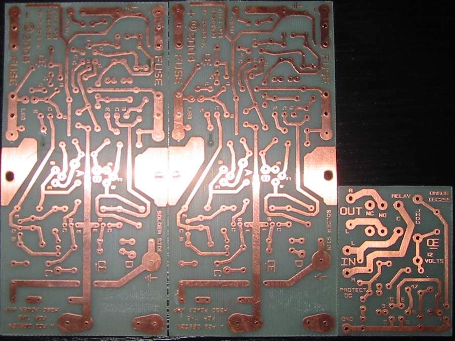

For any persons Interested, I have Cleaned up and Re-Drawn the Schematic.
http://www3.telus.net/chemelec/Projects/Misc-PCB
I Agree with: amplifierguru, Especially on the Supply Rails.
The Amp that I Designed and currently use is Less Power than this one and I used a Decoupling circuit on its supply rails.
So I plan to make a Few Revisions on this one in the near future.
Probably also a revised board at some point.
But it is Becoming Gardening Time so that may be awhile.
Take care...........Gary

My Number was 66 , So I Believe "csl113" has won these Boards as his number was 56.
I Don't want to screw-up on this, So can someone else chech the past postings and Varify This.
PS: I Also Believe those drivers work in AB.
Take care............Gary

Those Boards were Mailed to "csl113", Yesterday.
Hopefully he will get those amps assembled and post his results on here.
