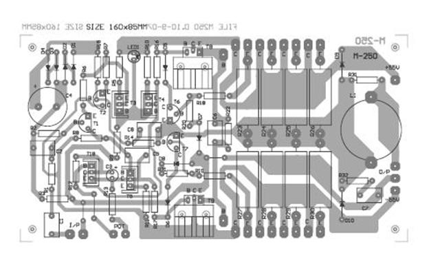

I have a question about idle current. After turning on the amp it was about 45ma it started to rise up. Couple of times in 5-6 minutes i had to decrease it and at the end it stopped at 95ma. Without turning pot it would be much bigger. Then i have noticed that pre drivers are getting hot. Not like burning hot. So i ask does their heat sink has to be bigger?. Here is the picture.

geminni, Another question about pre drivers. Why are they designed to be on board? All EF (emitter follower) design has pre drivers mounted on main heatsink.
NOT TRUE!
I haven't actually built this amp myself, But quite a few others with simular output power.
And on all the amps I have made the Drivers go on the circuit board like this one.
However there are point to be made for both methods.
I also didn't design this amp.
I just did up a circuit board for it as requested by some other persons, following the origional pictures of the amp.
And the drivers were not on the heatsink in those photos.
As to your other question about the idle current.
I do not know What heatsink your using on the drivers, But with a Suitable Extruded aluminum heatsink on the PCB, it should be OK.
It also sound like your idle current is excessive for some reason.
Hope this Helps......Gary

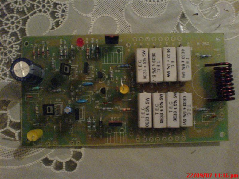

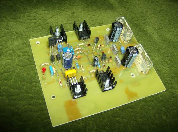

On my previous picture the drivers are on the circuit board. After posting it i have made some changes by putting drivers on main heat sink. Well, having done something really stupid made me think to test it tomorrow. I was tired so i reversed + and - and got one burned resistor 🙂 No transistor burned out! Maybe because i put 33ohm/17 watt resistors in both + and - rails 🙂 That saved my amp 🙂
The poles are staggered wrong, supply is 1hz (4R), feedback is 9.6hz, input is 3.3hz. Change feedback cap to 470µF, 4.5hz. Change input cap to 1µF, 7.2hz. Input pole must predominate, feedback pole must be between input and power supply poles. If not staggered properly amplifier will ring at infrasonic frequencies when clipped, very hard on woofers and very poor sound quality. I would also consider doubling the current in the second voltage amp, you could be running out of drive current at low impedance. Looks very nice!

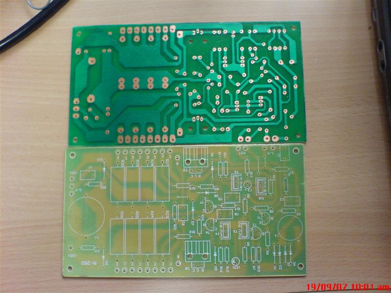

I have a PCB layout for this ...do let me knwo if any one wants it...
A very professional looking PCB
Attaching a preview of it...All you need is to get the components and Solder it....
Enjoy

MY PCBS's are ready
Hello Guys,
Have a look at the PCB's ....dont they look Gorgeous [😛]

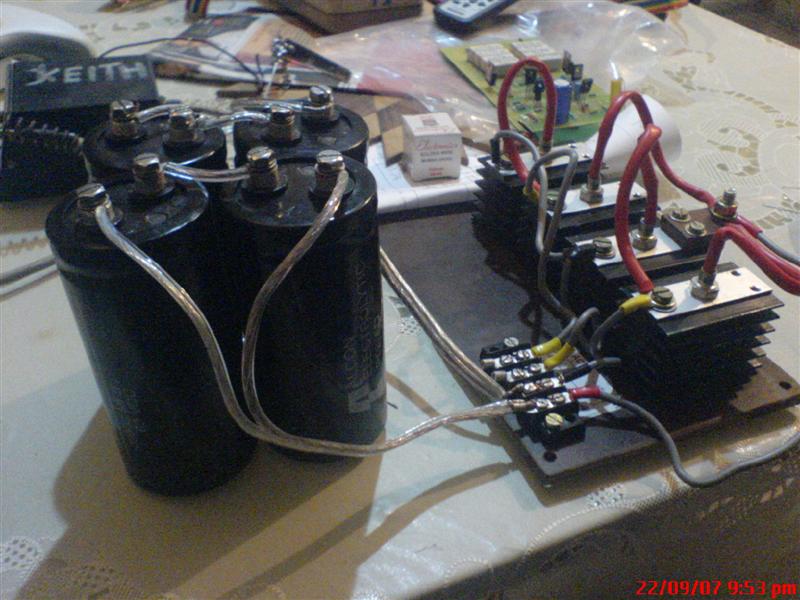

I am getting sad each day, as the size of the AMP seems increasing. The second snap attached is the rectifier circuit with heat sinks for the DIODES and then the 4 capacitors take seperate space than the board.
And i have 2 MASSIVE tranformers (Non torroidal) of Six inch by Six inch by six inch. and they weigh 20KG's together.
I feel its gonna be an ugly looking Giant power Amplifier ...

The baords I got it done from a small scale production guy. I gave him the layout on plastic films and he did the rest for me.

I got these 4 HUGEEEEEE 22000 mF capacitors. Am wondering if i can use only 2 instead of 4 ?
