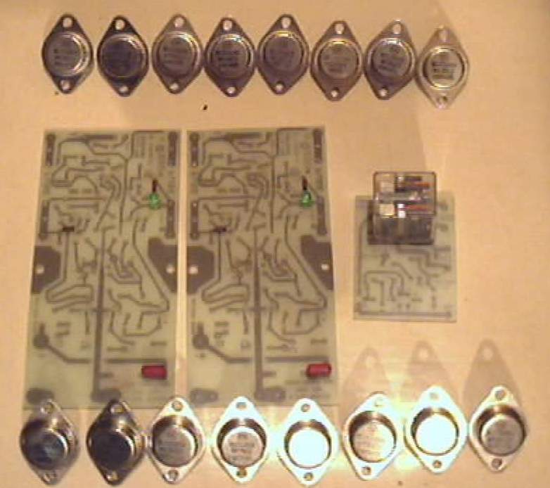

I finished building the M250 a couple of days ago, was my first amplifier and I'm quite happy with it. I just got a question about the setting of bias current. I try it with a light bulb in series with the ac line, I can't reach the recomended setting of 1.8 mA, the amp iddles at 1.92 mA across T3 and when I want to reach 1.8mA the light bulb goes a lot brighter so I left it just in the threshold. Is it normal for the amp to be correctly biased to draw much more power or I have made a mistake ? Is the first truly analog design I build so I'm not to familiar with bias setting in an amp, I'd apreciate any help, I tryied to research on the web but failed to find a good explanation about how to set the bias, just specific instruccions for diferent amps.
M250 bias adjustment
One more thing: I'm working the amp with +/- 42 Volts rails. Does that change bias settings ?
I Haven't actually Built this Amp as I use another amp that I built many years ago. But I did design a PCB For it.
Curious, Are you using the PCB I Designed?
Did you also make the DC Protection Board?
** I would definately Recommend it for protection of your Speakers.
I am also not sure What effects your 42 volts will change, compared to the suggested 55 volts.
But A few Questions for you.
Are you using a GREEN LED as Recommended on the Schematic?
Different Colored LED's have Different Voltages.
And even the same colors can have some voltage variations.
This could result in why your brightness goes so high.
The higher Brightness Could be Also that you just have just used a "Bright LED". So the higher Brightness Might be Normal.
One Last Comment:
As long as your Output Transistors Stay Fairly Cool when the Amplifier is running for long periods of time with no actual sound being amplified, It Should be OK.

I buitlt the M250 to replace the power amp section of an old Peavey Mark III Bass Guitar head, I've been playing with it for about 2 weeks and I'm really happy with it, it has a good bass response. On the first gig I noticed that the heatsink was getting too hot so I made a hole in the cabinet and installed a fan I gutted from a non working PC power supply and now it works completly cold.
I hevent built the dc protection yet but I'll for sure as soon as I have a few days off, good speakers are expensive.
