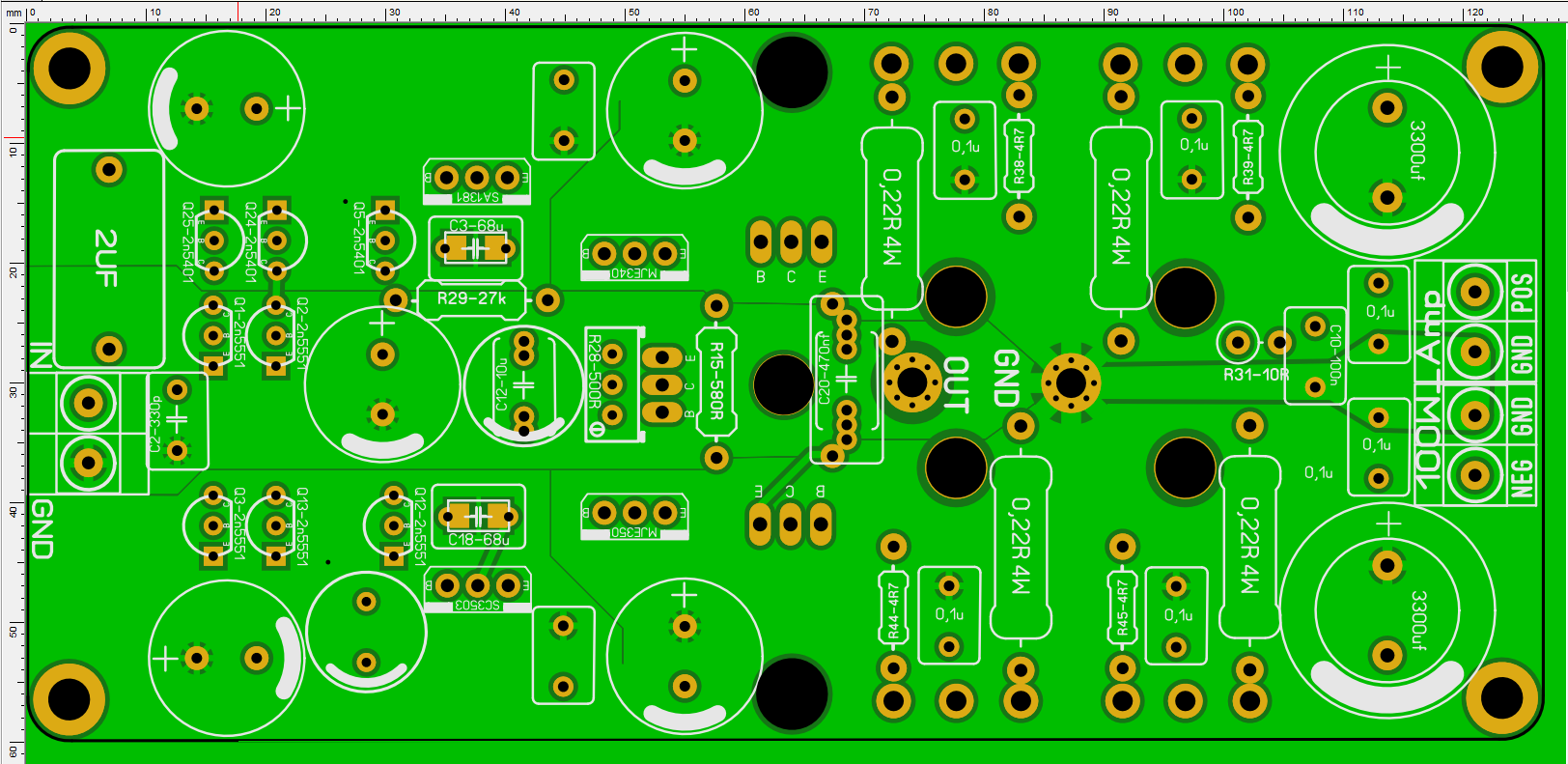

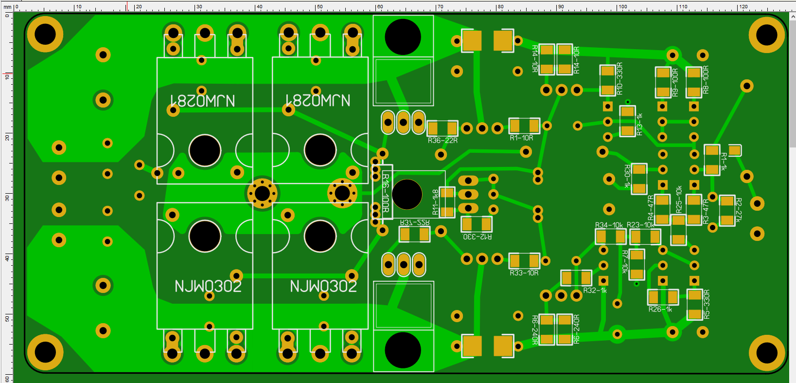

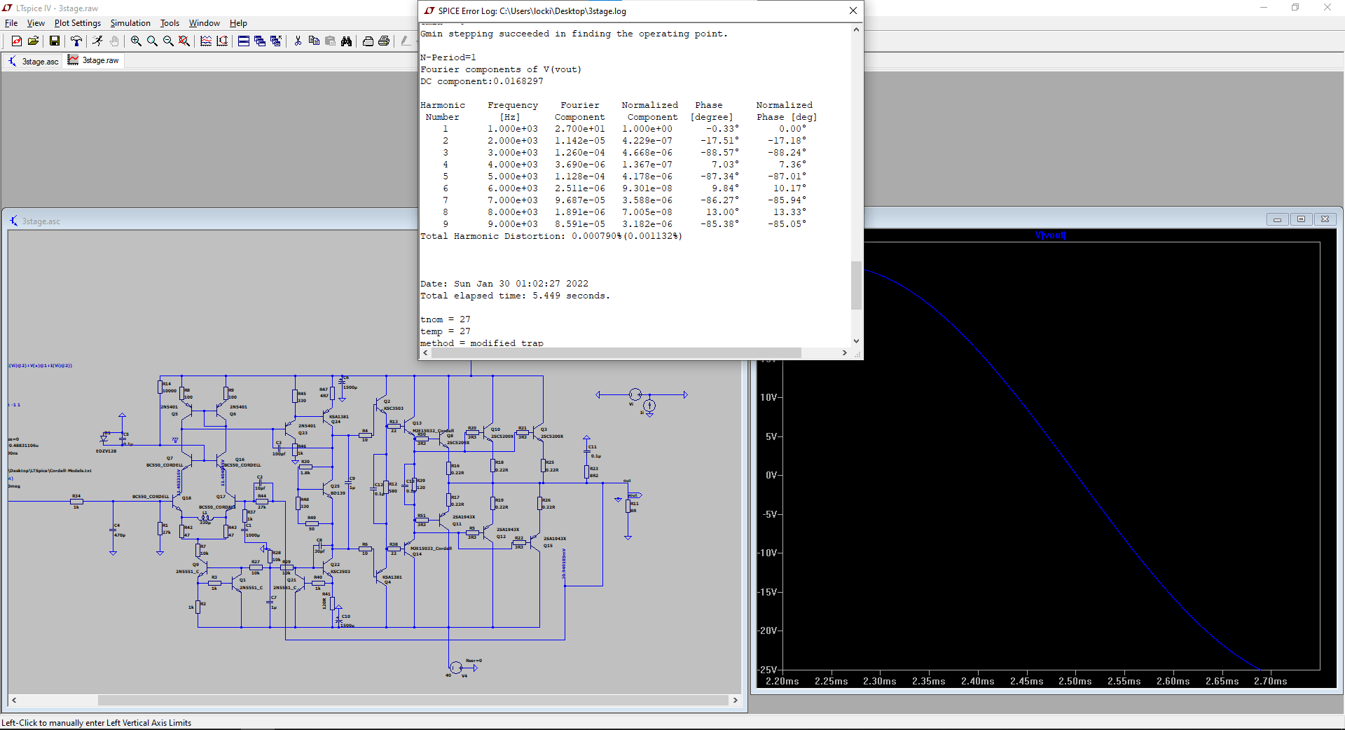

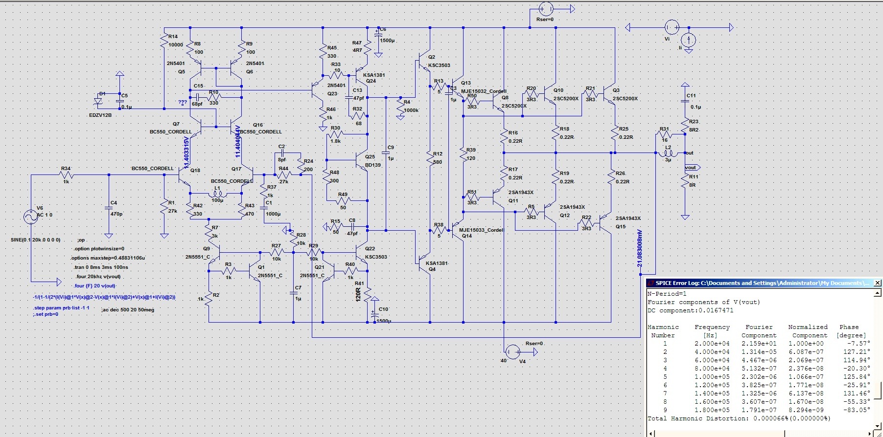

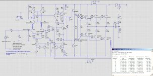

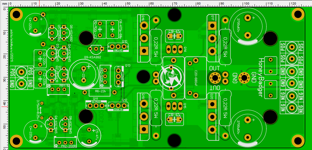

Another 100W hifi amp
I tweaked it a little...
So, no thoughts on my questions?

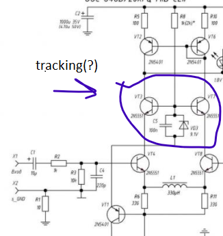

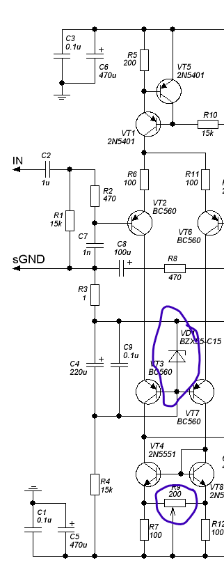

the honey badger has twin transistors at the output, but this one has three
there (mje340+mje15032+mje0281) should be less distortion on the 4 ohm acoustics...?

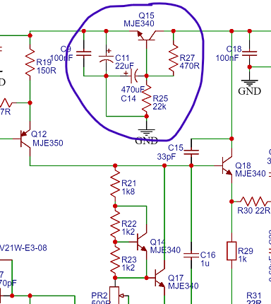

I would also like to add this (I highlighted it on the diagrams, I don't know what it's called in English). There will be such an easy improvement. But I don't know how to calculate tracking(?) into the differential cascade
