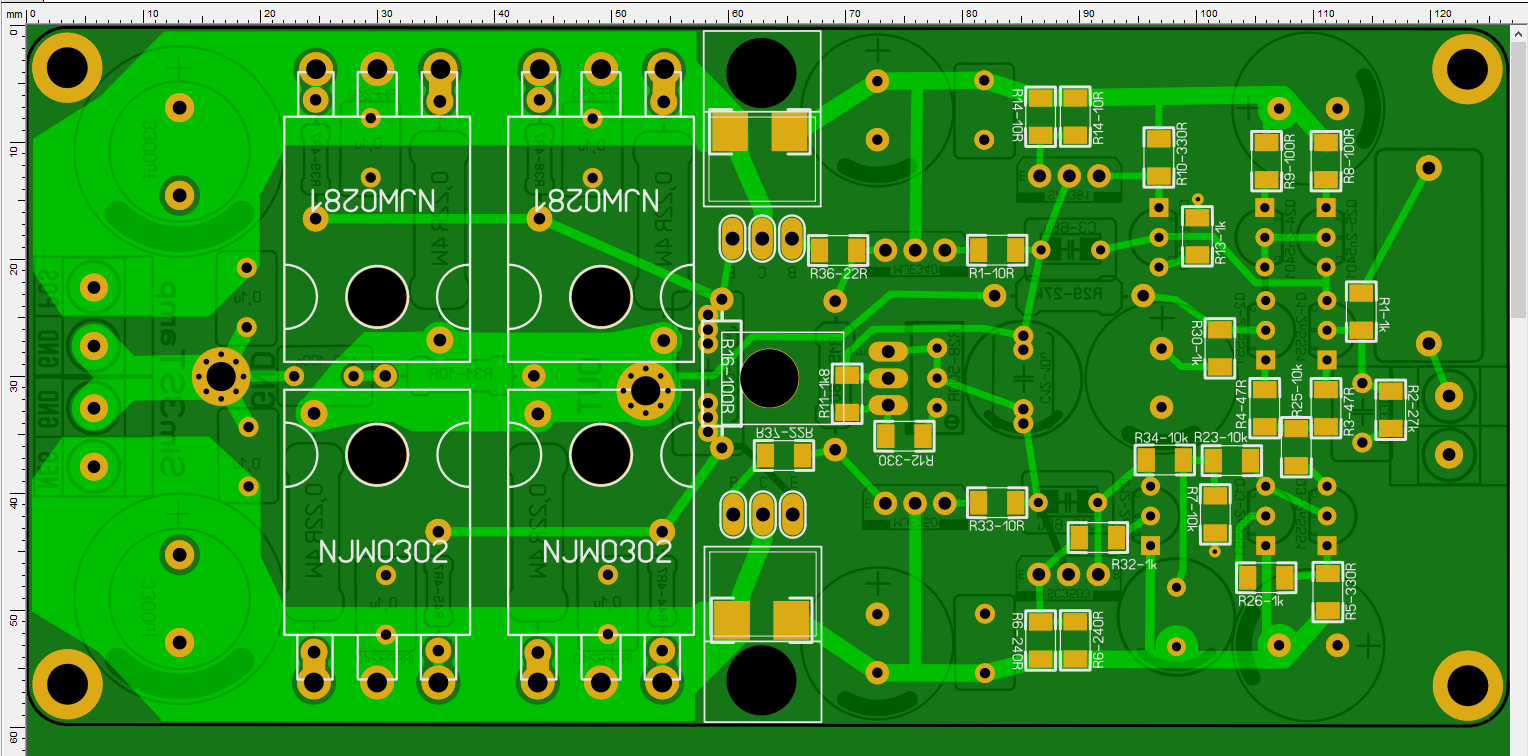

After successfully building my 250W amp, I designed it's low power version with some improvements. as 100W is sufficient enough for home use I removed two output pairs from 4 lowered the rails a bit, now we have a decent 100W into 8 ohm amp.
Simulated it in multisim, and below are some figures:
Supply voltage: +/-50V DC
Power output: 135W into 8, 260W into 4ohms
THD20: 0.005% @ 135W into 8 ohm load
THD1: 0.001% @ 135W into 8 ohm load
I designed the PCB in sprint layout, got them manufactured locally along with the power supply PCBs.

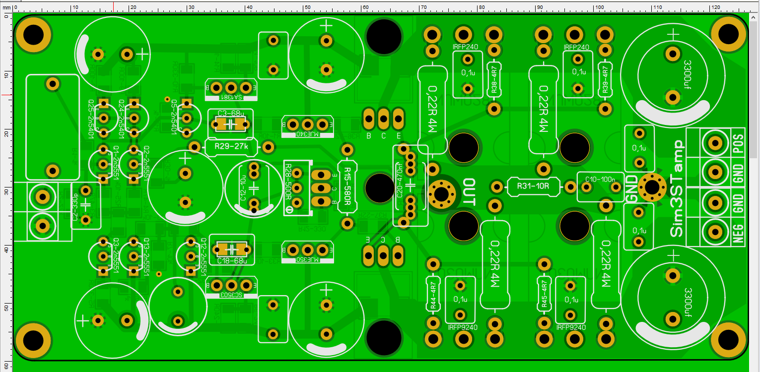

Version 2 boards, double sided 160X80mm
Hello Aniket , Nice pcb where u got that pcb. I have few silly Questions
1. Can we use 5200-1943 as Output transistor.
2. How many maximum pairs used as output transistor for more power.
3. Bias specification.
4. Any delay and protection circuit
5. PDF file or sprint layout of 2 Version double sided pcb.

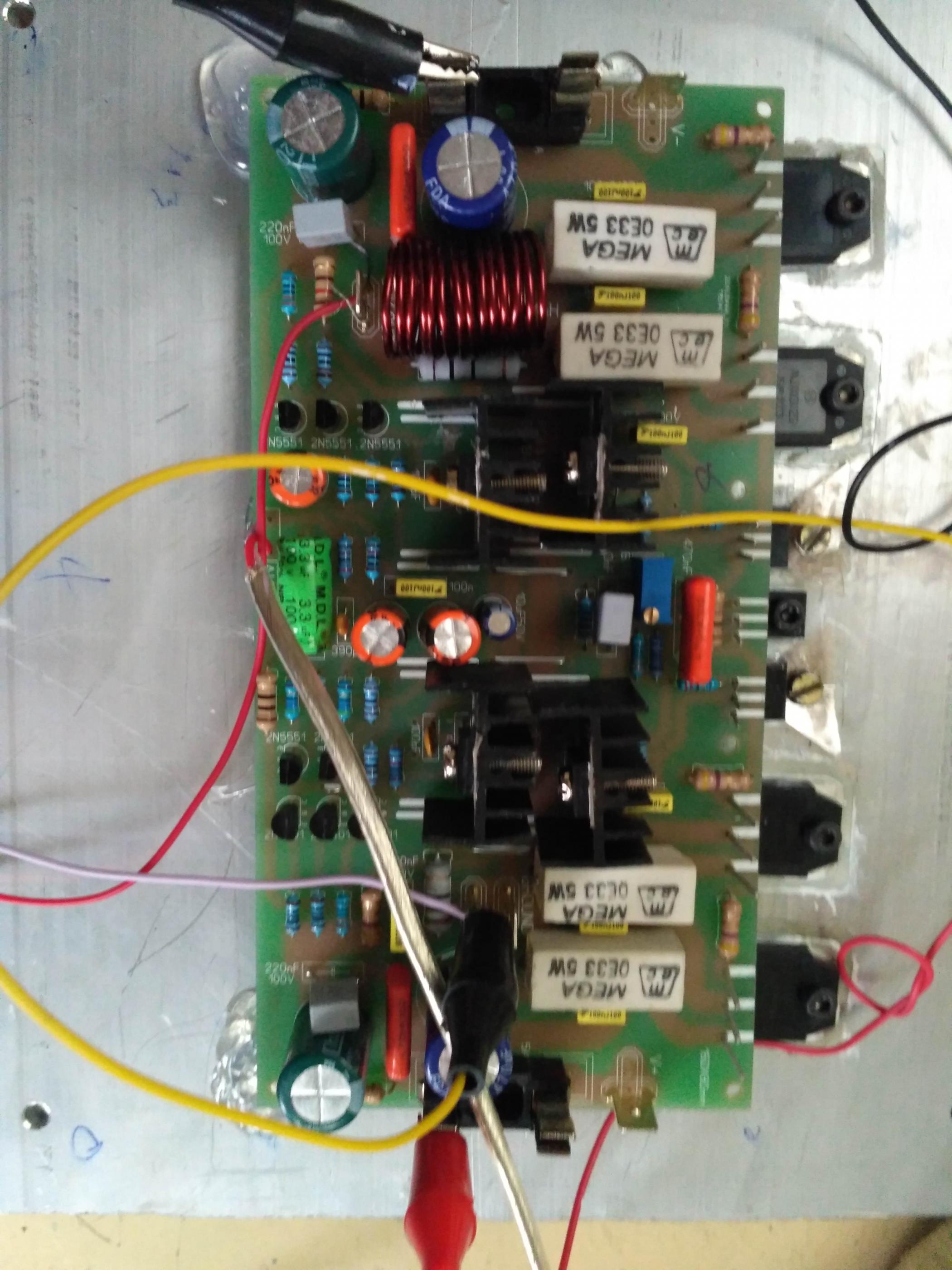

It's singing
Amp is working on first power on.
0.2mV DC offest
51V rails.
Sounding sweet. Can't talk much about sq as tried with test speakers without any cabinet.
Thank you very much Aniket for the amp and Indianajo for very valuable guidance.
