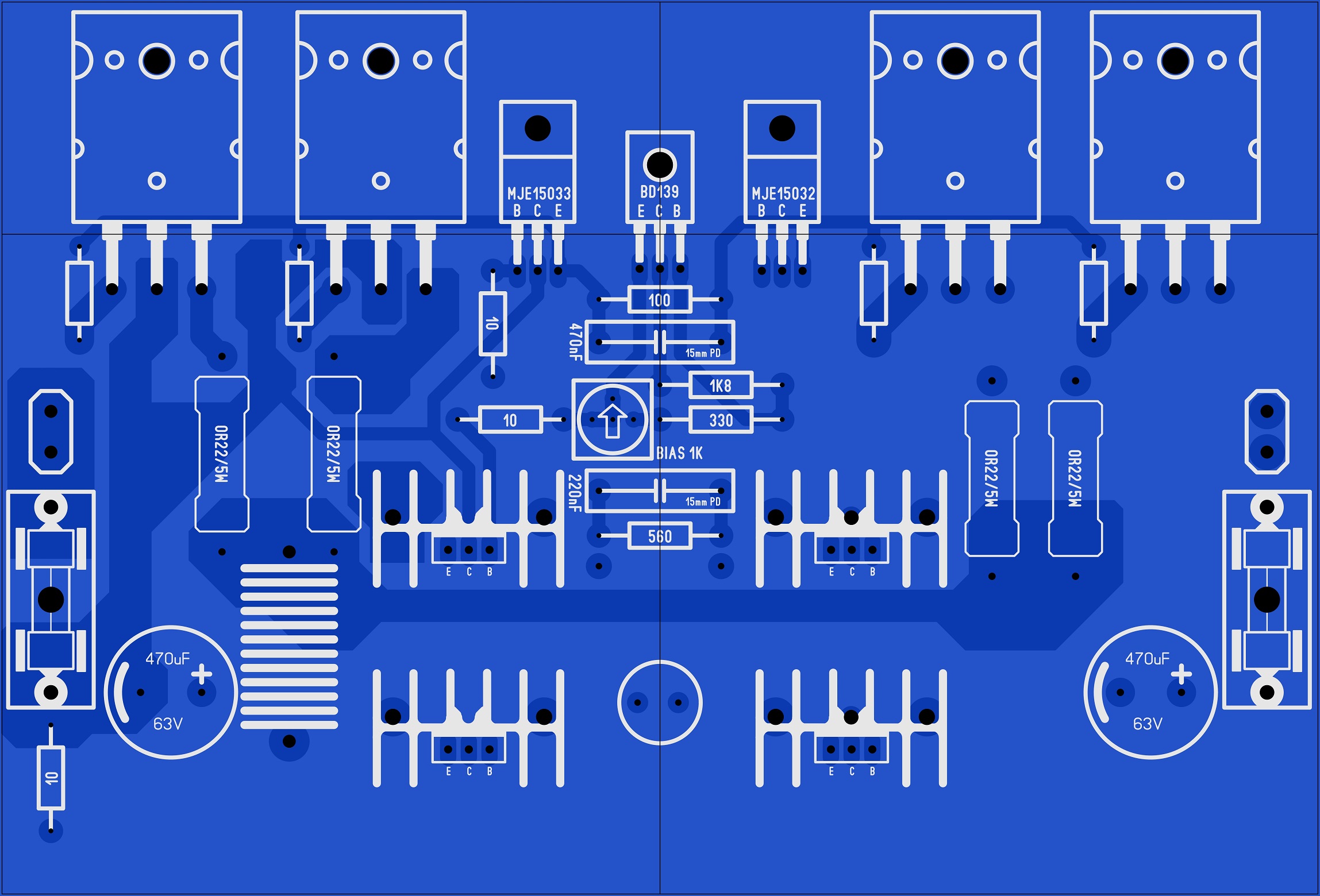

Hi Aniket!

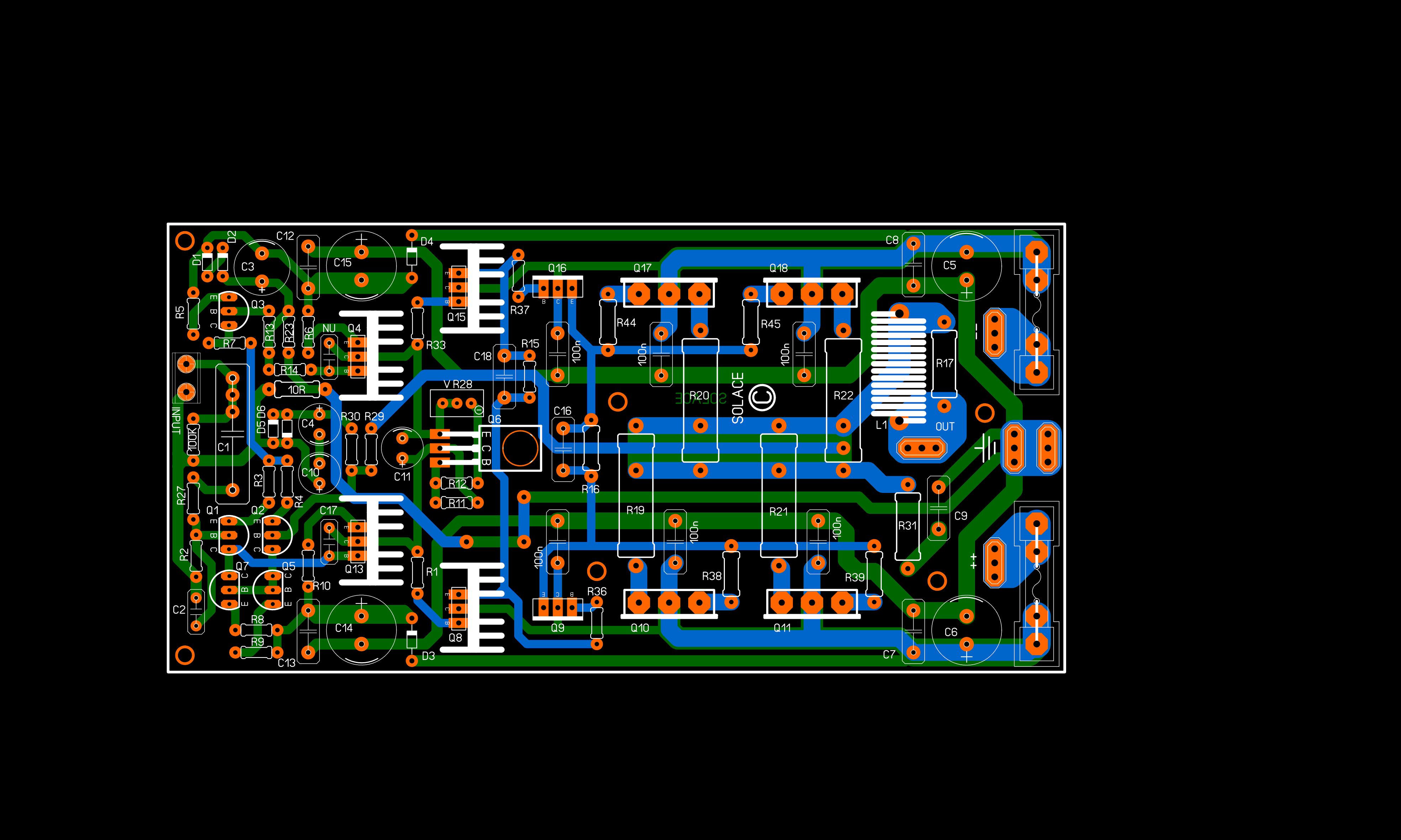

Give show PCB-botton layer for power supply in pdf format (in the ratio1:1).😱
thank you!
You have the Gerber files attached. don't know how to convert to pdf.

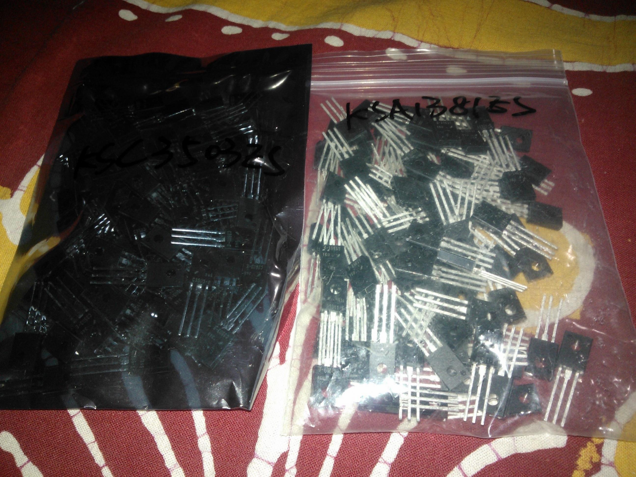

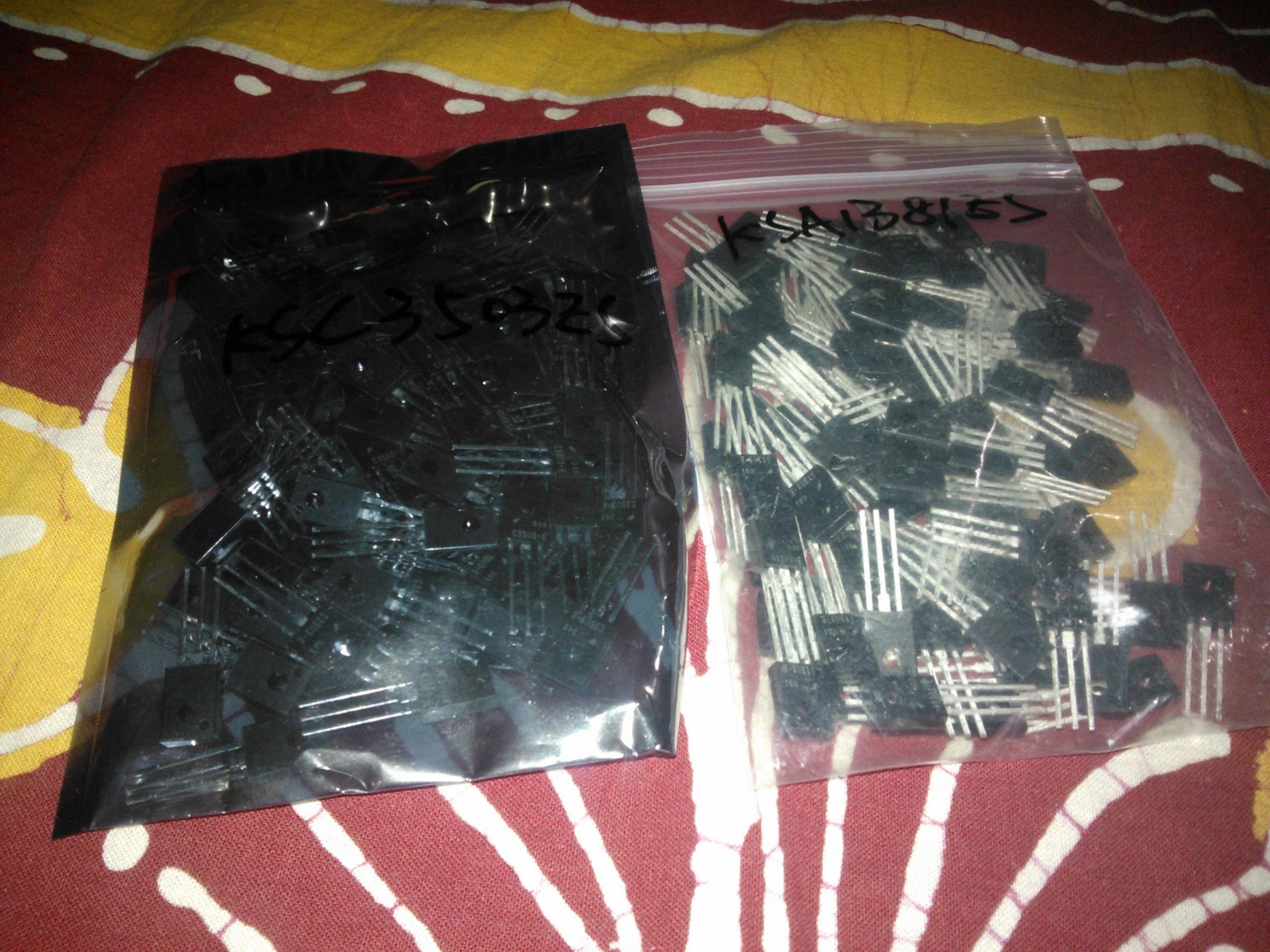

Improved performance with better VAS transistors
KSC3503/KSA1381 could be used in place of MJE340/350 for Q4/Q7 for superior performance. leave the 340/350 in place for predriver duties.
MJE340/350 were used only because of non availability of recommended parts in the local market.
So had to order them online. Received 100 each of KSC3503E and KSA1381E.🙂 Good for several new projects.
Hi Aniket ,from where did you buy these?KSC3503/KSA1381 could be used in place of MJE340/350 for Q4/Q7 for superior performance. leave the 340/350 in place for predriver duties.
Thimios.
looks that i can't buy online.
How i can buy these?
Mouser Electronics - Electronic Components Distributor
Digikey
Aniket
unfortunately ,Mouser stock only 1381c and 3503e
digikey stock nothing!
I attached below PDF version of the Gerber files. Congratulations for the work.You have the Gerber files attached. don't know how to convert to pdf.
If you want to print actual size, select "Page Scaling = None".

Use these instead:
2SC3902T ON Semiconductor | Mouser
2SA1507T ON Semiconductor | Mouser

Hello mister Aniket

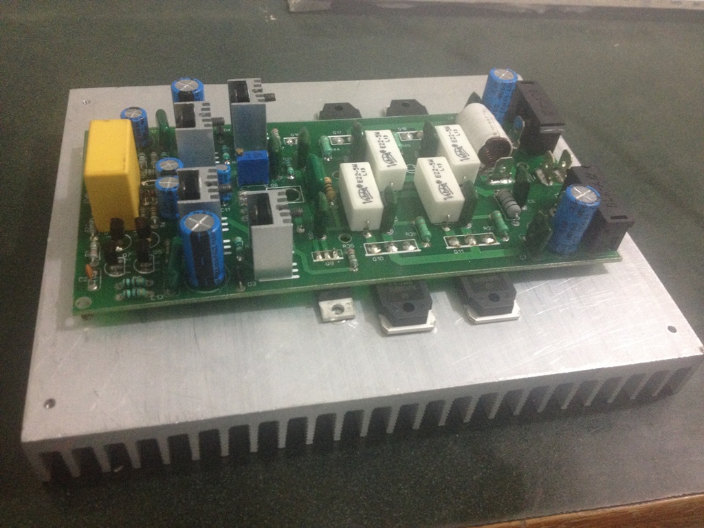

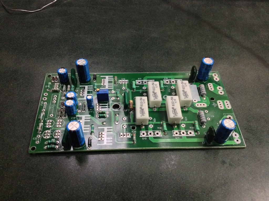

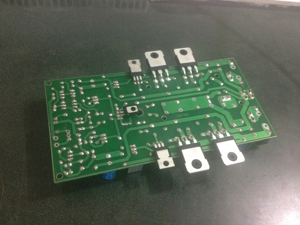

Since I like you layout a lot I'm trying to actually yes "clone" yours to accommodate the parts I have on hand I'm not done yet and I'm really busy this days I thought to show how it looks, by the way I like more the top installation for the power transistors my personal preference 😀 by the way bro thank you for sharing the file it was really nice of you 🙂

1381 and 1507 are not equivalent.Use these instead:
Aniket
1381 makes a good VAS and pre-driver low Cob 3.2pF to 4pF, Icmax 100mA
1507 makes a good driver Cob 15pF to 22pF, Icmax 1.5A
Agree,
but these are still better than MJE340/350, originally used for VAS duty. main concern is the parts availability.
2SC3790/A1480, 2SC3788/A1478, 2SC3645/A1415(different package) make excellent VAS devices, but then again, are these available.?
On semi has acquired Sanyo I think, hope they would manufacture these.
