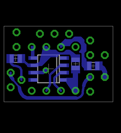

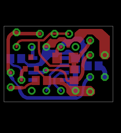

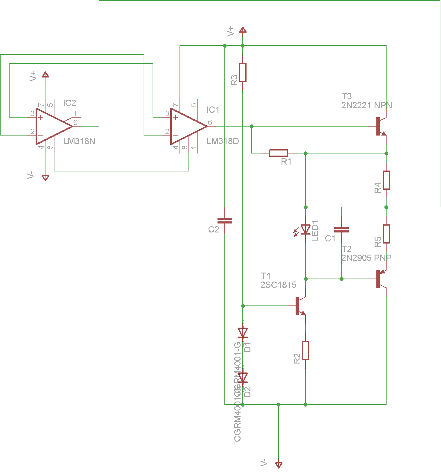

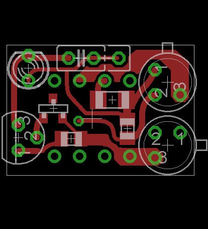

Hello,
I designed a small PCB for the LF01 with the attached schematic and would be glad for helpful comments.
Included are :
C1: with 5 mm through hole spacing
R6 (R5 in my schematic): 0805 type
C2: filter capacitance 0603 type between rails, as in your early schematics
R4: 1206 type
all other R: 0805 types
Q1: 2SC1815
Q2/Q3: 2n2221/2n2905 as TO18 metal can types
V4: 3mm LED
D1/D2: as SOD123 types
The PCB is roughly 19,5x14,5 mm in size.
Are there any obvious mistakes, or things to improve?

I do not understand your schematic!
Amp inputs tied together ?? Buffer o/p to amp o/p?
Wires very crossed somewhere.
The LM318N is just used for the pinout to the baseboard-socket and can be ignored. The new daughter board would plug into a LM318 in DIL08.
I could have made that more clear, right.
What is relevant is the output stage following the output of the LM318D.

A few suggestions: pins 1 and 5 of the SOIC8 opamp may be brought out to pins 1 and 5 of the DIP8 pins. They aren't used in the MyRef Rev C, but there may be other applications where offset null or alternate compensation pinouts on other single SOIC8 opamps may be needed, e.g. on AD797 or OPA627 or LT1028.
C2 can be made 0805 (which will also allow 0603) as well as 2.5mm through-hole alternate (e.g. Wima FKS02).
D1/D2 can perhaps be combined into one SOT23 package - would allow BAV99 or 1.24V bandgap references to be used instead.
There are also a few placement alterations I would make to allow more easy soldering of SMD components without the risk of solder bridges or shorts.
If all Rs are made 0805, it would also allow the use of 0102 MicroMELFs at the same location as alternates. Similarly, 1206 would allow 0204 MiniMELFs. It's not mandatory, just something to consider.
Q1 can use a smaller footprint for TO92 with pins 1 & 3 spaced 2.54mm apart, and pin 2 offset between 1 & 3. Several transistors are available with the leads already bent for that pinout, but it's not difficult to bend the inline TO92 devices to the smaller footprint at the time of assembly.

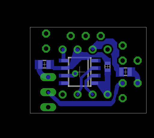

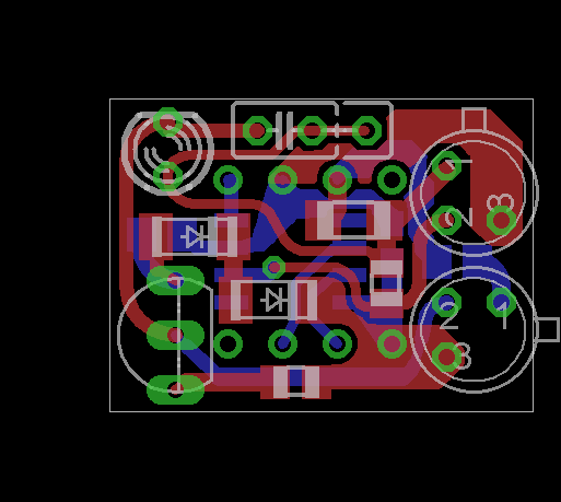

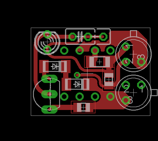

Mhh, those were some good remarks. Especially the SOT23 footprint for the diodes and the smaller TO92 footprint liberate a lot of space.
OK, attached is another version.
I am not really satisfied. I wanted to get it smaller, or tidier. Both at best. But this is it.
Soldering would be done under a microscope, so I don´t worry about solder-bridges.
I am not able to connect Pin 1 and 5 to the outside in this version (and size), but for the myMyref I don´t need it.
Probably I will do another larger version that has pin 1 and 5 connected and maybe offers more options. A higher current version as cmoy headphone buffer would be interesting...
Thanks for the help so far 🙂
