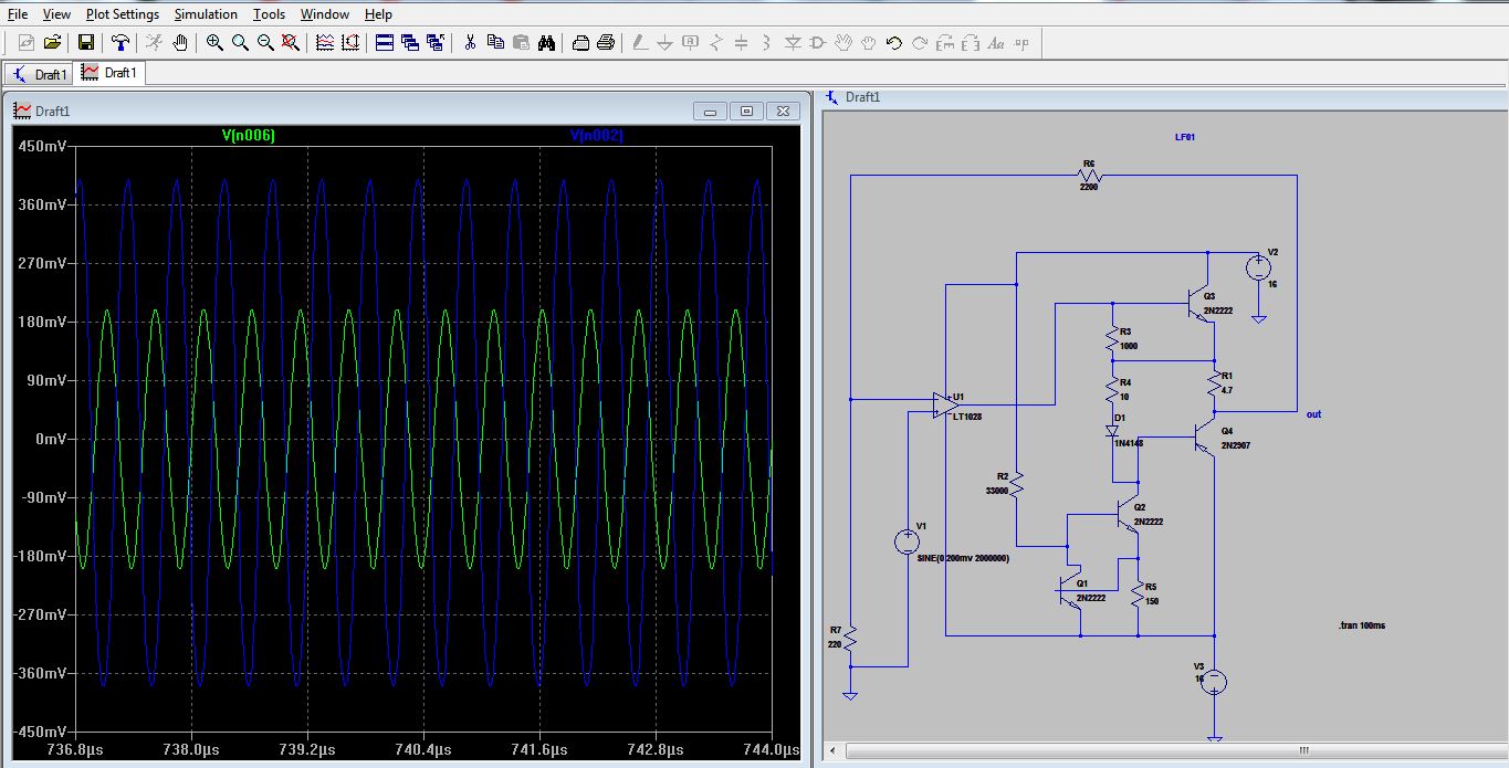

Ever wondered What an electronics enthusiast would do in weekends when rest of his friends are hanging out in pubs and parties..
I did simulation in Ltspice..(newbie here)
Used basic components here to be quick.
first is 200khz and second in 2mhz.I hope pictures are self explanatory .
what all reasons are attributed for decrease in amplitude..

Q4, the output-stage PNP, is incorrectly connected - the collector and emitter are reversed. LTSpice doesn't know or care about this - it will apply whatever model it has for the transistor (Gummel-Poon or Ebers-Moll), regardless. You'll probably get a very low-gain (hFE ~=1) transistor in inverted operation, and that's probably why it shows attenuated output.
My Bad , I Did not notice the emitter of pnp in negative. when I saw it worked in first run I assumed circuit is alright. (shockingly) it showed me working perfect in 200khz range.I will try again correcting it.
BTW does that implies Lt spice is flawed? I was thinking of designing some filters.
Any other better software ?
LTSpice (or any other simulation program) has no way of knowing if a particular circuit configuration was deliberately intended or an unintentional error. They're all going to simulate it the way it is drawn, but may throw up errors or warnings in some cases. As simulation SW goes, LTSpice is actually very convenient and probably the easiest to use. TI's TINA is another popular alternative.
