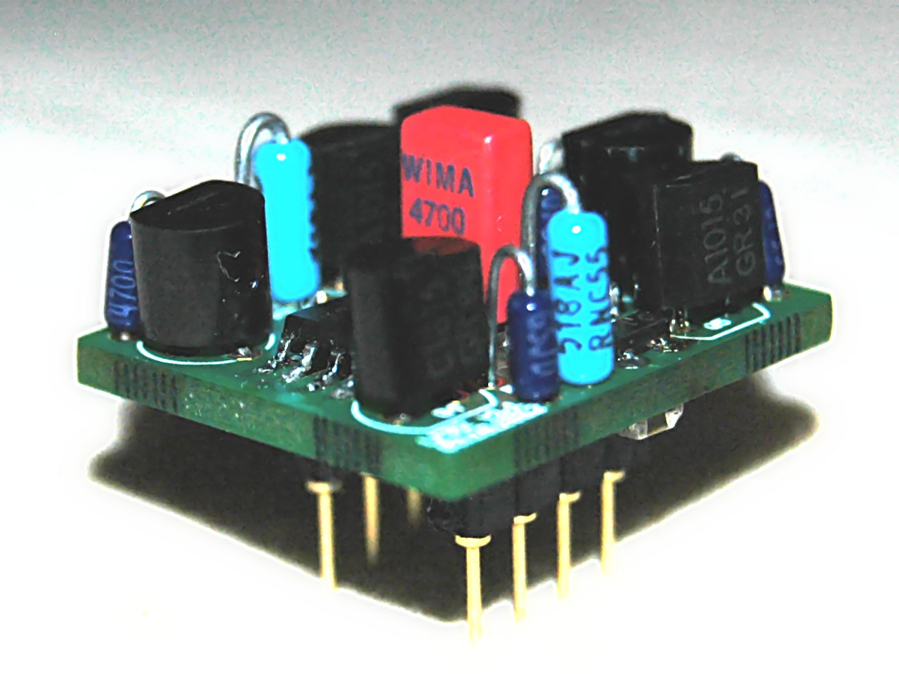

The LM318N is DIP-8, while the LM318M is SOIC8 (SMD). If you plan to use my LF01 PCB, you need the SOIC8 version. If you build it on a perfboard, either one will be ok, but the LM318N will be easier to handle.

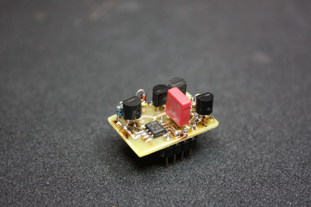

I have finished one LF-01 module thanks to Siva ideas and worked from the first time. I have followed all the parts recomendations.
Being only one channel equipped i noticed slight modifications in the sound but i think i need to finish also the other one to have a complete opinion.
What was obvious after installed LF-01 was a higher noise from that channel. I could hear from the tweeter a louder sssssssssshhh sound. Any opinion about that noise Siva or someone else ?

Yup, you need two identical ones to assess imaging. Regarding the hiss, I haven't noticed it, but it could be EMI/RFI pickup from long and/or magnetic leads. Also check the output DC offset with the LF01 installed.
atupi, my experience was quite the opposite. Artifacts in the sound were lessened not added. Is the hiss heard over/through music or only when no signal is being amplified?
The hiss is present with or without signal but you can hear it when you put your ear close to the tweeter. I cant say is audible from my couch but the difference between channels is audible. Hope today to build the second one and hear the real difference between MyRefC and MyRefC+LF01.

Yes they sound very dark. Regarding hiss now i hear even more noise like a noise from AM between stations and i suppose this is because i have LF's installed on 2pcs dip8 sockets plus the socket from MyRef pcb.
I have the same number of sockets so that may not be the cause of the hiss. Comparing your photo to the one in the first post,the cap is the most obvious difference. Did you try to get info on the best selection for that position? Siva may be able to report how significant that is.
For that position Siva recommended ceramic type but i managed to squeeze a FKS2 and i know this type worked better in Myref versions. I will try also a ceramic (maybe) because is so hard so swap components on that small pcb. I worked exclusively with magnifing lens. Unfortunately not all transistors are made by Toshiba and i founs also some cheap Fairchild but all of them from Mouser.
Small problem and i don't know where to look. On the left channel i have a small thump on powering On and also on powering OFF. Is not related to a specific LF module because if i roll the LF modules between channels the problem remains on the LEFT channel.
When i put back the plain LM318 the problem is gone.

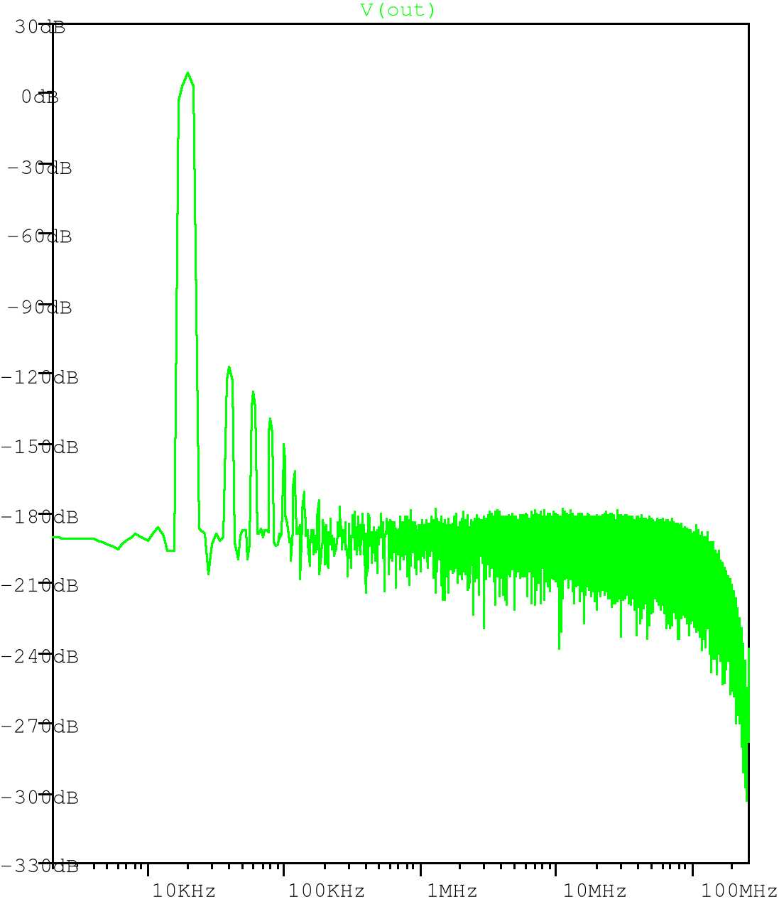

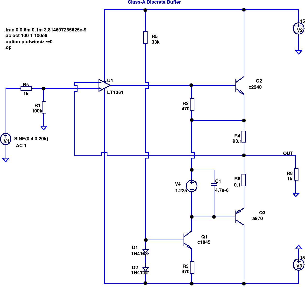

*Long bump up* - several mods have been made to the LF01 (single) and LF02 (dual) over the last few years. Here's the current simulation schematic for the LF02 (one channel shown), which will also work for the LF01. Various opamps may be used, including the LT1361 and the LM6172 (in the LF02). The LF02 prototype shown in the picture is the latest, with all-Japanese low-noise BJTs, Dale MFRs in the signal path, Wima FKS02 bypass and LM6172 opamp - and it's also subjectively the best sounding so far in a 2-channel MiniRef amplifier.
