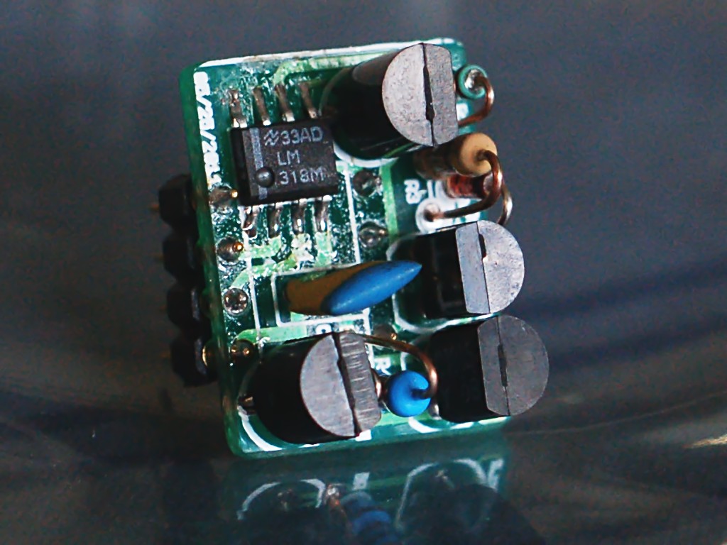

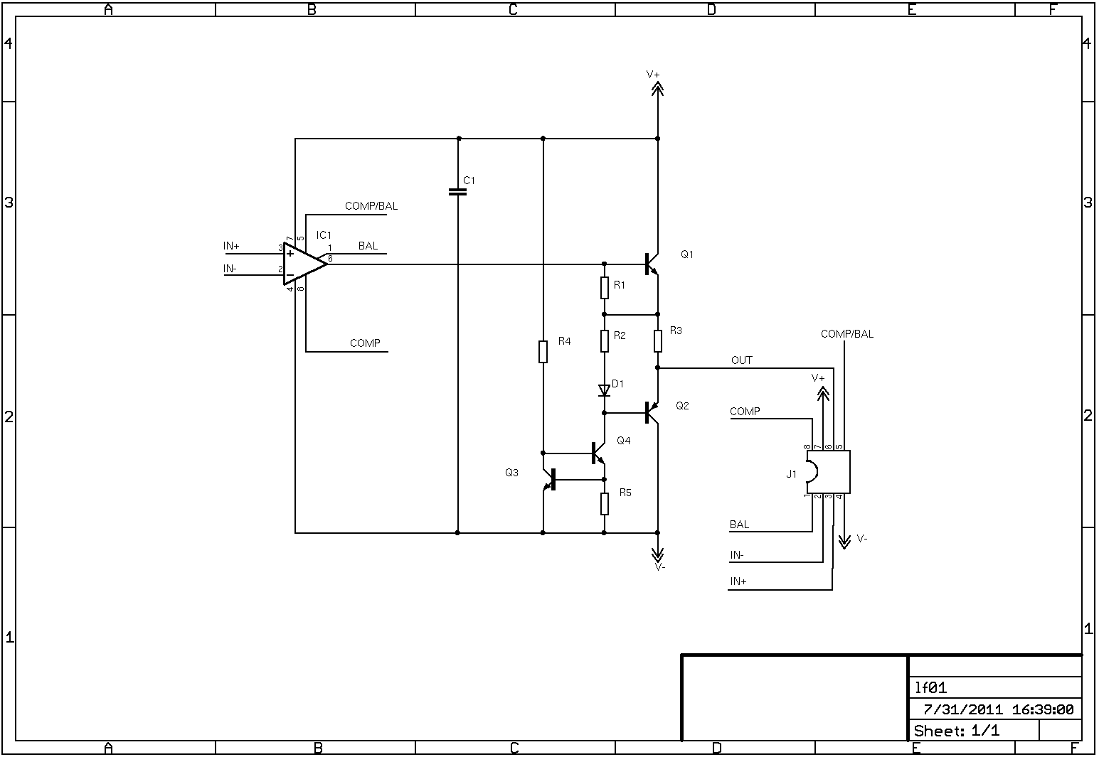

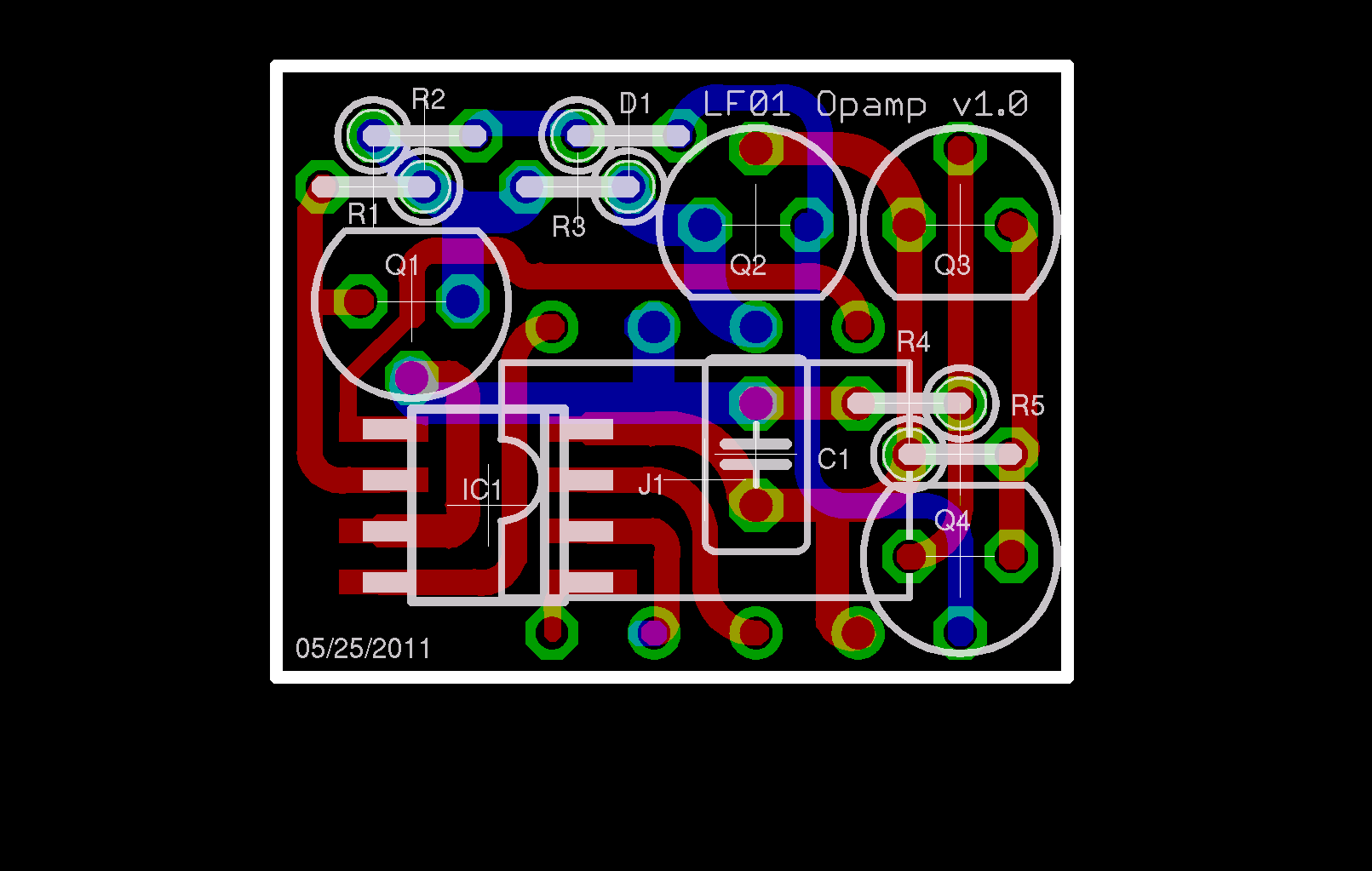

This is an announcement of the LF01 discrete/hybrid module that uses a monolithic SOIC-8 single opamp, some BJTs and passives and plugs into a DIP-8 single-opamp socket. The intent is to bias the output stage of the opamp into Class-A, the discrete output stage into Class-A/AB and bypass the current limit of the monolithic opamp (more details will follow later).
Schematic, Layout and picture of a prototype with an LM318 installed - this is intended for the MyRef Rev C:

Thanks - the first tests were actually done with a V1.2 board. There may be mechanical interference with R3 and C6. A Futaba MPC74 at R3 and low-profile electrolytics (say Black Gate PK) at C6/C11 solves the clearance issue on V1.2 Twisted Pear boards.
It should also fit and work fine with my V1.3/1.4 boards, but I haven't yet tried it out. It appears to be stable and sounds fine with the components listed, but some further tweaking of resistor values may be necessary for optimizing the sonics.
The bare boards are available now; kits and assembled boards may have to await some tweaking of the passives - say 2-4 weeks.

why not omit the opamp all together?
The discrete output stage of the LF01 is only a unity-gain buffer/voltage follower - you'll still need an input stage and a VAS. This could be made fully-discrete, but the module will be larger and may have no advantage over many high-performance opamps (LT1028, OPA627, OPA1611, etc.).
I sought to combine the advantages of high-performance monolithic opamps (low noise, high PSRR, high CMRR, low distortion, small physical footprint, relatively low quiescent current, etc.) with the advantages of a discrete output stage (Class-A operation, no current limit). The main intent was to drive low-impedance loads, including headphones, without clipping. It turns out that it also works pretty well for most opamp applications (except micro-power, precision offset, and low-voltage/rail-to-rail applications).
so it doesn't fit in 1.2 board if say silmics are installed at c6/11? how about running it through a wire off board like this?
Yup, if you have tall caps flush-mounted at C6/C11, the LF01 may not fit in the socket. If C6 has sufficient lead length to bend it aside, it might still fit.
If you use a socket-extender cable, you'll have to worry about lead-inductance and cross-talk, especially on the comp and comp/bal pins. The LM318 is extremely fast, despite its age. With much slower opamps (eg. LM741 or TLV2341), an extender cable may work just fine, but you probably don't want to use such opamps in high-end audio.

Changed R1 to: 470R/0.125W/1% MFR (probably makes no difference if it is 5% CFR). This biases the LM318 deeper into Class-A with ~1.5 mA quiescent current, and the audible sonics seem to be smoother, more airy, and less fatiguing. This is in a stock MyRef RevC in a Twisted Pear V1.2 board.

Received the board in a fine condition today, and what a fine board it is! I couldn't believe how tiny the pcb was, and still can't believe how I managed to fit FKP02 100nf in there. 😉
Sonic impressions will be done later today.
Thank you for this wonderful offering.
Thanks - please take your time and assemble it carefully and check for bridges, shorts, etc.
You may need to piggyback it on one or more DIP sockets to be able to clear some components on a V1.2 board - YMMV.

I had to move the c5 cap underboard to make room for the module, but the tiny holes in the pcb soaked up the flux easily, despite my worries.
All in all, a hassle free operation and another testament to the wonderful quality of your boards.

BTW, how do you manage to rework the PCB to change parts? It's very difficult to get to the pins of C1 after the module pin headers (4 + 4 pins) are in place.

Bonsai - thanks for the link. You have much higher output stage bias currents, which I've reduced a great deal by using Class-A Push-Pull with a PNP in the output stage. I also use smaller bias current (~1..1.5 mA) for the opamp output stage bias.
There's also an unusual biasing trick in my circuit that allows reverse current flow in the emitter degeneration resistor of the NPN in the output stage, thus keeping the upper half from cutting off hard, even at large swings - check it out in LTSpice to get the full picture.
well I'm a bit of a barbarian when it comes to soldering. I'd use a dulled out tip that has enough contact area to heat both pins at once and pull the cap out as the solder melts.
Of course there's the risk of melting the plastic of the surrounding pin headers but I wouldn't call myself a barbarian if I was afraid of that. 😉
