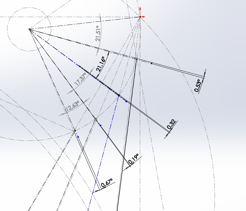

There is a circle on a 0.7071 Birch, that will give you tangency through the complete 30° translation.
With standard pulleys as Carlo's design there are 3 nulls 0°, 15° and 30°.
Between 0° and 15° the biggest error is 0.3° and 0.22° between 15° and 30°
BUT in the same geometry it's possible to get tangency with small modifications to the pulleys.
Found this when trying to confirm geometric calculations algebraically.

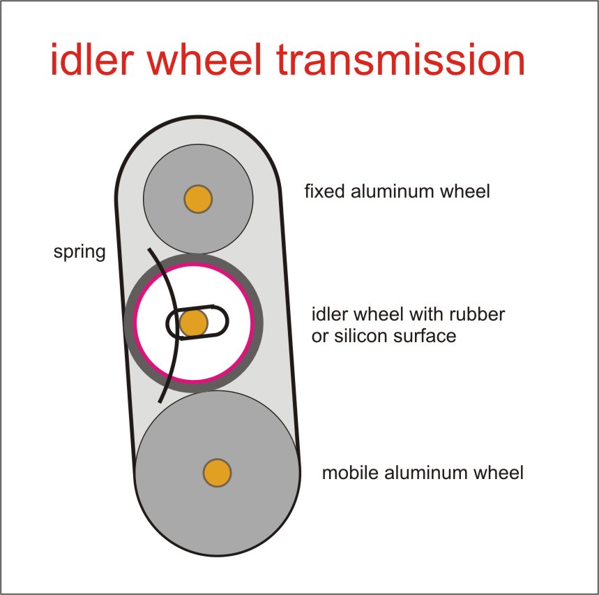

(attachment) a small idea for your wheeled transmission: the ratio is correct also with small pulleys, and with great precision (better than the belt)

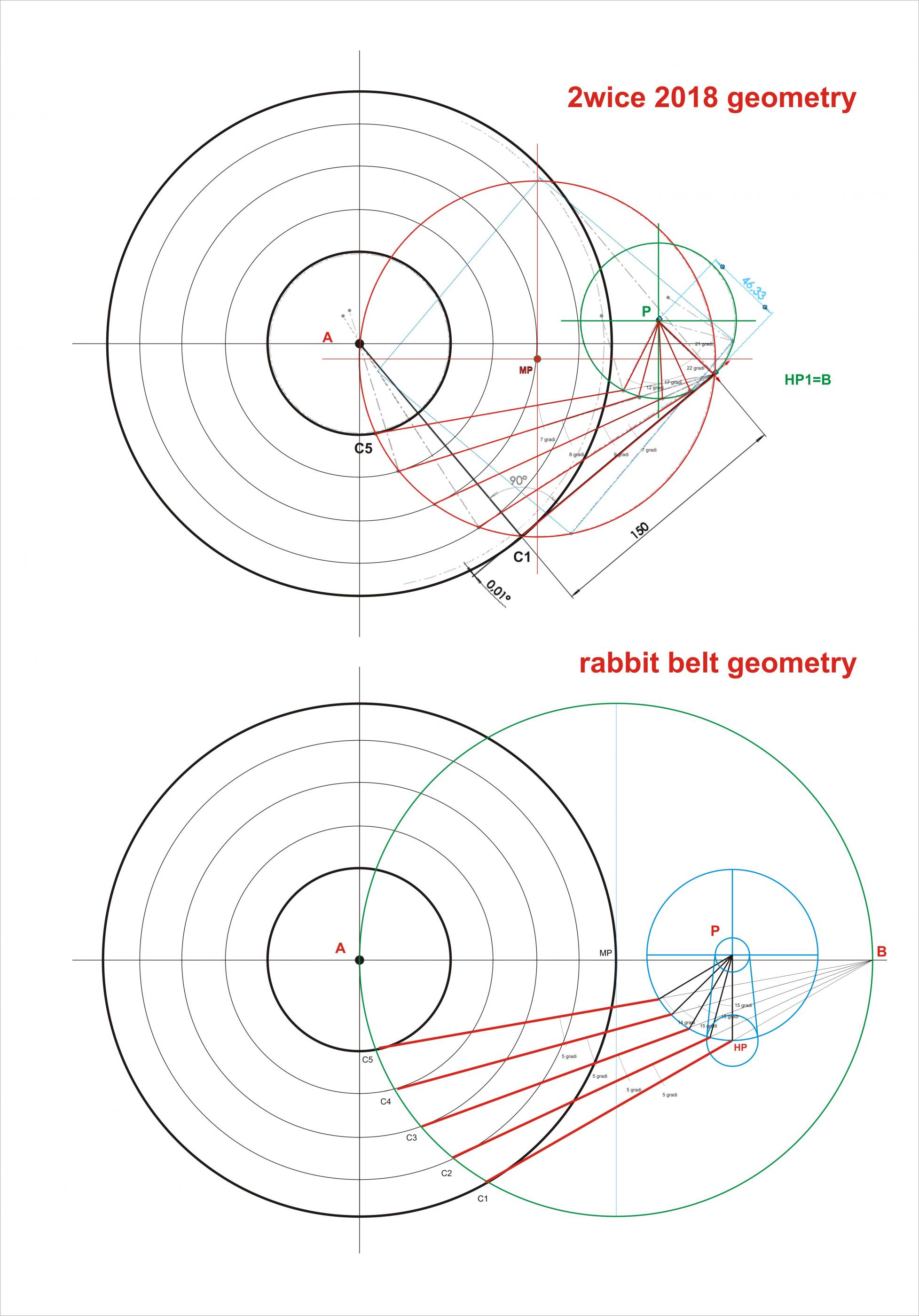

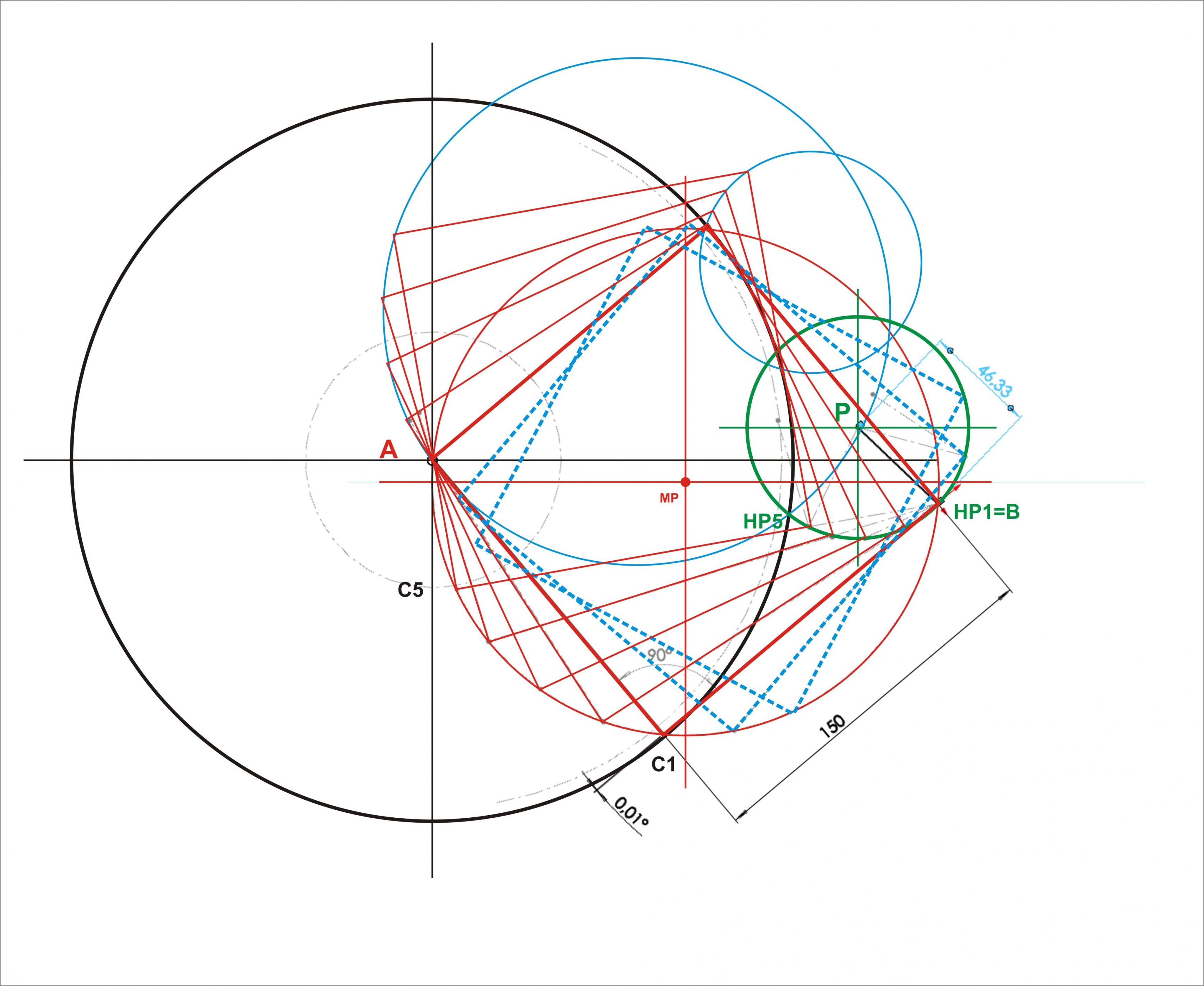

Hi Carlo
There is still a circumscribed triangle as in Birch, but now it falls on a circle that circumscribes a 150mm square = to tonearm length.
An elliptical pulley or deforming mechanism is no longer necessary, the eclipse is still there, just not very obvious.
I have calculated 0° pulleys for you on this geometry.
This would not have been found if I did not see your mechanism. Thanks.
carlo
Very nice and thanks Carlo.
I'm trying another idea for the idler where it eliminates slip and is captured by the driving pulleys, I'll post once it is working in simulation.
2wice - I tried to understand graphically this new beautiful geometry. Perfect behavior, and strange at the same time: Hp1 seems to be the B point of the Birch - Thales, and seems to act like a breaking point of the geometry (see the blue squares). I had observed something like this analizing the arm with two cranks of Doug

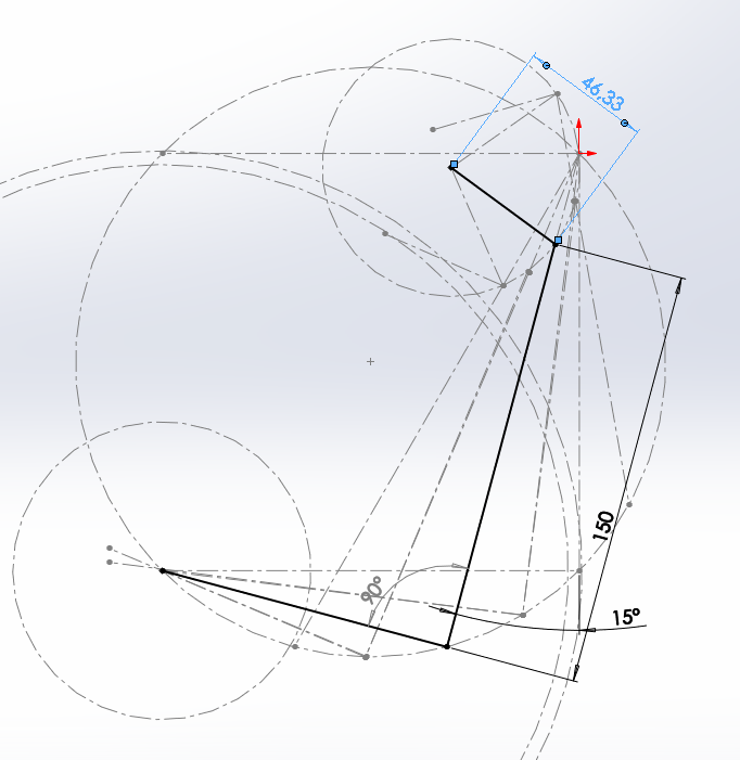

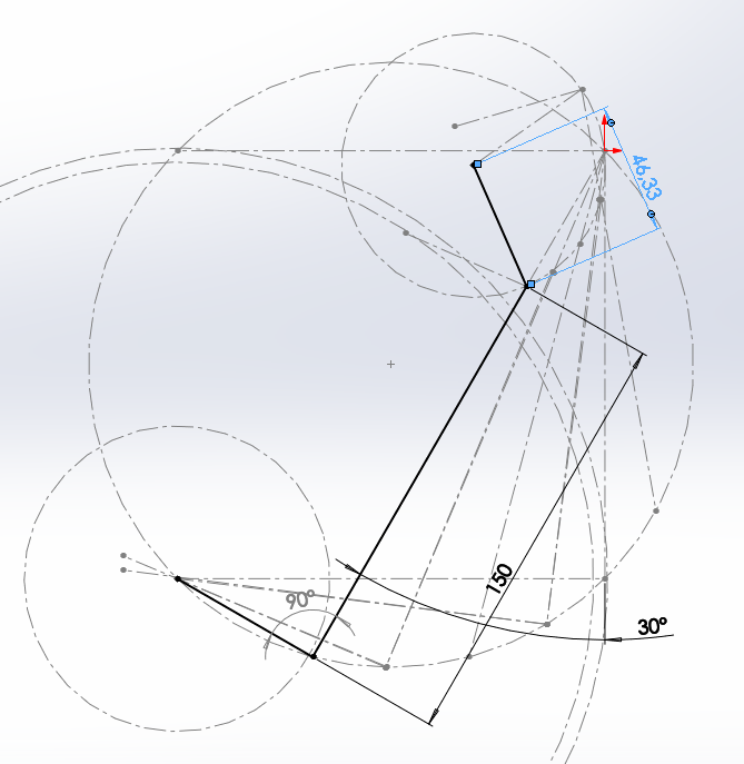

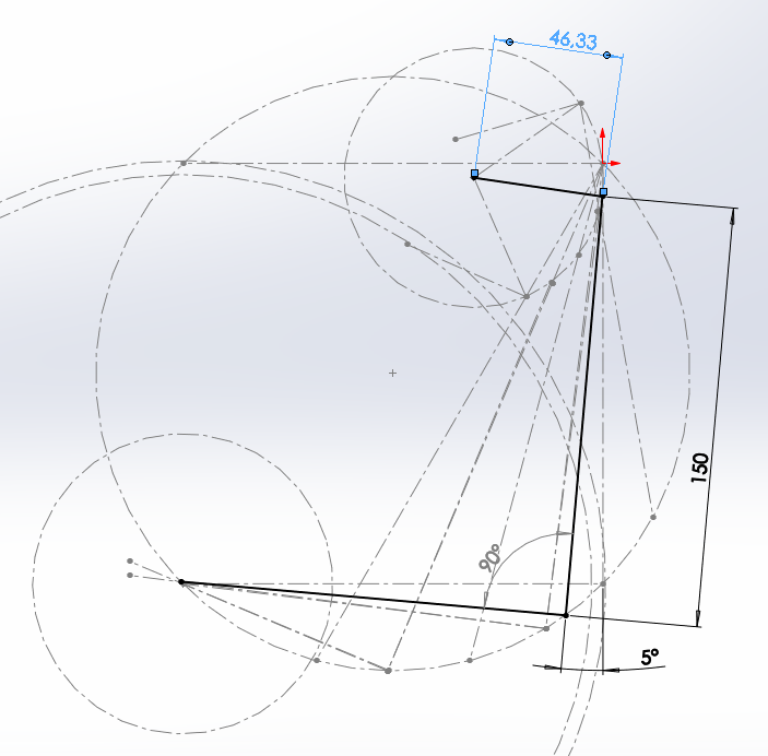

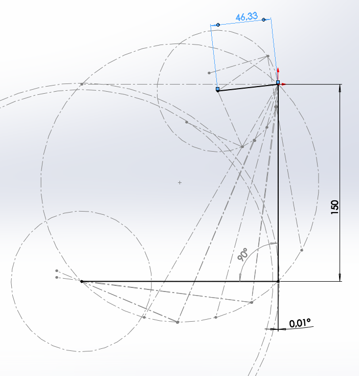

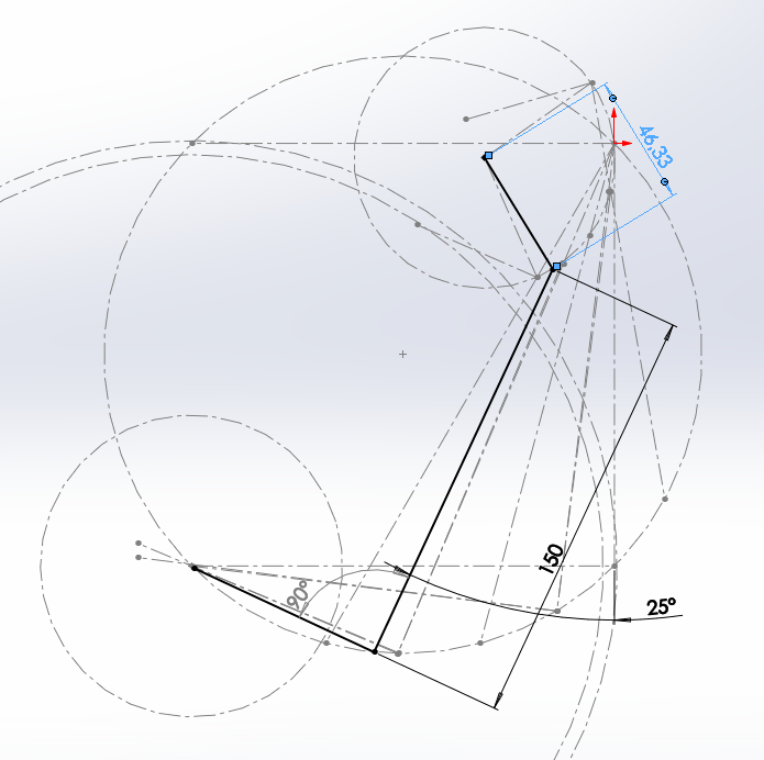

Dear 2wice,
looking at the problem posed by Doug (angle shaft crank near 90 °) I've seen a problem.
The rabbit belt gadget was found observing that - more or less - there was a linear relationship between crank and shaft rotation, with a ratio of about 2/3.
In this new geometry the relationship seems much more complex. How can be managed with pulleys?
Please see angles in attachment - it's just a graphic analisys, hope I'm wrong.
carlo

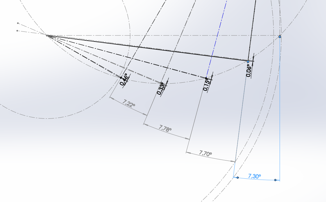

No you are not wrong.
In my geometric analysis I did not see the slippage as it was so small.
I was using geometric constructs to look for shifts.
The calculations for the 2 pulley belted at this location goes as follows.
It's very much exploratory for me and my 3 pulley solution is using variable speed pulleys to get to 0°, just for sh!ts&giggles. I'm just having fun with it.
Each of the pics below shows variable degrees of change (delta) between the 2 pulleys, you picked this up.
Derive the delta in each 1/4 of travel for both pulleys and calculate the ratio for each 1/4.
The mean of those ratios is the pulley ratio to use for 2 pulley belted solution. 1:2.416
Plot the new position of the mean ratio pulley and derive the delta from the ideal variable positions.
Derive the new tangency errors from the new plots.
I think this is right.

An advanced refinement would be to add mechanical lifter to one of the gears (idler), to engage and disengage the gear in the gear-train when the arm is outside of the record area, so the arm can move freely with out having the gear-train engaged . This device could be mounted to the main fixed gear post.
If not the above due to too much friction - I'm curious also if there were additional pulleys added in some manner to a pulley arrangement , where upon the pulleys could rotate using the tonearm leverage, but the belts would be free to move but belt tensions would be just above the stylus drag - to somehow lock the arm like the gears above .
Sorry in advance from a less advanced contributor; as I realize this is not likely contributing to the job at hand, and likely will/may quickly be shown to be nonsense immediately. Too much thinking and not enough doing.
Thanks for sharing all your efforts,
Phil
ps. For anyone at a basic level without a lathe and other appropriate tools, the children's toy Lego has a product line called Lego Technic that has gears and pulleys ( and belts, bushings, axles, etc ) that can quickly turned into a model for basic testing and proof of concept. These may be better than the popsicle sticks, magnets, stiff board,rubbber bands, etc.. I've attempted to use. I will be ordering some in the next few days.
I've read this thread and have been following it for quite a while. It's been fascinating seeing these latest developments with Carlo's Rabbit/Bunny type design, Twice's work. et all.
Before delving too deeply into it, I'm likely naively intrigued with the idea of using light weight gears ( likely spur ) in some configuration moving epicyclic rather than using pulleys based on Carlo's design. Very briefly looking at some tooth profiles , there is a claim that if well designed/made they roll rather than slide in regards to their contact friction point ( more research would be required ). They likely wouldn't be bearing any vertical weight, and would be mainly acting as a guide. they could be full size, or perhaps scaled up or down . They would have to be replaceable, and robust enough to rotate the crank, and survive negligent mishandling. I don't know if two gears and an idler gear - one gear fixed - as per Carlo's, an offset idler in the middle and an outside gear with the arm mounted would work somehow. There are further options with gears on the same axle, etc. perhaps to try to make the geometry work. Also, perhaps gears in combination with something else. This would likely require the lightest weight components, and the geometry utilizing the longest arm would help for leverage. The motion would be Epicyclic - two planets interlocked moving around and interlocked with a fixed Sun. The tonearm fixed rigidly on the outer planet axle.
Advantage ? : The biggest advantage to this and the reason I'm mentally pursuing it, is that I believe ( mistakenly? ) there may be zero skating utilizing toothed gears and an offset idler ( or more than just 2 gears ) with components mounted at an appropriate angle to the tonearm pulling direction. I'm hoping the arm will/can be mechanically locked if the arm is pulled in the tangential direction ( or any straight direction ), yet will be free to rotate. Personally, this idea is what I'm most interested in; in this thread - linear or close enough to linear but with no skating (or virtually no skating). The math/geometry/ratios would have to be worked out.
Backlash : As there is a constant load from the rotation of the record pulling the tonearm , I'm hoping the play/backlash will almost always be taken away by the record rotation pull holding the gear teeth in contact to one side, even when a gentle out of round event is occurring ? . Other events may upset the mechanism briefly, but I'm thinking it will return to the no backlash state quickly while the tonearm is constantly working it's way inwards. If not the case, I would further look into backlash reduction methods.
Friction : Perhaps the reason this whole idea is a waste of time - it may have too much friction to work at all. If the notion that the teeth roll on each other rather than slide is true - I'd be hoping the two interlocking contacts could sort of be counted as 2 bearings ( 2 poor bearings ? ). So it looks like there would be a total of 5 bearings ( possibly or likely too many ). I remember seeing a section on Yosh's site discussing some sort of idea that absolute minimal friction in the horizontal bearings wasn't necessarily desirable, but I don't remember the context.
Phil
