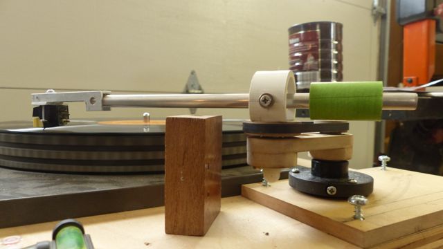

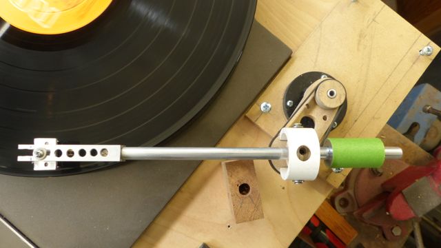

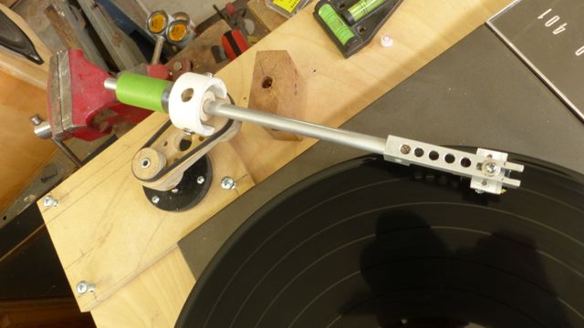

I think I have found a solution for the pulleys & idler, and it might be applicable to the 2 pulley belt system also.
It is also not bound by the geometry anymore and could be placed nearly anywhere near the rim, subject to the tonearm length and start angle between the fixed and moving pivot.
From Doug's experiments, I might try to get that angle more obtuse, but I'm going ahead with the current angle just because to recalculate it is a mission, and an obtuse angle would increase the distance between the pivots.
ATM the fixed pivot can be a circle, but the profile of the idler and moving pivot has to change, took a looooong time but you can calculate the profile of the contact area between the idler and moving pivot to give you an increasing and decreasing angular acceleration required to keep the stylus on the tangential line.
It's incredibly weird but that profile can be nearly any shape as long as the mesh distance is the same and the transition is smooth. A congruent mesh will mean no slipping at all.

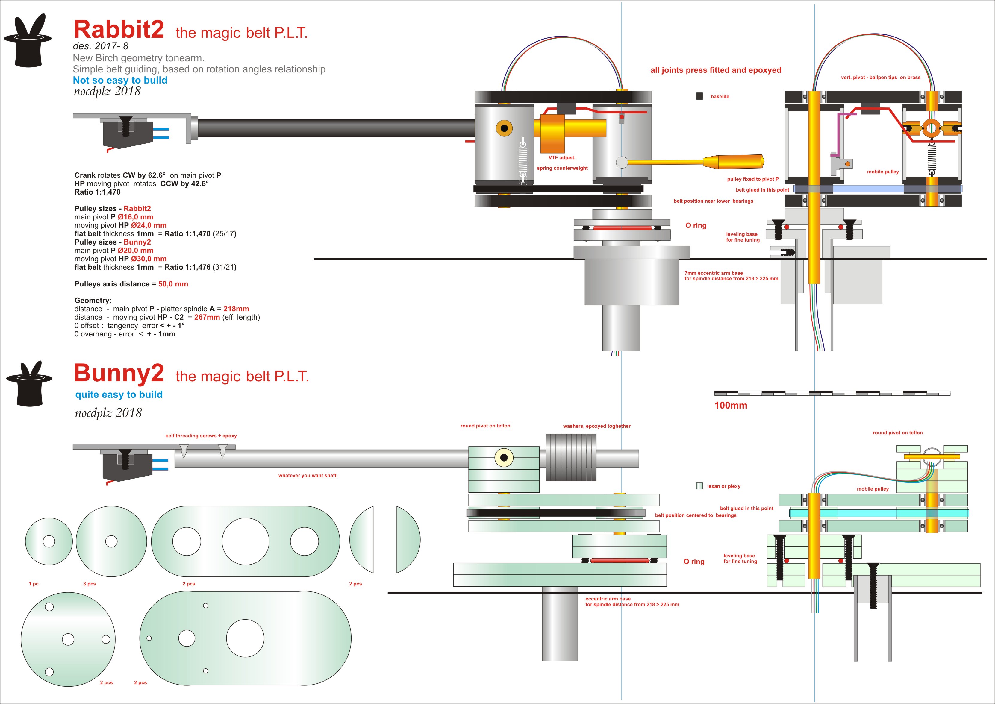

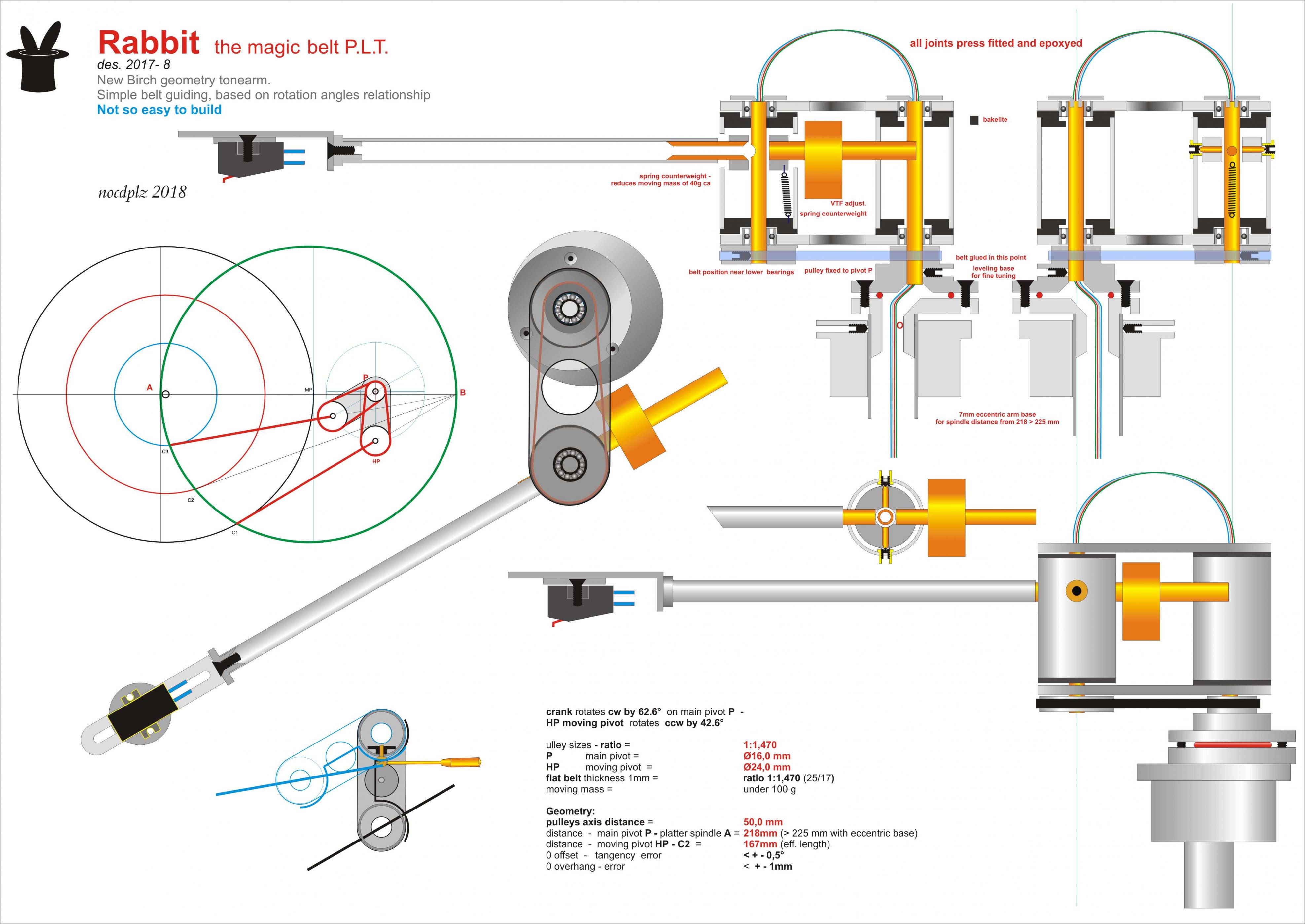

Another step in Rabbit&Son design; trying to make my life easier, at least in this.
Bunny2 e.g. can be made with simple tools always at hand: laser cutters or cnc mills, water jets, 3d printers... Rabbit2 instead needs still some lathing.
To be continued. (all those damn ball bearings...)

NOCDPLZ, It seems to me, that belt linkage will have it's own resistance to rotation due to belt elasticity. Thin flexible thread should be proper material choice.
A noob idea.acceleration calculations are a nightmare because there are no accurate circumference equations for an ellipse. I've given up on finding an algebraic solution.
Can a jig be set up in such a way that the main pivot is fixed, the horizontal line across the vinyl is fixed by a track can be placed on which the jig dummy headshell can be moved. and the ellipse part would have sharp marker; so when we move the dummy headshell across the record it traces the ellipse ?
Regards
I've basically done this digitally to calculate the perpendicular point between the idler and moving cam for every degree of the tonearm arm rotation. It's working on paper so far.A noob idea.
Regards
Maybe Walter, but I can give you just an answer: try it.
Instead that's why using a rubber belt: a belt has no motion relative to the pulleys. so it does not have friction - on the contrary we need that does not slip with respect to the pulleys, with the least possible tension (load on the bearings). The force dispersed (2- 3%) is only the deformation of the material of the belt (and the more rigid, the worst).
That's how it behaves in the prototype: in respect to the tracking forces (0.1 - 0.2 gr) the belt is completely rigid, the elasticity comes into play only with discs with marked eccentricity, in my opinion softening stresses in a positive way. With a rigid driving system this job should be done by the cantilever, with probable damages.

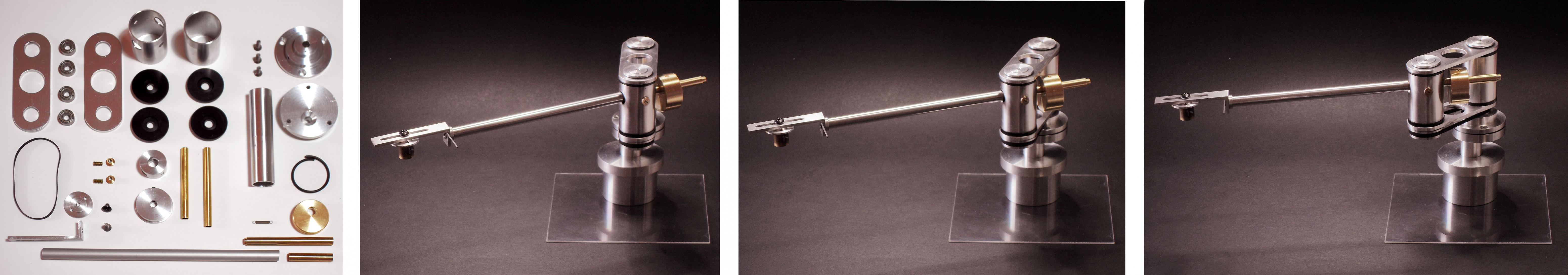

Hi all - Rabbit tonearm (almost) done.
Working on stiffness and lightness complicated a bit the construction. I gave up with the lifter in order to have a sturdy double crank system (design modified from previous). A small spring counterweight saves about 40 grams, so the total weight of moving masses is below 120 gr, which is an acceptable value for normal tonearms.
The most difficult things to build without a mill are the cranks and the vertical pivot: with my pillar drill I got a 0.12 mm error for the axes distance, and it took me a lot of patience to get there.
Ball bearings now are loaded almost properly, so having 4 instead of 2 does not increase frictions. Now it's easy to set up (leveling, spindle distance, proper angling are all fine tunable) and quite comfortable to place precisely on every trace of the record.
Some experiment are needed for cables that, being exposed on top, must be more resistant than those used on test-Bunny, but still very flexible.
