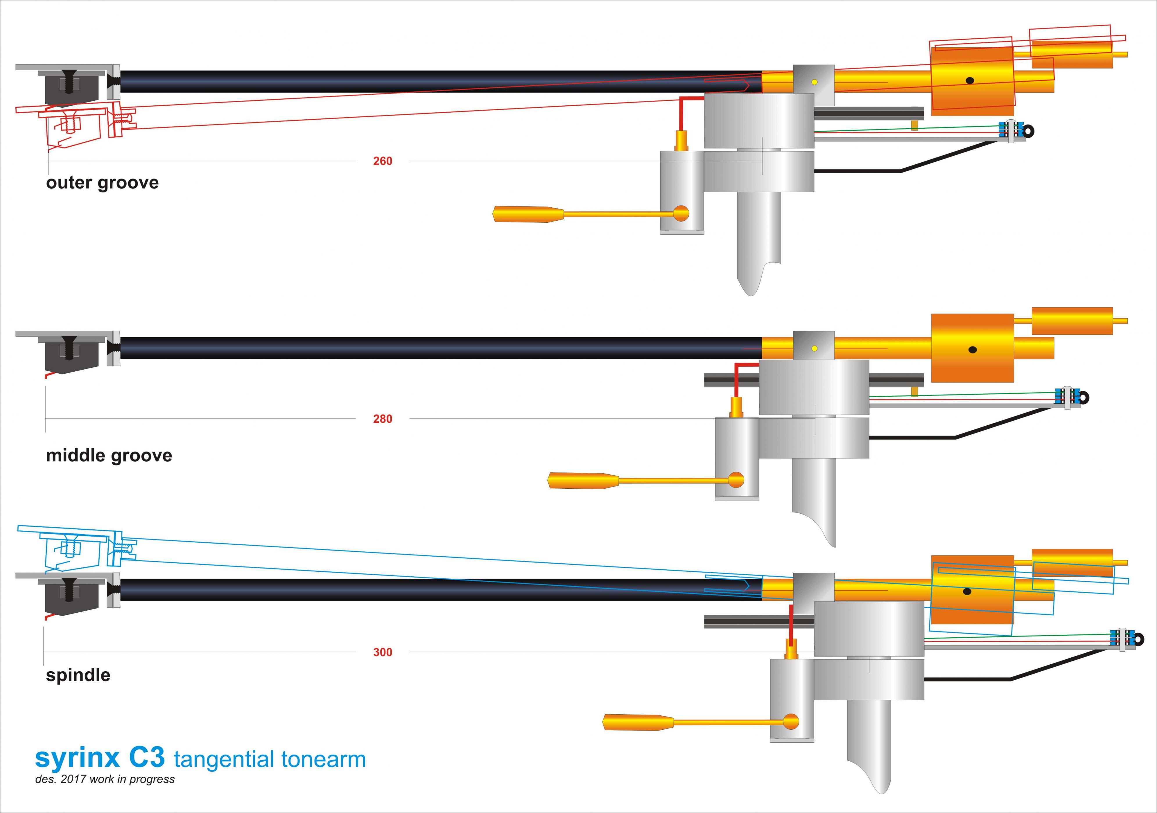

Impressive drawings
But please always think about vector decomposition of the stylus drag force: one vector component is in the pivot direction, the other component (if exists) is a skating force. A tangential pivot tonarm should be self-aligning, i.e. the cantilever should be tangential AND there should not be any skating force at any point of the path. (And there should be an equal opposite force to the variable and mostly unknown sylus drag).

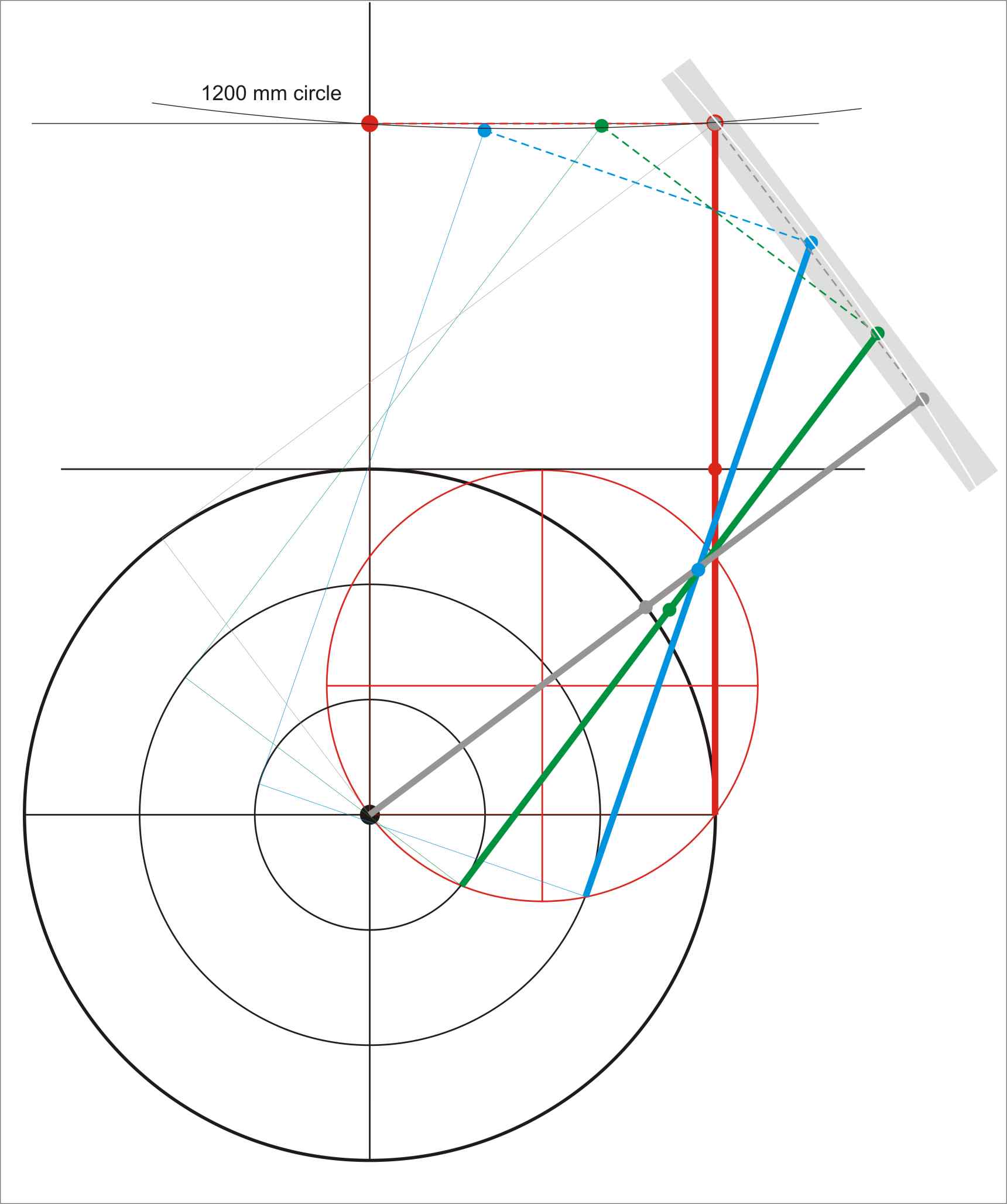

That graphic was made evidently for fun, studying the schuch i saw that the possible curves were infinite, so i came to this, just imposing an effectivel length = LP diameter. Amazìng, among every possible result there is also a line.
Vectors are one of the few residual memories of school days, that's why I'm in this thread instead of that of parallel trackers.
Can this arm be built? Surely not, but is up your creativity ...

Just for a weekend chat: even my compass sees a few (thousands) micrometers shifts (far less than what my digital caliper sees on my tonearms, diyed and buyed): But since a line is just a circle etc.... some mathematician maybe could find it (with oo eff. length?)

nocdplz. It would be funny to turn your new drawings upside down, with straight line going through the record (the same way true linear arm does), and circle as a tonearm guide on the top. Possibly it will work reasonably well.

In post#1277, Carlo sketched an arm design based on my ideas. I want to refine the design. I want to retain the basic design and implement a guiding mechanism and I want some feedbacks.
Please ignore the armlift, I can live without it, just as I can live without it on a Dynavector arm, which is the inspiration of this design. The vertical arm, from stylus to vertical pivot distance, is about 6 inches. And horizontal arm from pivot to farthest extension (pivot to spindle), is also about 6 inches. Total length is 12 inches, 300mm. I prefer this design due to the shorter vertical arm and lower mass. Since the vertical arm is below the horizontal arm so any guiding mechanism is clearly visible at the top and probably easier to implement. The drawing is pretty close to my ideas except some details such as I prefer the roller bearings to be V-groove bearings on round rods.

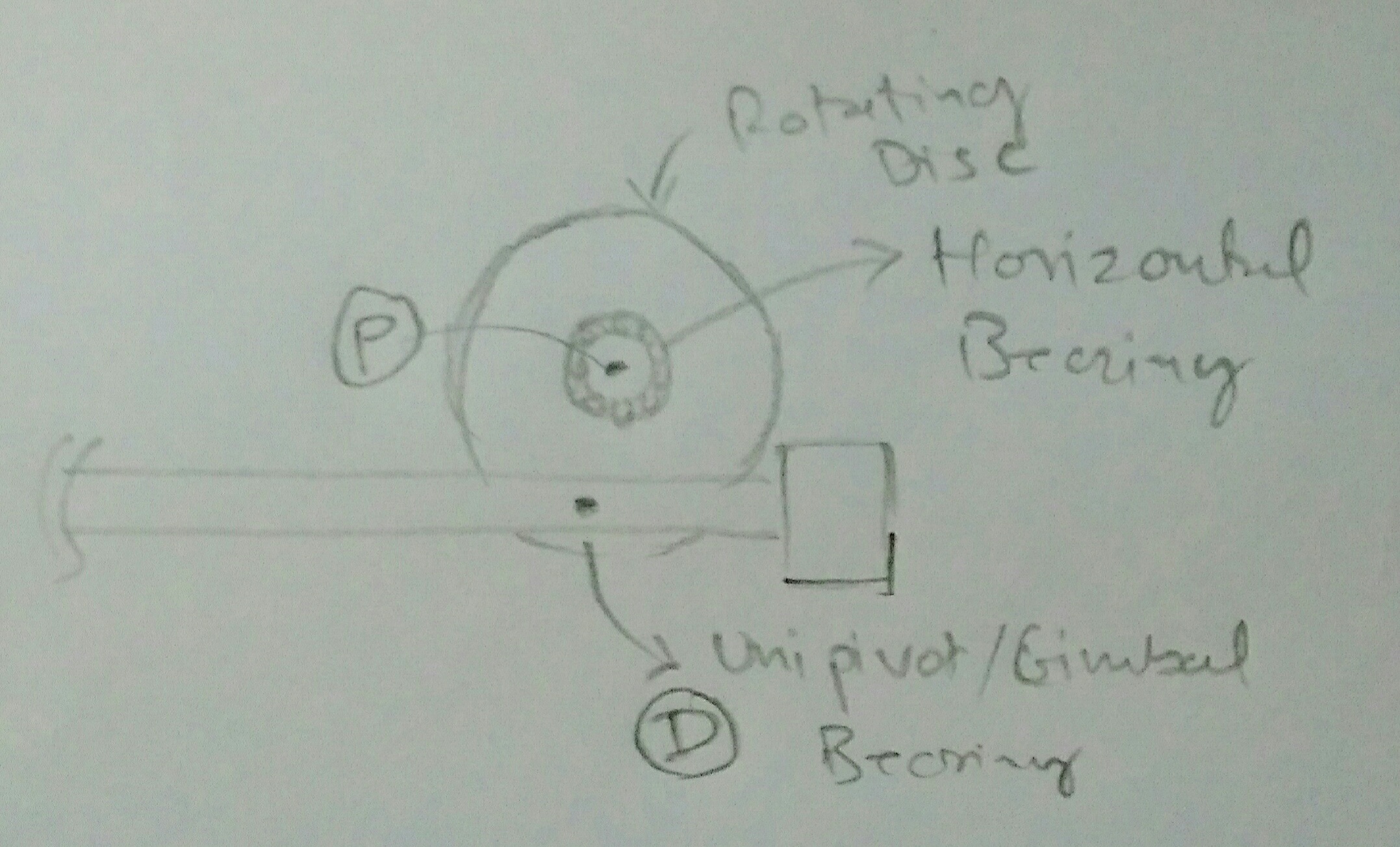

I think the easiest for a guide is to use a string in a Birch geometry to guide the stylus. But a string can only pull but not push and when encountering eccentric record, will the string go slack? And when it gets to end of record will the horizontal rocking be dangerous to the stylus? Will a magnetic damping a la Dynavector style help? Will this approach have skating force? What is the best way to avoid skating force?

Every tonearm on which the stylus travels on a curved path will skate. No exceptions.
I presume one end of string is attached to main tonearm wand. What is on the other end of the string?
One end of string is tied to the midpoint of the axle of the vertical arm and other end is tied to a fixed point outside of the arm. It's just a variation of the Birch geometry. The string is between P to D.

This arrangement is not self-aligning, stylus drag will pull the arm off-tangent (and then it will also skate). You need to provide an opposite force to stylus drag.This should work. only two points. P and D according to Birch geometry.
