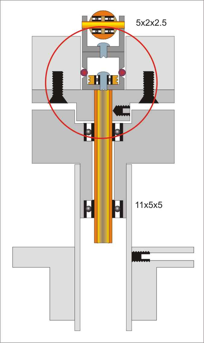

Here is where I came: self-centered, and always under load (a 30 ° slope should hopefully divide the load properly), and above all feasible with my small circular saw. Better with delrin balls (to compensate the tolerances) if i'll find (i have just 3 and 5)

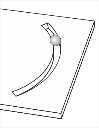

With the three balls in two/three channels all three balls are constantly loaded so there would be no chatter. It's when you use conventional ball race type bearings that have loose unloaded balls that you get chatter.
Niffy
Thats what I was thinking to implement. A simple precision laser/machine cut (Arc or circle segment) in 4/5 mm metal plate and a bearing ball on top of it and another mirror image plate on top of plate should work I guess. See attached pic.Can this rolling ball idea can be expanded to the guiding mechanism too in a curved channel?

Niffy, could be done in an arm like mine? really i can't figure out. i know the double rod instead of the V groove used in many products (in the smallest, or cheaper) but never seen the 3 balls solution. May you post a sketch, please?
thanks carlo
